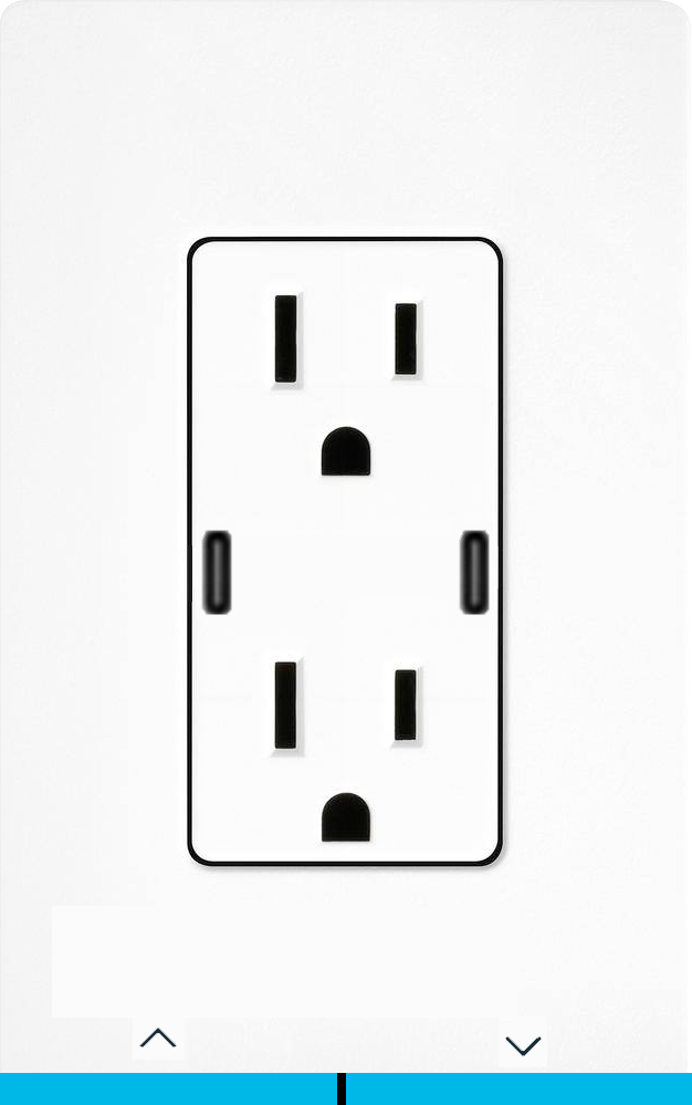

So what I’m thinking is combine these 2 ideas. The cover could be built-in. This would leave more room for the dual USB-C’s and the 2 LED’s could be split down the middle on the bottom with a nightlight notification effect in the firmware.
You could put an LED strip at the bottom then, that would be cool!

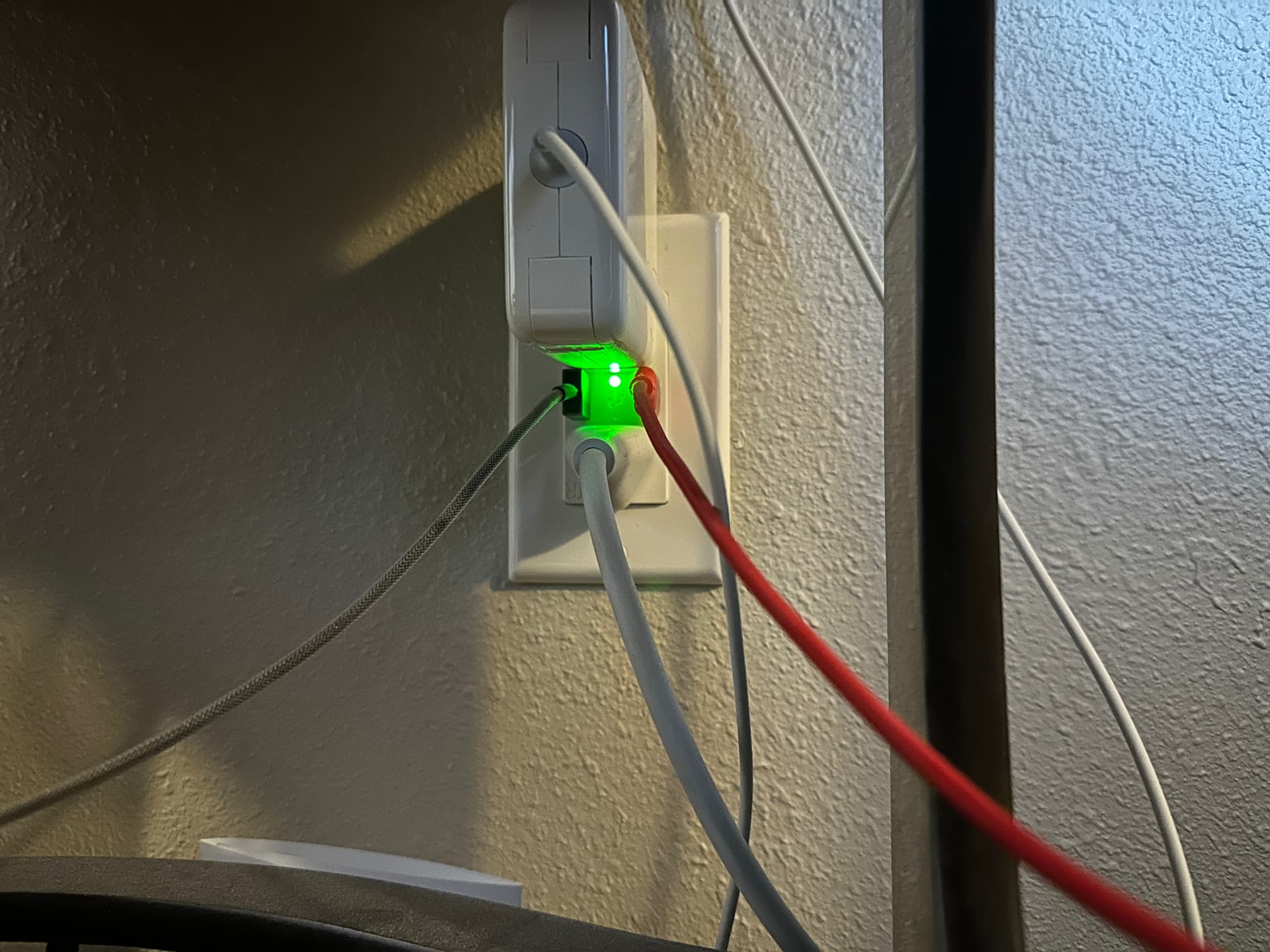

I worry a little bit about physical buttons on the switch for controlling the power state of the outlets. This seems like something that could be hit by accident by a power brick or something else large plugged into the outlet. I know I’ve done this with GFI outlets more than once…

After seeing the last few posts above, I have a concern that the proposed center-mounted USB-C port would be obstructed if two standard 3-prong (grounded) plugs were to be used in this layout…
