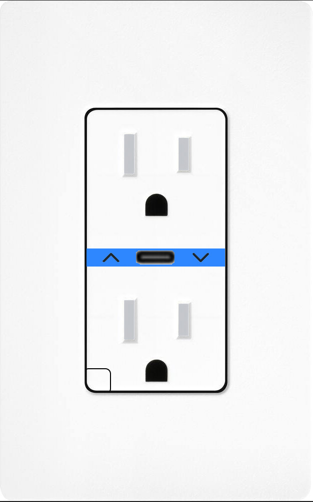

@sixo, @UngluedChalice – do you think something like this would work? I have no clue if they can do it with the PCB layout, but I can ask.
Essentially a button of some sort at the bottom left of the outlet. Either a push-in (and it would pop out) or a pull-out button to disconnect power.
That would work, but the current shape and size of your switch air gaps would work better IMHO (easier to get a fingernail under, though if it’s a push button what you showed is fine), and would match the “Inovelli look” better too.

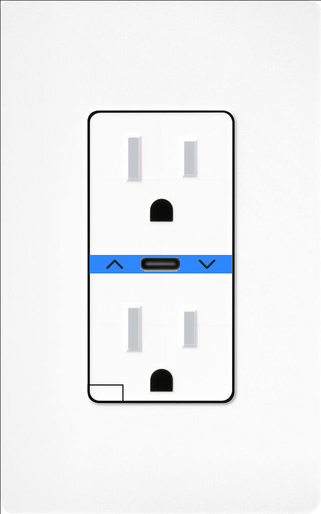

Yeah I thought about this, but I think I’d have to move the outlets closer to each other to achieve that, right (which may be of concern when plugging in two devices as mentioned earlier in the thread)?
Idk, what do you think?
Ah, I wasn’t thinking of carrying the bar all the way across the bottom, just making the little tabbar skinnier and longer so that it came almost to the ground hole on the bottom, same dimensions as the current tab on the switches otherwise. But maybe I’m not thinking of the right thing.
Like this?
You’d pull it out similar to the switch.
Yeah, that’s much closer to this design.
