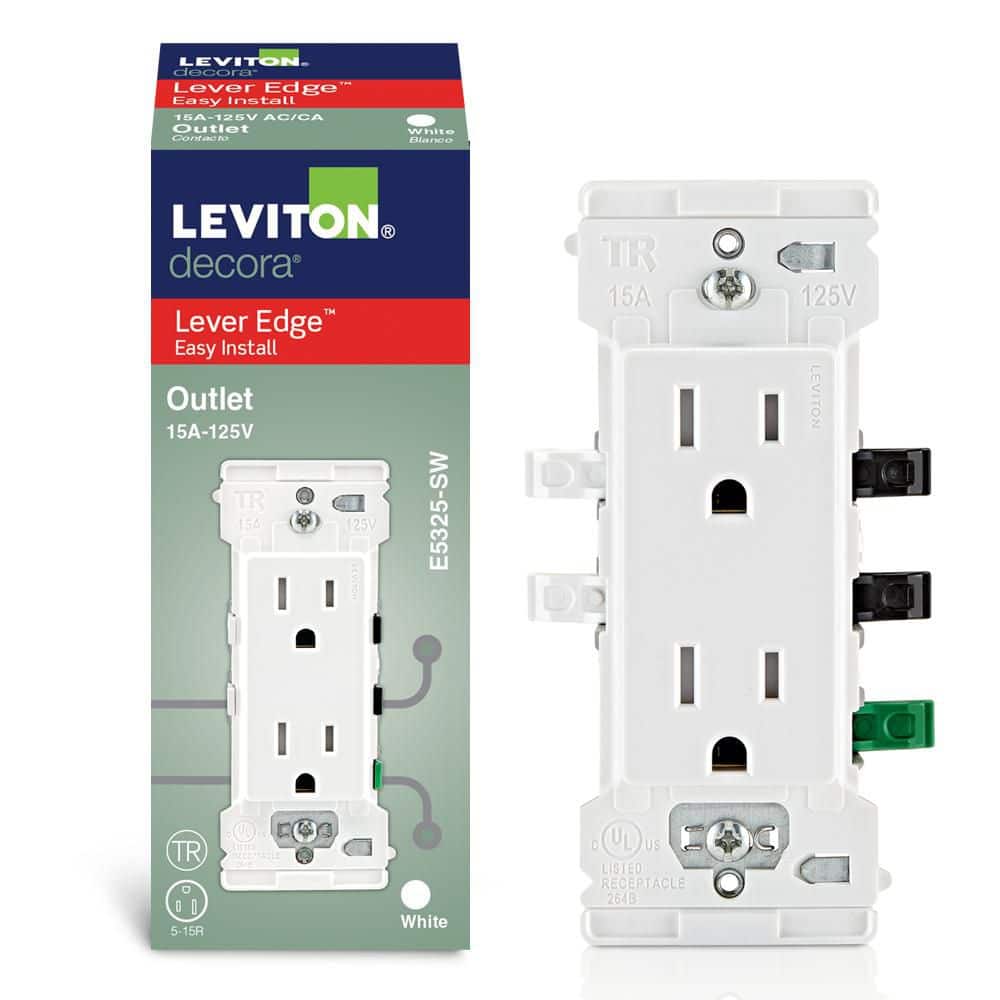

The new Leviton does use a wego like connector. That is what that is on the outlet link you sent. It is patent pending and only Leviton can implement a spring loaded termination on outlets/switches.
And not even any more expensive than other outlets, if you’re buying them in bulk. It would be awesome to see these features becoming standard in the future. Not planning on building a new house anytime soon but if we redo our kitchen in a few years I’d want to use this style(anywhere I didn’t install an Inovelli smart outlet :wink:).
Yea we’d need to see the patent and use case and have patent lawyer review. There may be a way to get it for the Inovelli design.
I’ve learned that, “Patent Pending” is often a marketing term used to scare off smaller companies who don’t want to hire a lawyer as anyone can submit a patent and say something is patent pending, but that patent can get denied. Although, yes, definitely want to have a lawyer look at it to see if there’s a way around it.
This is true. I know they had to work around the Wego patent to really come up with a design that worked as simple as a Wego, but didnt invade their patent. So even pending, it might be a loss. I’ll search for the patent paperwork to see and also pull up the Wego one. I beleive they worked around it by changing how the spring contact clamped on the wire. But the R&D needed to put into a new design and bypass both existing patents (unless Leviton is also able to get a design patent for all “Level locked wire terminals on an outlet/switch”), then that will kill any other design to add any kind of level lock/spring terminal into the outlet/switches, unless licensed it.

PLEASE do not include “Wago-like” connectors. Actual Wago 221s are great but there are a lot of sketchy knockoffs of them around. Use the real thing or nothing…
I would happily install an outlet with traditional screw terminals (preferably like in the Blue series light switches) or, less happily, with pigtails (for which I’d pick up some genuine Wagos, but others might prefer wire nuts). I would not use a newly-developed clamp-type connector.
I would say keeping the same back-wired screw terminals as the blue/red switches use should be reasonable. I would prefer that these don’t have the traditional screw terminals that you have to wrap the wire around (that all of the $2 receptacles have).
And no pigtails, please. Cramming more wires into tight boxes will cause some people to hit box-fill limits.
I think Eric is saying that they are considering including levers for connections on the receptacle itself, not built in pigtails and providing wage-like connectors.
That said, any new connection method should be safe since the receptacles will go through and get certified from ETL (like the blue/red switches have) before Inovelli sells them.
HARD pass on stab in connectors. Those are junk! The screw in terminals like the light switches for sure the best route!

Push-in / spring type connectors have to be designed perfectly for them to be reliable. Wago knows how to do it (they’ve been making 'em for more than half a century) but a lot of their competitors/knockoffs don’t. Search for “backstab outlets” and you’ll find plenty of horror stories.
No backstabs. The Wago type connector being asked for would be lever locks. Push-in connectors should not be considered here.
A downside to using lever-type is that it’s one wire per lever, so to allow for 2 wires to connect would need 2 levers. A single screw with a plate can clamp 2 wires.
Honestly, I’ve used both Wago and wire nuts a lot and I’m meh about using Wagos for joining solid conductors. I can make a joint with 2-3 solid 14 gauge conductors and a wire nut just as fast, if not faster, as using a Wago. I do Wagos for stranded wire, so for light fixtures mostly. People also claim Wagos save with box space, but I just don’t see that either. None of this applies to receptacles though.
