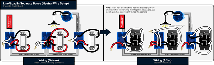

NOTE: I have installed 3 Red series dimmers in a 4 way configuration. The all light and turn on/off, but only the switch the has the LOAD connected turns the light on/off. How do I get the other two dimmers to control the one with the load??
You have to set up zwave associations between all of the switches. You’ll want groups 2,3,4.
