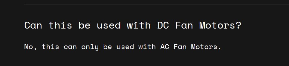

Is it ok to wire the ECM DC fan to the fan load terminal of the canopy module, as long as I always keep it set to 0% or 100%?
Thanks in advance
The canopy module is designed to work with AC fan motors, not DC fan motors.
I understand it can’t vary the speed of the fan. But what happens if the fan, which accepts AC input, is just powered at 100% or 0% from the module? What will go wrong?
We are not going to discuss what can happen when you intentionally use an Inovelli product with an inductive load for which it is not designed, rated for, or intended to be used with.
Suffice it to say that there have been a couple of occurrences of similar misuses, which resulted in catastrophic events and ultimately led to Inovelli adding overheat protection to certain devices.
