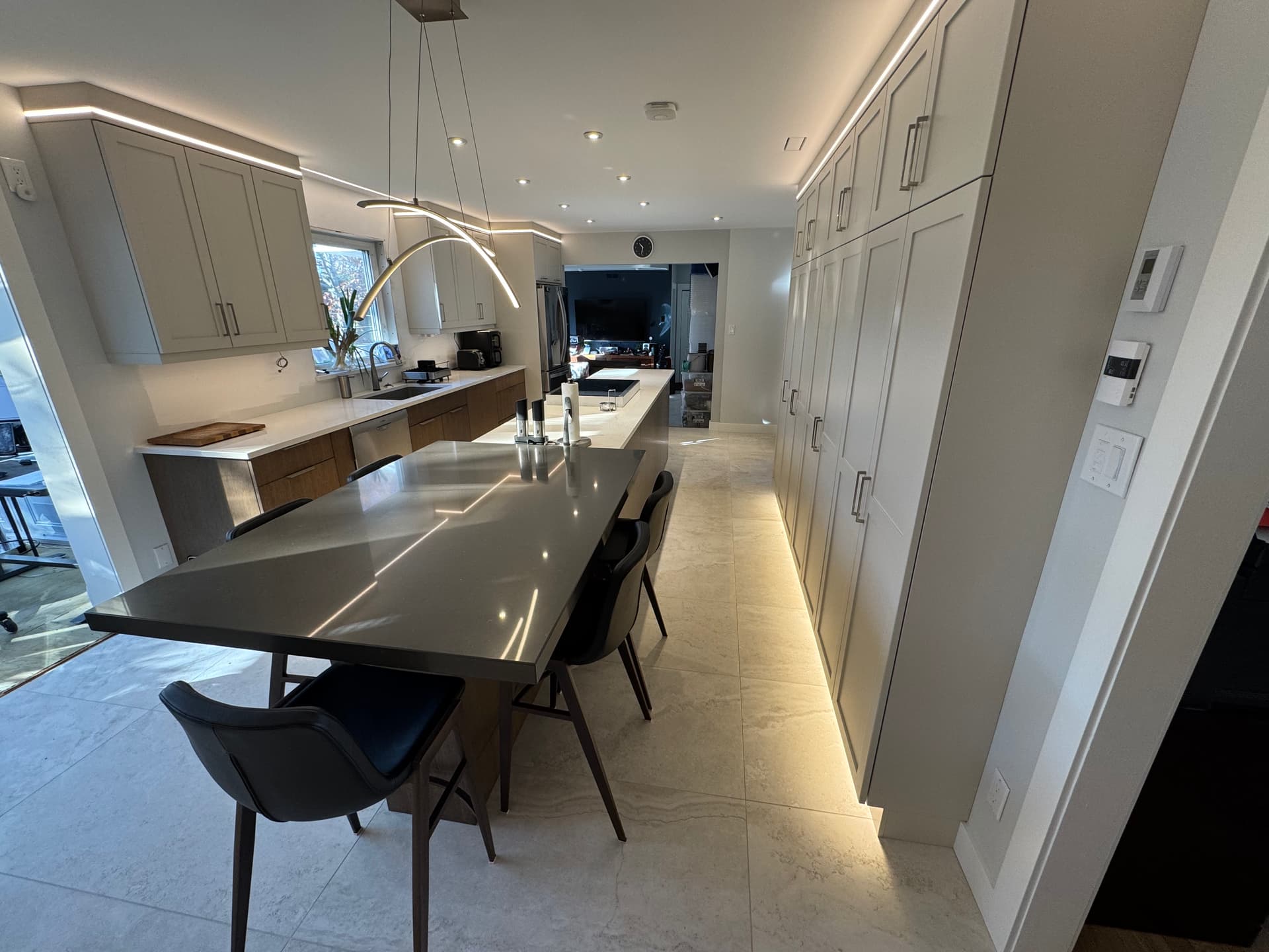

Reno is not yet complete, but here’s what it looks like when they’re all powered on (some are behind me):
(That Lutron switch on the right of the picture, next to the currently problematic Blue on/off is a placeholder to be replaced by one of my new mmWave switches once it arrives… :blush: )
Yeah, actually sounds like this firmware might help. Dang, that looks beautiful. I am super jealous!
