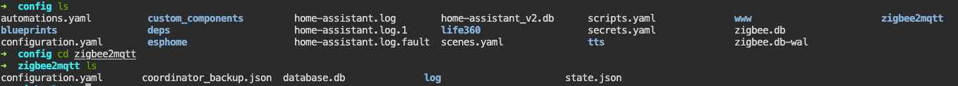

Sorry for my ignorance, I know where configuration.yaml is located (in zigbee2mqtt  folder)
but where I can find all other files?
You have to create de index_override.json file and download the ota from github. The links are higher up in the thread : Blue Series 2-1 Firmware Changelog | VZM31-SN - #746 by SamJWard
