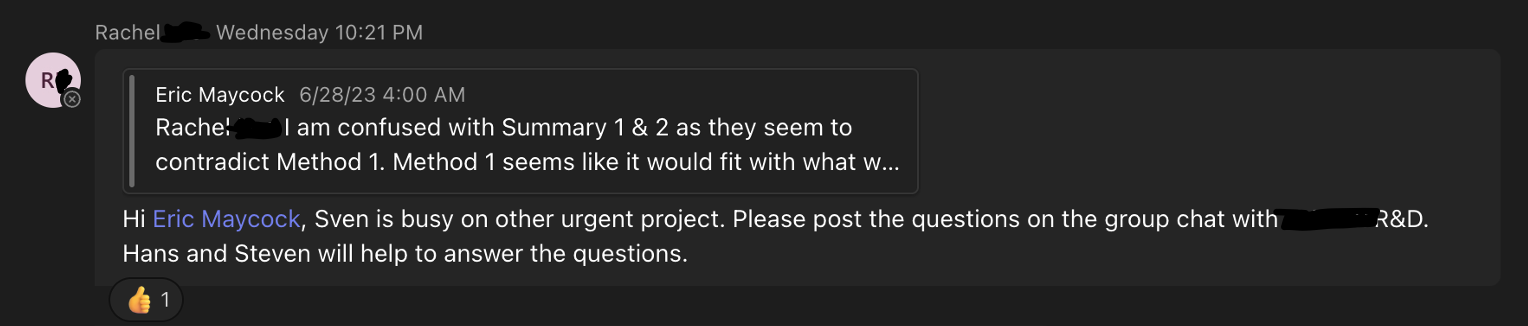

I’ll pop in, sorry, I thought the other Eric was handling this. Long story short, we’ve been testing 2.15 and there are some issues with flickering bulbs that we’re trying to chase down. It was fixed on the Red Series firmware, but for some reason it is not working on the Blue Series for some people. The firmware engineer has been unresponsive up until recently. Apparently he got pulled into an “urgent” project, but we’ve been told that they’re looking into it and trying to replicate the issue.
