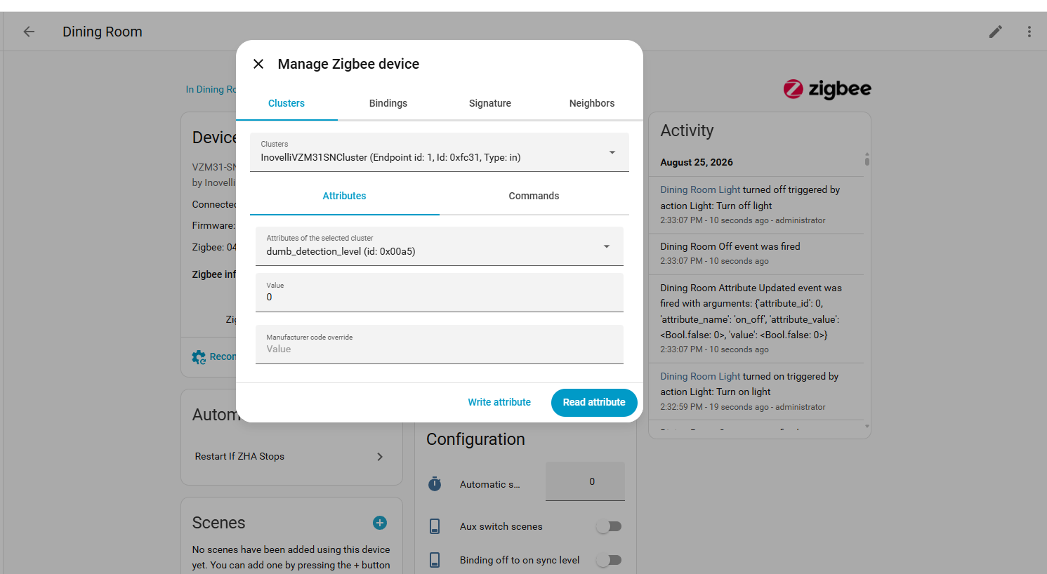

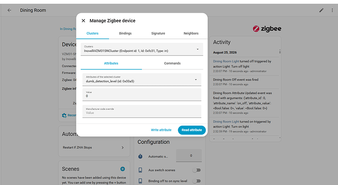

Some of the less used advanced settings are in the manage zigbee device window for the device:
I assume the default value of zero means not to treat it as a dumb switch. I changed the value to one and the end result was the same as before
I updated to 3.07 just now, and setting dumbDetectionLevel to 2 fixed the issue for me.
Firmware changelog for 3.07 says “start [dumbDetectionLevel] with a value of 0 and increase the level until the Dumb Switch function operates normally.”
My particular issue on my 4-way installation (line in first switch, load in 3rd switch) had the Blue switch always detecting “On” when it was sending power to the traveler wire, and detected fine when when sending power to the load wire.
Not sure how I missed the changelog. Thanks for pointing that out. Trying increasing values now.
Eric - after incrementing the value and testing, the light started working as expected at value “4”. Thanks for you help with the fix!
