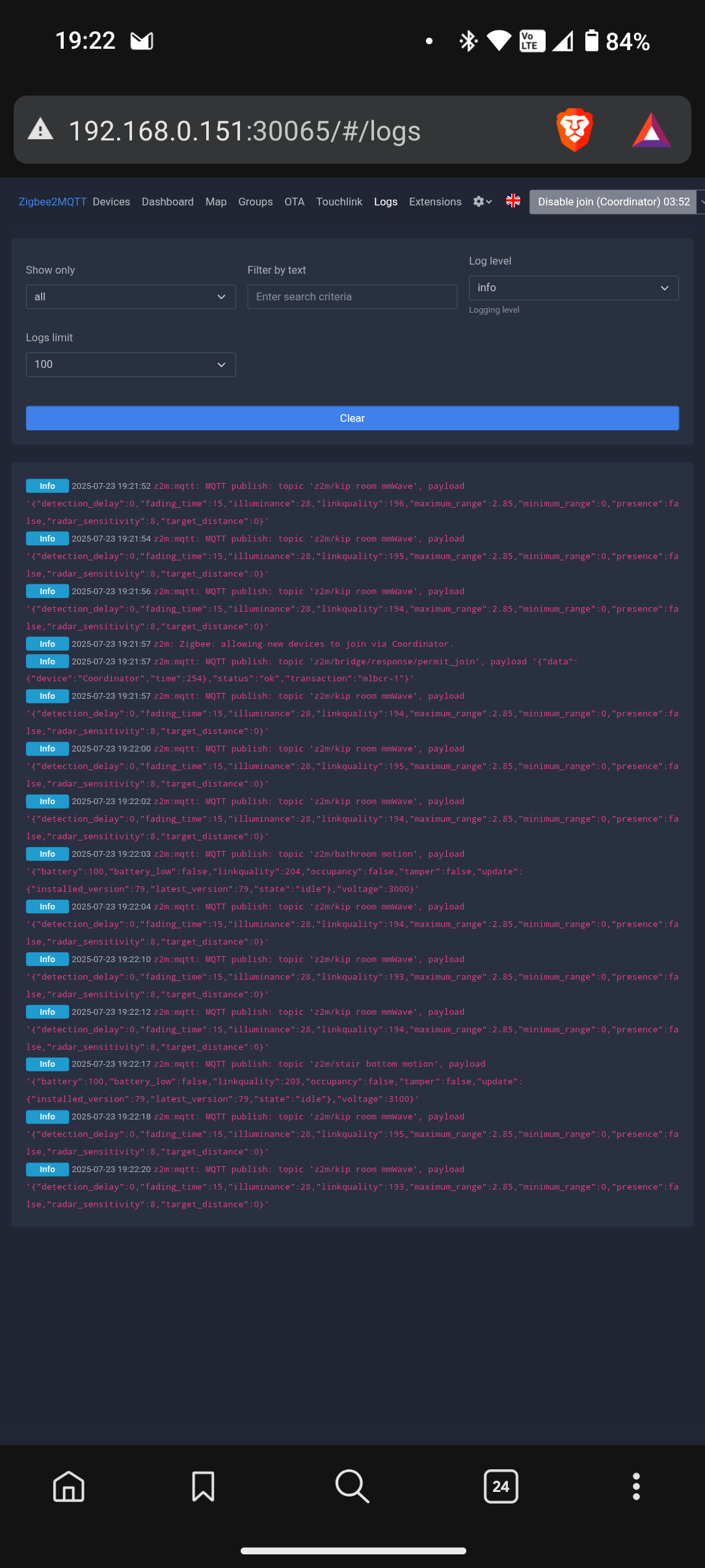

I started the permit join Coordinator a little after the start of the logging here, and I took the screenshot about 5-10 sec after the switch flashed green.

Your logs don’t show any attempt of any device to join your ZIgbee2MQTT network. This is not a converter issue (support for the 2-1 switches has been in Zigbee2MQTT for 2+ years now).
