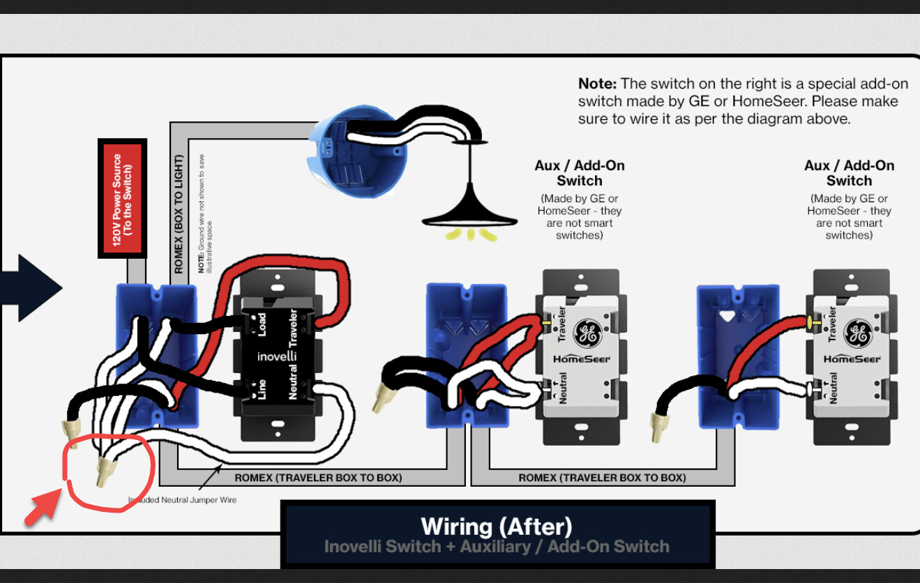

It’s a 4 way lighting setup as well. I’m using Inovelli auxiliary switches in the traveler locations and the actual smart switch in the load/line box in my kitchen.
I’ve racked my brain trying to figure out where the weirdness is originating and I keep coming back to the idea that it must be a neutral issue where I’m somehow getting feedback on a neutral wire that is triggering it. My house has 6 electrical panels so it makes me think somehow that a neutral in one switch location of the 4-way is tied to one panel and a neutral in another switch location of the 4-way is tied to another panel and maybe that is part of it?
That’s not possible if you’ve wired correctly. If you follow the Inovelli diagram for a neutral configuration, you are sending the neutral from the Line box to the Aux boxes over one of the 3-wire conductors. So the neutral that is landed on each Aux switch is, if wired properly, the neutral from the Line box.
