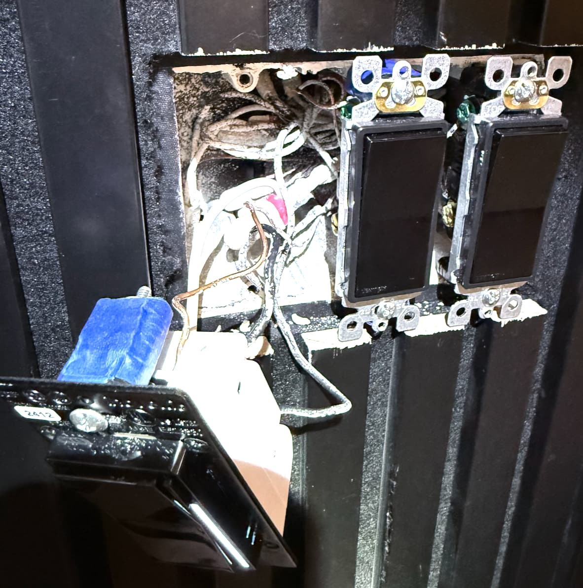

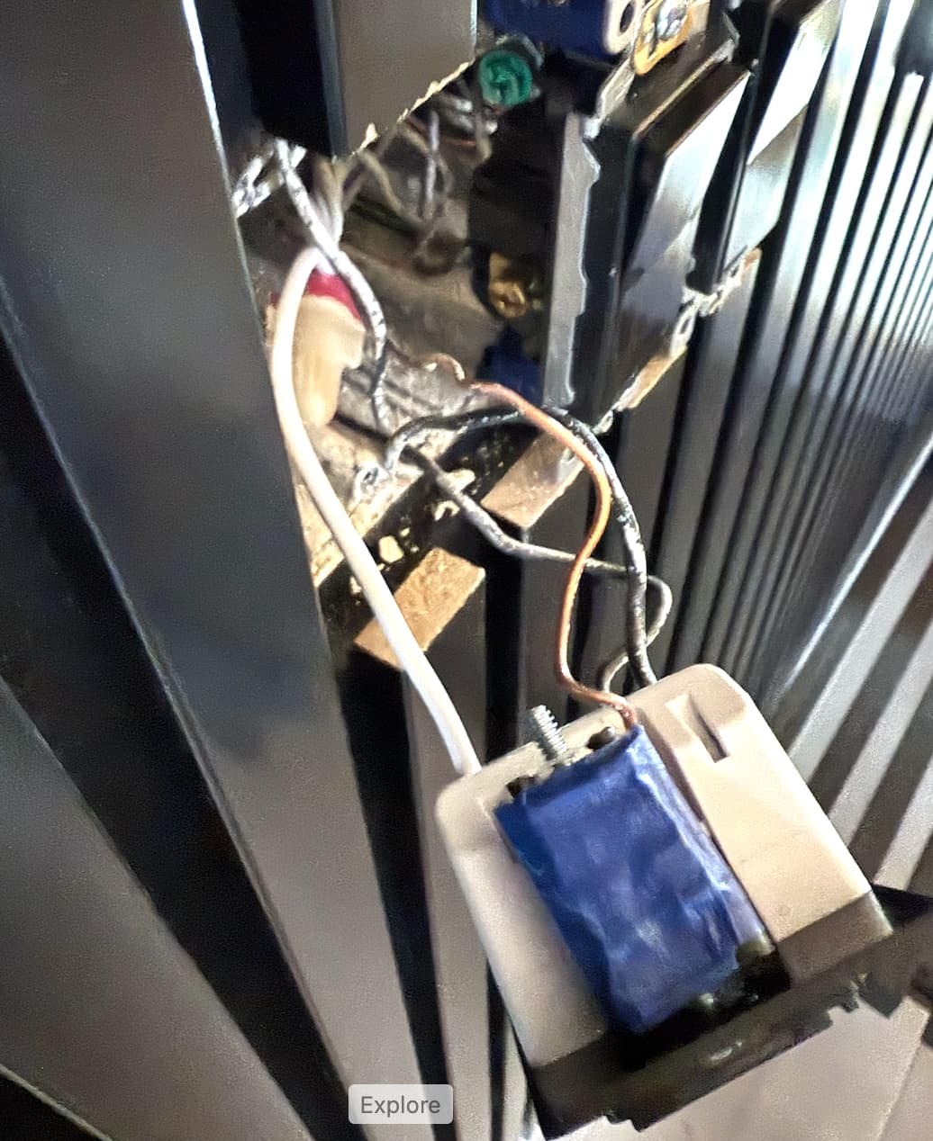

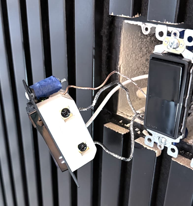

Installed as a single pole switch. I can add to apple home. The LED switch light panel works. Issue is the lights always stay on. Regardless of of what I do with they pysical switch or the Home app. I can control the LED bar but not the main lights.
With the air gap safety open:
Ground to Neutral - 0.2V
Line to Ground - 120V
Line to Neutral - 120.5V
Ground to Load - 0.3V
Load to Line - 119.4V Load to Neutral - 0.13V
Any advice or thoughts? Thanks!
