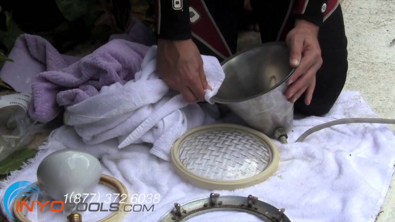

  1. I have a high-amp incandescent pool light with no neutral. I need close to 1000W of power handling, so the Inovelli dimmer is out of the running; and with no neutral, I can’t use an on/off switch. If Inovelli offered a high-cap dimmer, I’d get one.

Could you replace the bulb with an LED? A quick glance at Amazon shows several high lumen pool lights that use less than 100W.

Yes, that’s the long-term solution. I have no plans to drain the pool anytime in the next year or two, so until that time I’ll be keeping the incandescent. When I install an LED I’ll want to add a bypass just in case, because it’s not a fixture I can just pull out and work on whenever I want to.
I completely agree. Drawing over 5 amps for a pool light is ludicrous, but it’s what was here when I bought the place.
You typically don’t have to drain the pool to change the light. Its in a sealed enclosure that removes from the niche as a sealed unit. There is supposed to be (but not always) enough cord coiled up in the niche to lift the light unit up on to the pool deck for service.
Thanks. I’ll check into it. I know the builder, so they should be able to confirm.
It usually does, it would be “illegal” as in against the law. NEC regulations are codified into many state and local laws. Obviously check your local laws, but it is definitely something to pay attention to.
Most pool lights are installed in such way to be serviceable without draining the pool. That would be silly, especially in the age of incandescents.
Another thing I have to consider with the pool light is compatibility with an LED down the road, should I go that route. It’s a 120V bulb with no transformer between the switch and the fixture and needs to be dimmer-compatible, if not dimmable.
