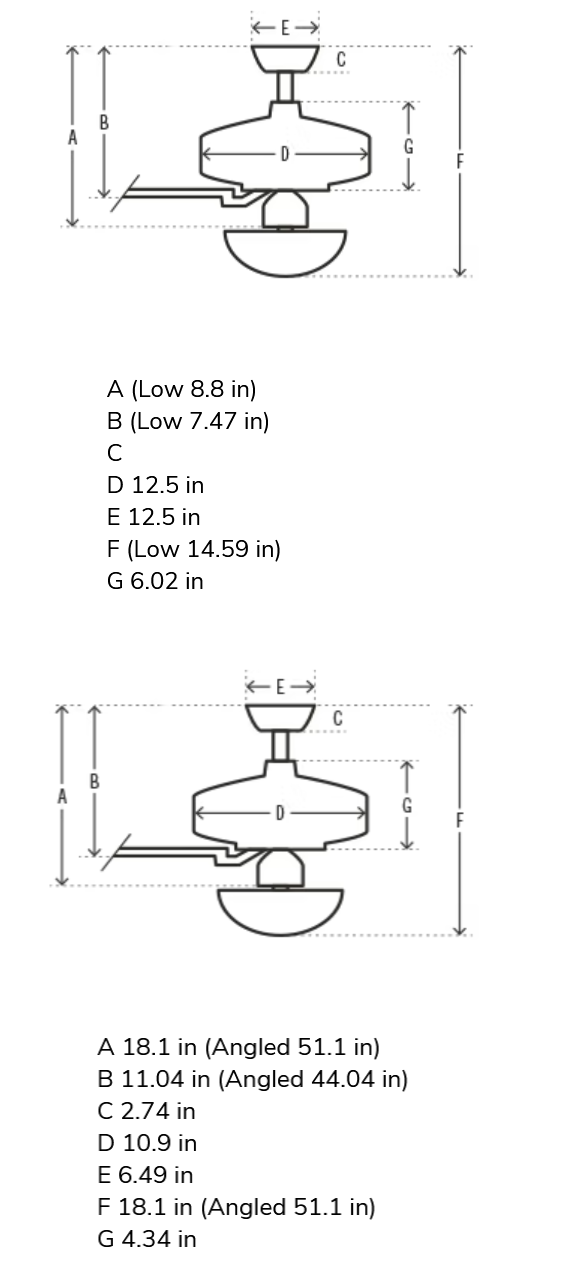

I’d stick with brand names where you can pull the specs up on-line, such as Hunter Fan. One the Hunter website, the list all the fan’s dimensions, to include the canopy module. Like these:
The ceiling huggers (not the low profile) fans actually have way more room in the canopy.
The top picture above is a ceiling hugger, the bottom is a standard canopy.
