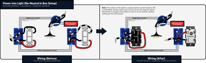

It’s always best to refer to the Inovelli wiring diagrams at https://help.inovelli.com
Sorry I mixed up the 2 wire and 3 wire when writing it. I followed that diagram. I have the white from the 2 wire on the line with the black from the 3 wire. The black from the 2 wire is on the load. The white on the 3 wire is capped in both boxes.

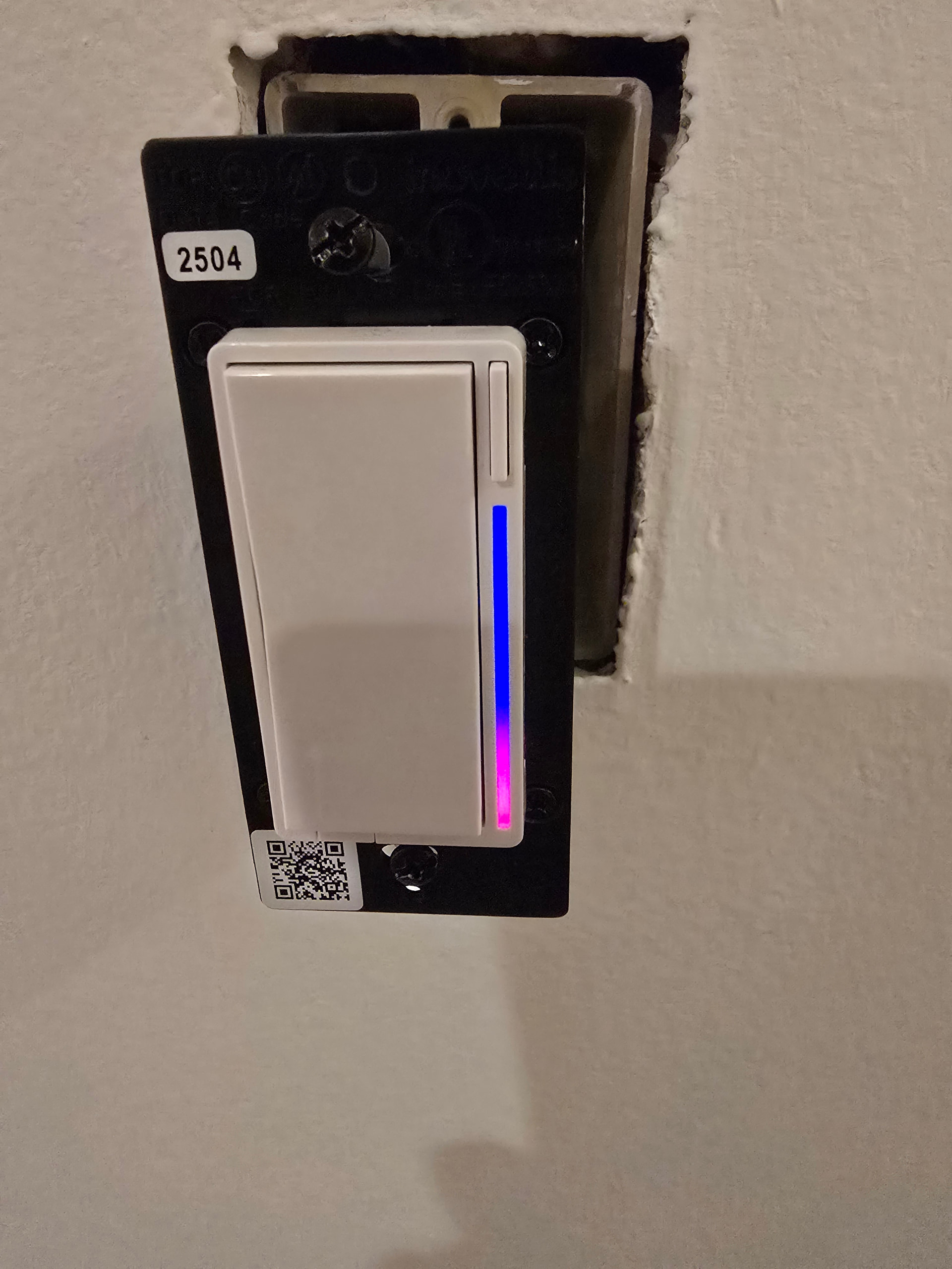

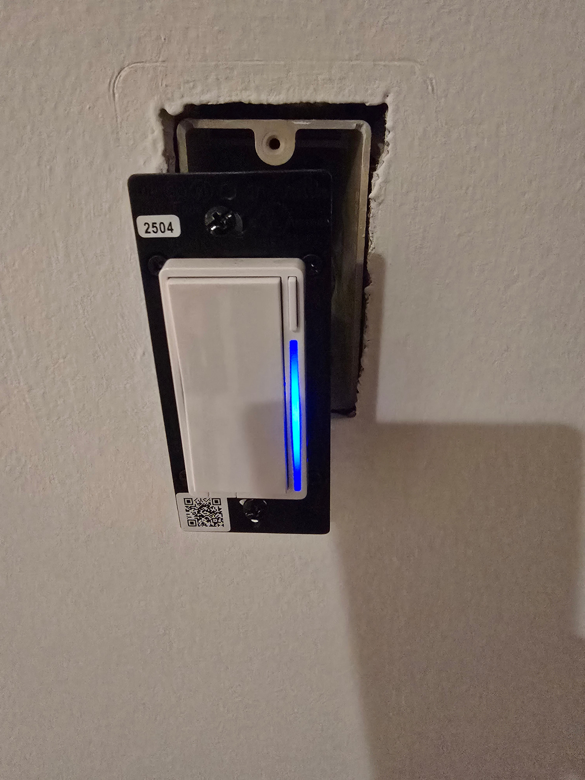

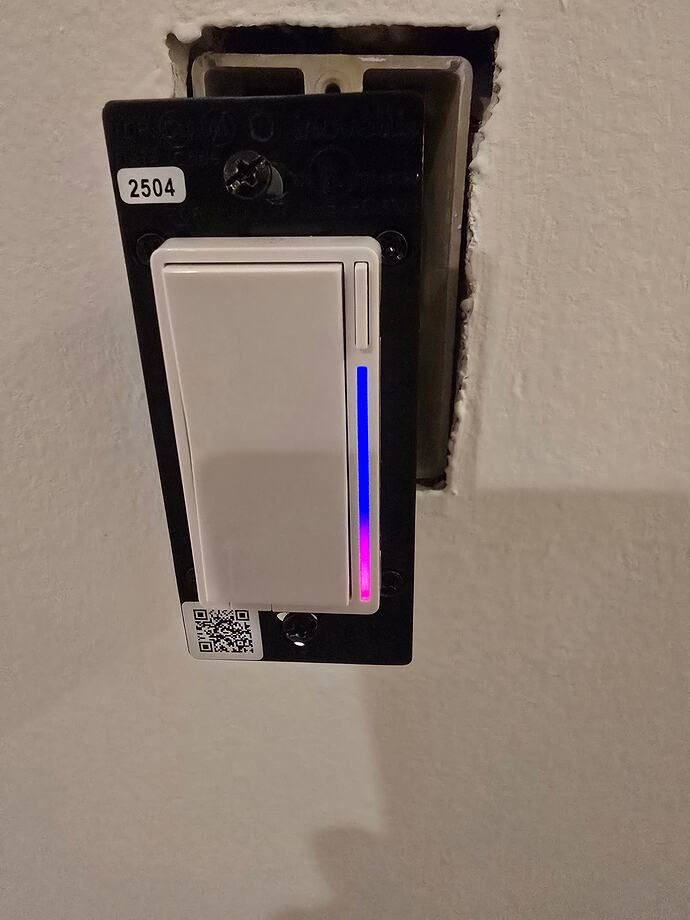

I swapped the CFL bulb with a Philips dimmable LED 5W (60W equivalent) bulb and the flickering stopped and the switches work. When the light is on the LED bar on the inovelli top half blue and bottom half red and I never made any changes to the LED bar parameters. Color when on is set to blue & all of the DefaultLed#ColorWhenOn & DefaultLed#ColorWhenOff are the same.
When on:
When off:
It’s either defective or has a wonky setting stuck. Factory reset it to see if that resolves it.
That fixed the red LED, thank you! I appreciate you helping me out.
