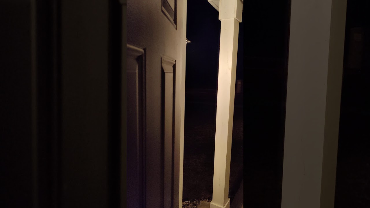

I just created this last night (3 smart bulbs associated with a dimmer):
