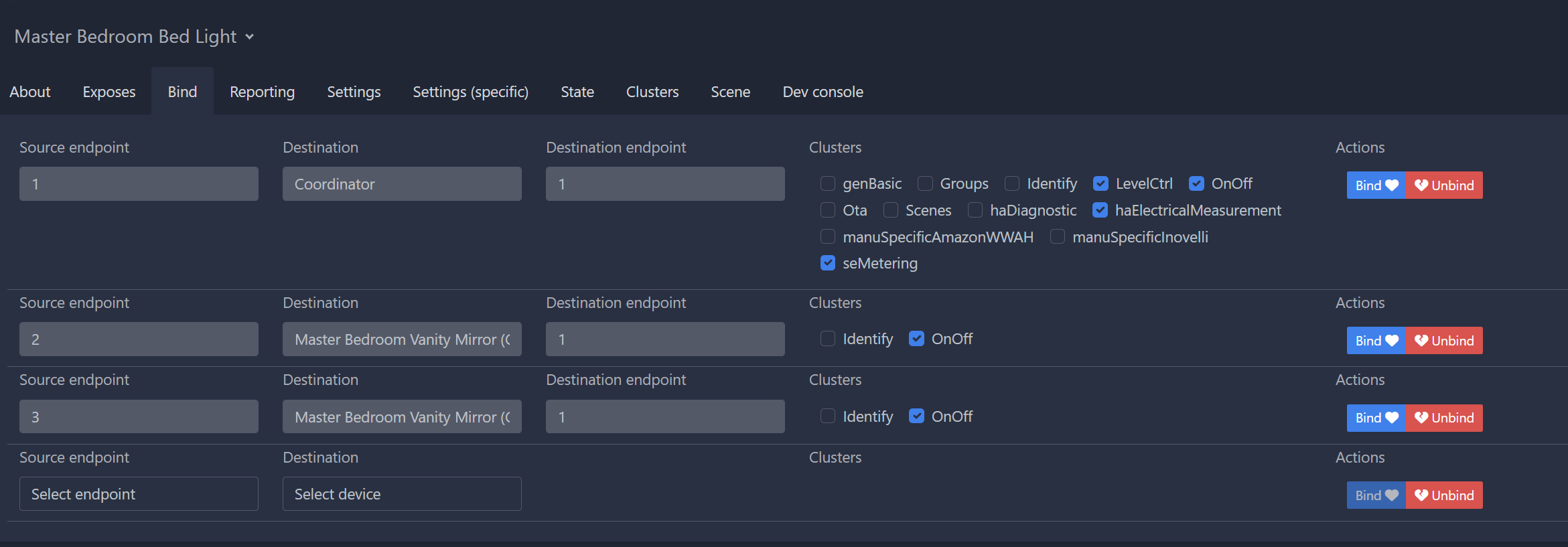

I was able to turn on/off the zigbee device using the large paddle on the Inovelli by binding it, but this also turns on/off the main light. I saw a video saying to select endpoint 3, but there is no 3 as an option.

What firmware version are you running? Endpoint 3 was only released in 2.18. If you’ve updated to 2.18 and are still not seeing endpoint 3, you’ll need to reinterview the switch.
If you do it via the binding, than it will work if Home Assistant or Zigbee2MQTT is offline.

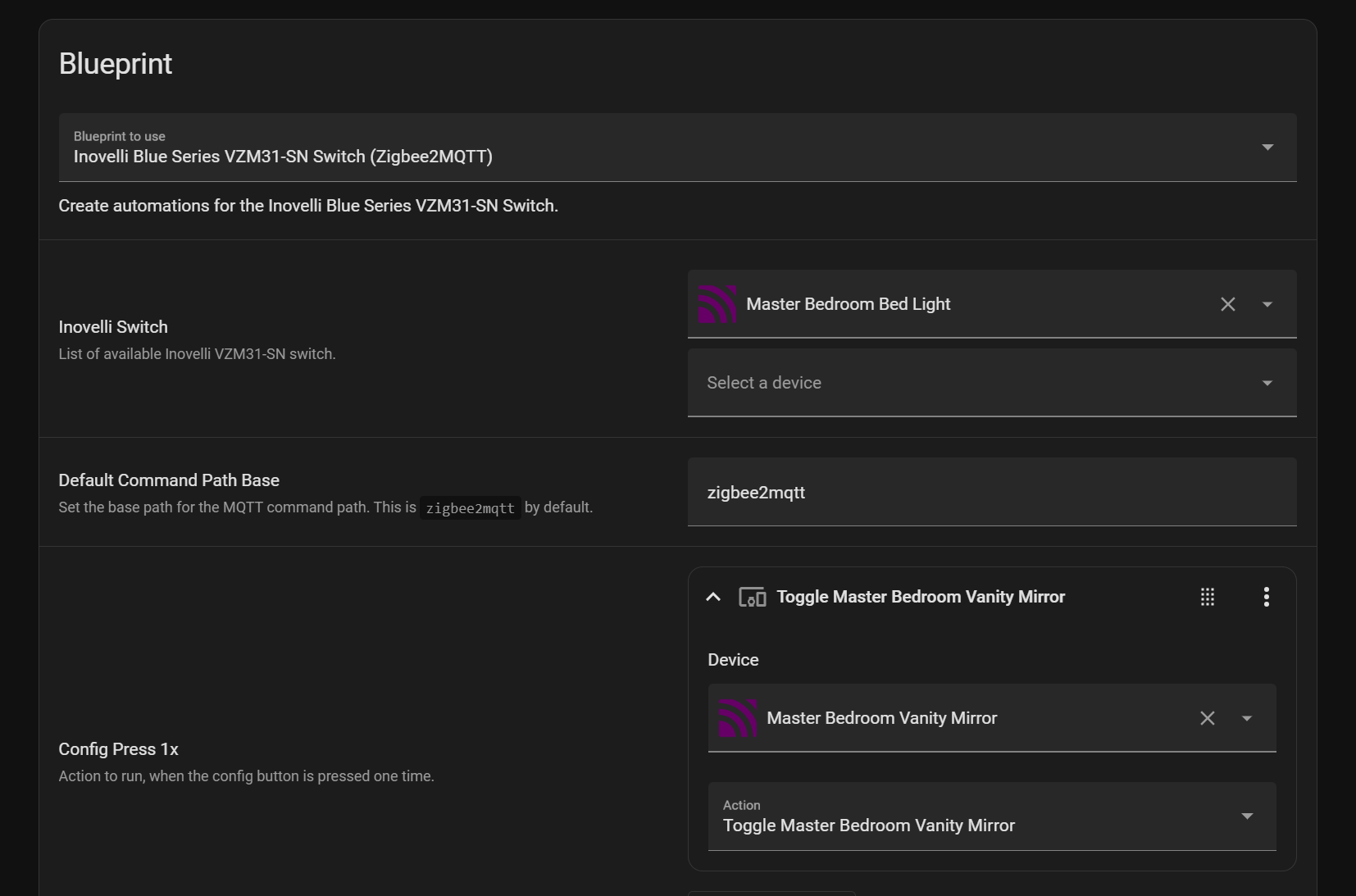

You can do it in Home Assistant by using my blueprint to capture the action of the config button in an automation: [zigbee2mqtt] Blue Series 2-1 missing action sensor in Home-Assistant - #15 by rohan

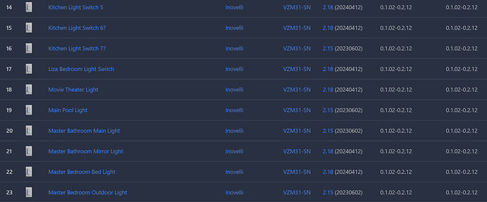

You were right. I went into ZigbeeMQTT’s OTA tab and saw my 30 Inovelli light switches were a mix of 2.15 and 2.18. But clicking update did nothing. I then saw a FAQ suggest that I go into Dev Console and query the light switch and i saw that it had been upgraded to 2.18, it just wasn’t showing it in OTA nor was it showing Endpoint 3. So i did a reinterview and Endpoint 3 now showed!

When I tried to Bind 3 to the Zigbee power adapter, nothing happened. (Note, I still have that Zigbee adapter on 2 as well, but I already tried with that unbinded).
So I then tried to do it the HA method and imported your blueprint. But, unfortunately, I am unaware of what is the next step to make it work. How do I call it to action in an automation?

EDIT: WAIT.. I didn’t see that there was a new option under HA automations from your blueprint! This is what happens when I try to make things work after midnight only using my phone screen!
I’m not home now but I just created this. Will try it the minute I get home!
I think this is a limitation of the current setup with endpoint 3. Since it was designed to control fans, it rotates through the percentages of 33/66/100 which your smart plug of course will do nothing with (since it’s not dimmable). I believe there’s an open feature request to make this support toggling toggle-able devices (like plugs). I missed the fact that you were using a smart plug and not a smart bulb. For now you’ll have to use the blueprint.
Yep, you figured it out! Blueprints basically make it simple for us to package up complex automations and make them easy to share with just a small amount of input from the user.
Your automation looks correct to me!

I checked the firmware and while Zigbee2QMTT is showing 2.15 for the other light switch, when I got to Dev Console, genBasic/swBuildId, it shows 2.18.

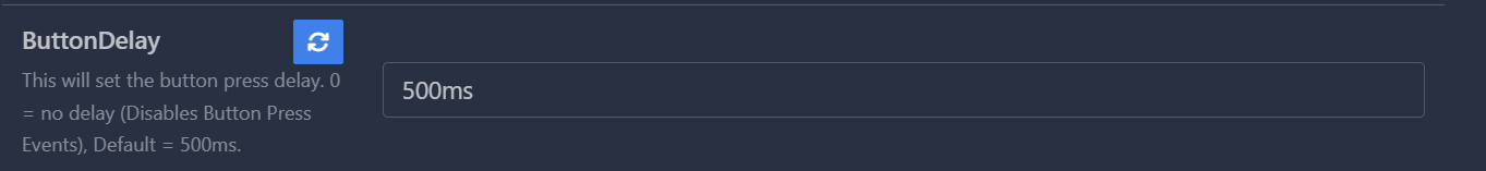

What do you have the button delay set to?
500ms
Try changing the button delay to 0ms and then back to 500ms and see if that makes a difference?
Do you see anything showing up on the Action attribute when you hit the config button or multi tap any of the other buttons?
