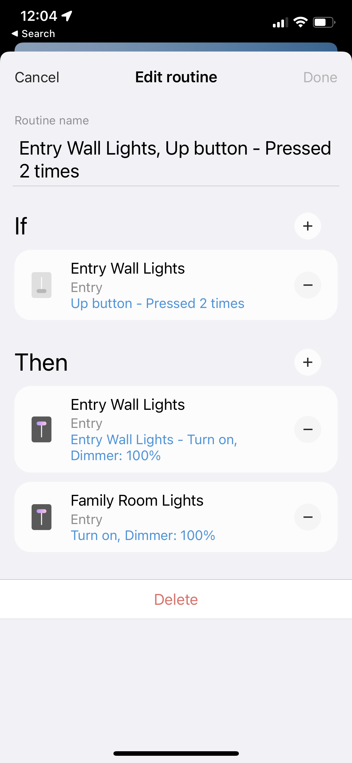

When I setup my first SmartThings automation for a double up tap (simply to turn the lights to 100% as well as turn on another set of lights) it doesn’t ever trigger. I’ve removed the automation and added it again, I’ve also tried setting it to start from a double down tap the configuration button and even just a single up press, but none of them seem to start an automation.

When you are presented with the IF option you are being presented with Button options, which is, um, new. When I select IF options, I don’t get a button option:
So the question is why do you have the button selection options; you’re not the first. Eric, EricM and I have discussed this, and the suspicion it that you may have loaded the beta Edge drivers or participated in the ST beta program. The other question is why is one of these working and the other not. Is the other routine you mentioned identical?
If you can post a screenshot of the IF options, that might help. Someone else here had the same issue and IIRC, @EricM_Inovelli was able to suggest something that worked. I haven’t loaded Edge, so I don’t have those button options, which makes it tough for me to suggest something here.

There are no routines that work with this switch. It’s a different switch that I was able to get a routine to kick off with. Also, I’m using the new SmartThings app where I login with a samsung account. I mention it as my screenshots and layout seems to be different than the one you sent a screenshot of.
