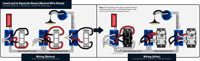

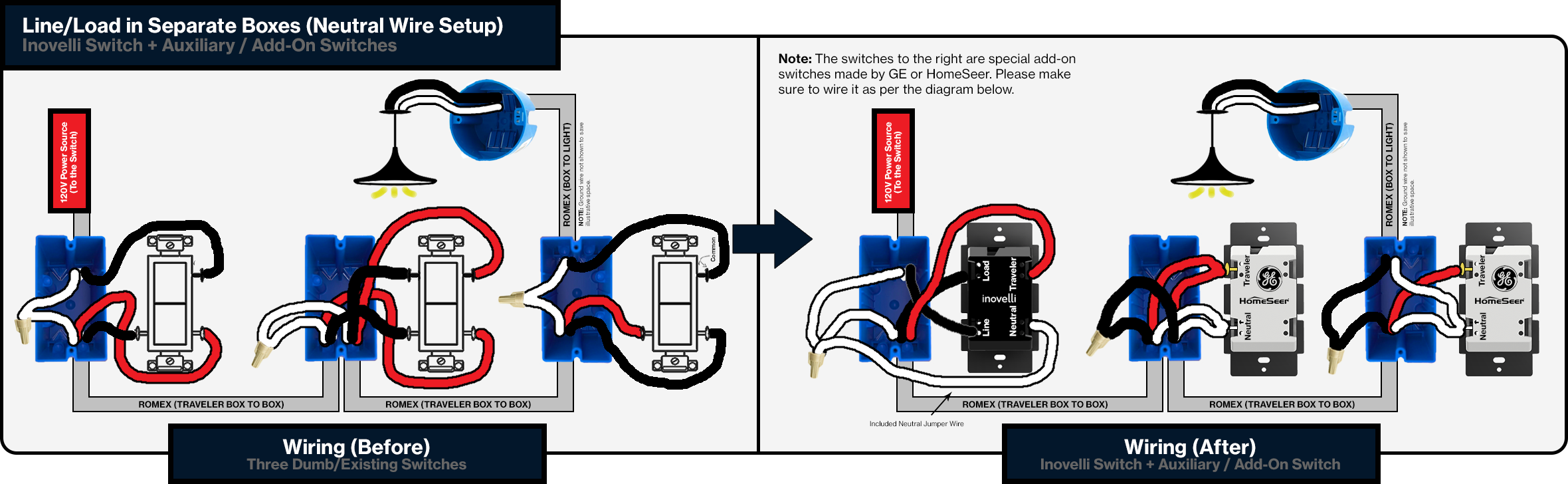

However, some of the schematics show the aux switch as Made by GE or HomeSeer (no mention of Inovelli). Does this mean that the Inoveli Aux switch won’t work in these configurations?

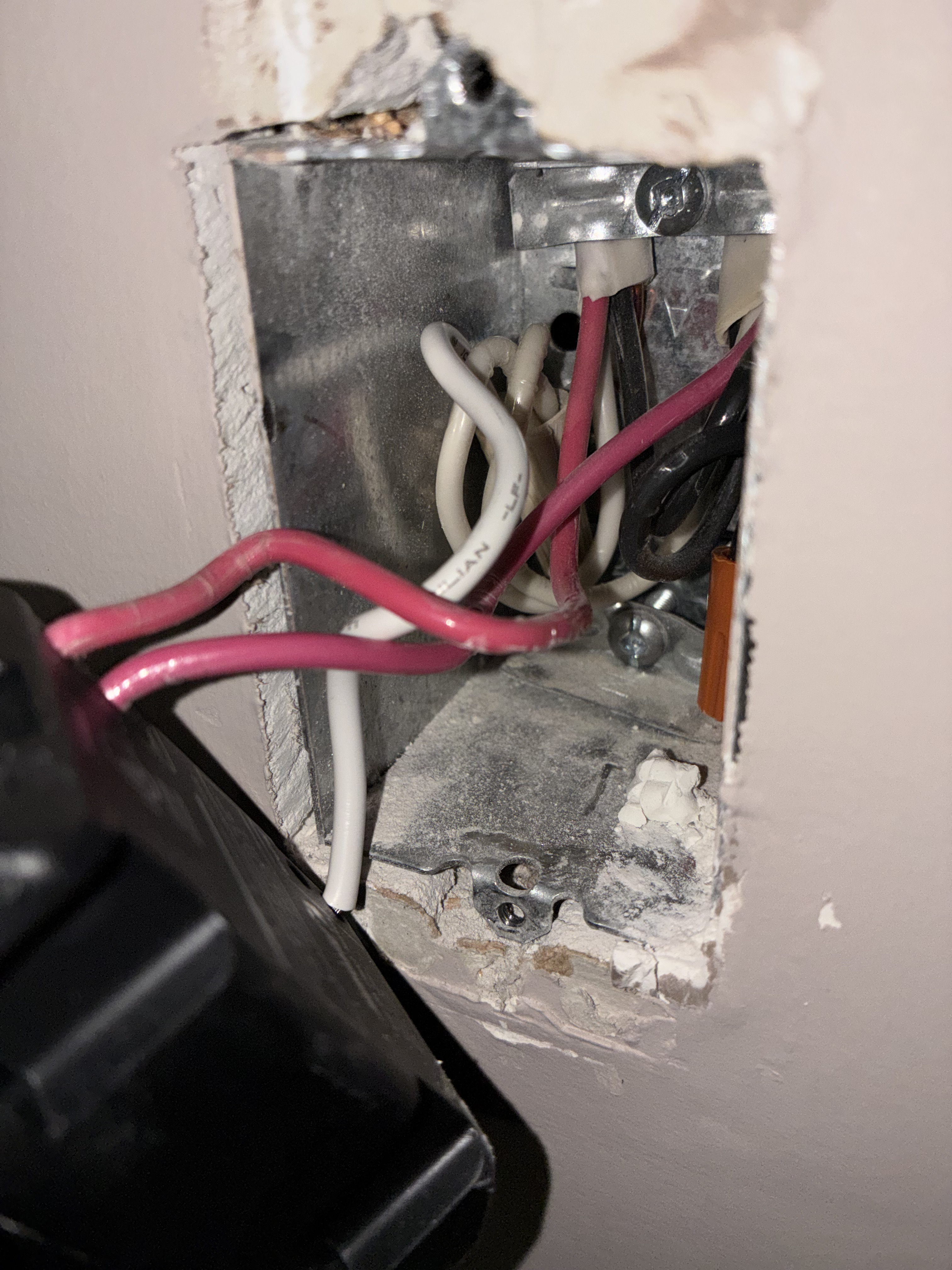

I’m seeing the following quirks after having the Inovelli dimmers and Inovelli aux switches installed by an electrician in the follow configurations:
Inovelli Aux DOWN doesn’t turn-off light, but Aux SCENE does. After some time, the light begins flickering and then the DOWN button on the Aux starts working.
No. They will all work. I think some of the older diagrams from before Inovelli had their own Aux were brought forward without adding a note about the Inovelli Aux.

This sounds like the switch is rebooting. Double-check the switch type for 3-way with Aux, but the could be a wiring fault, either miswiring or a loose conductor.
Thanks, the switch is already set to Multi-Way Aux, so I’ll check the wiring. I’m wondering if it could be something like this.

Did you test to determine which conductor was the line? What color conductor is attached to the Line terminal?

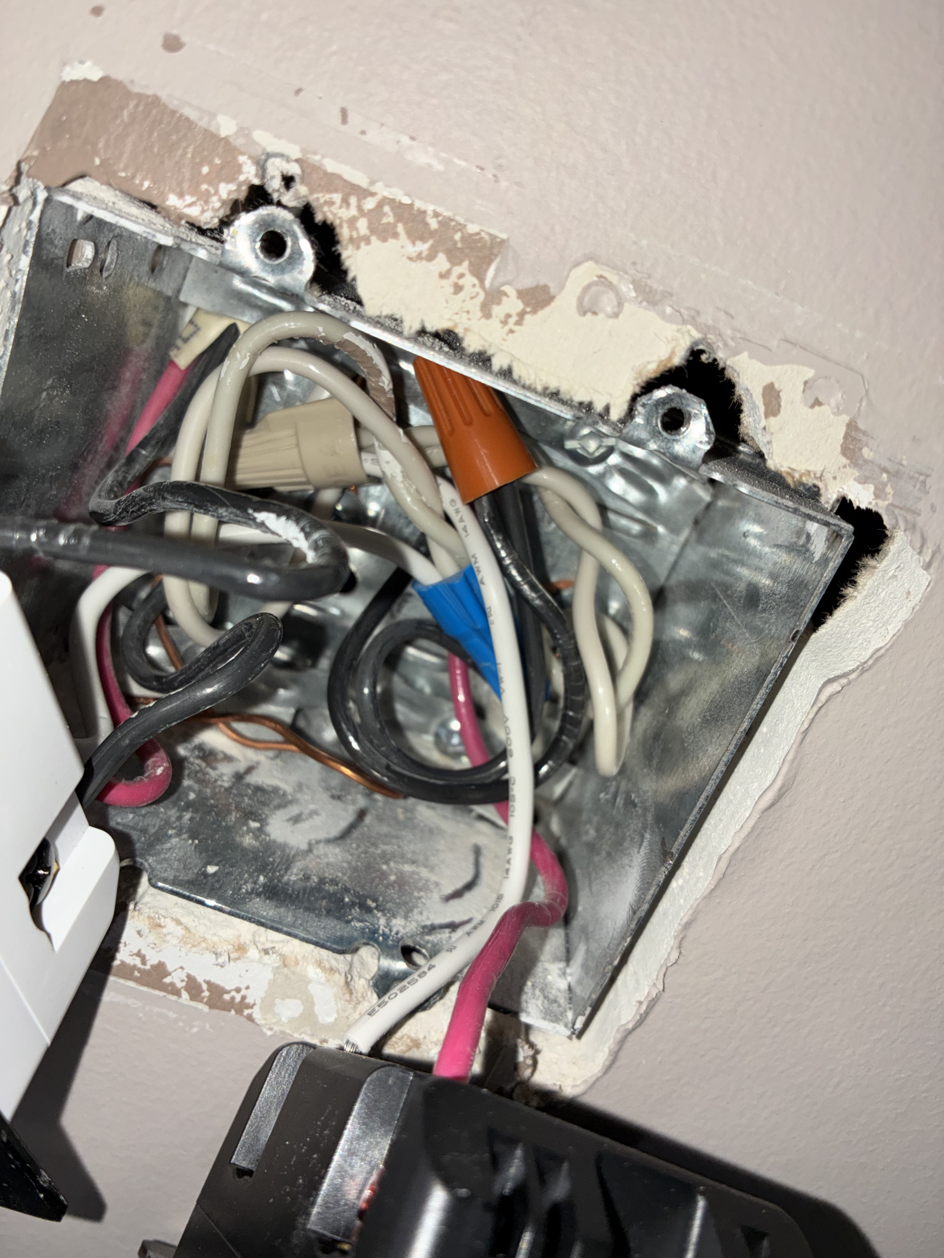

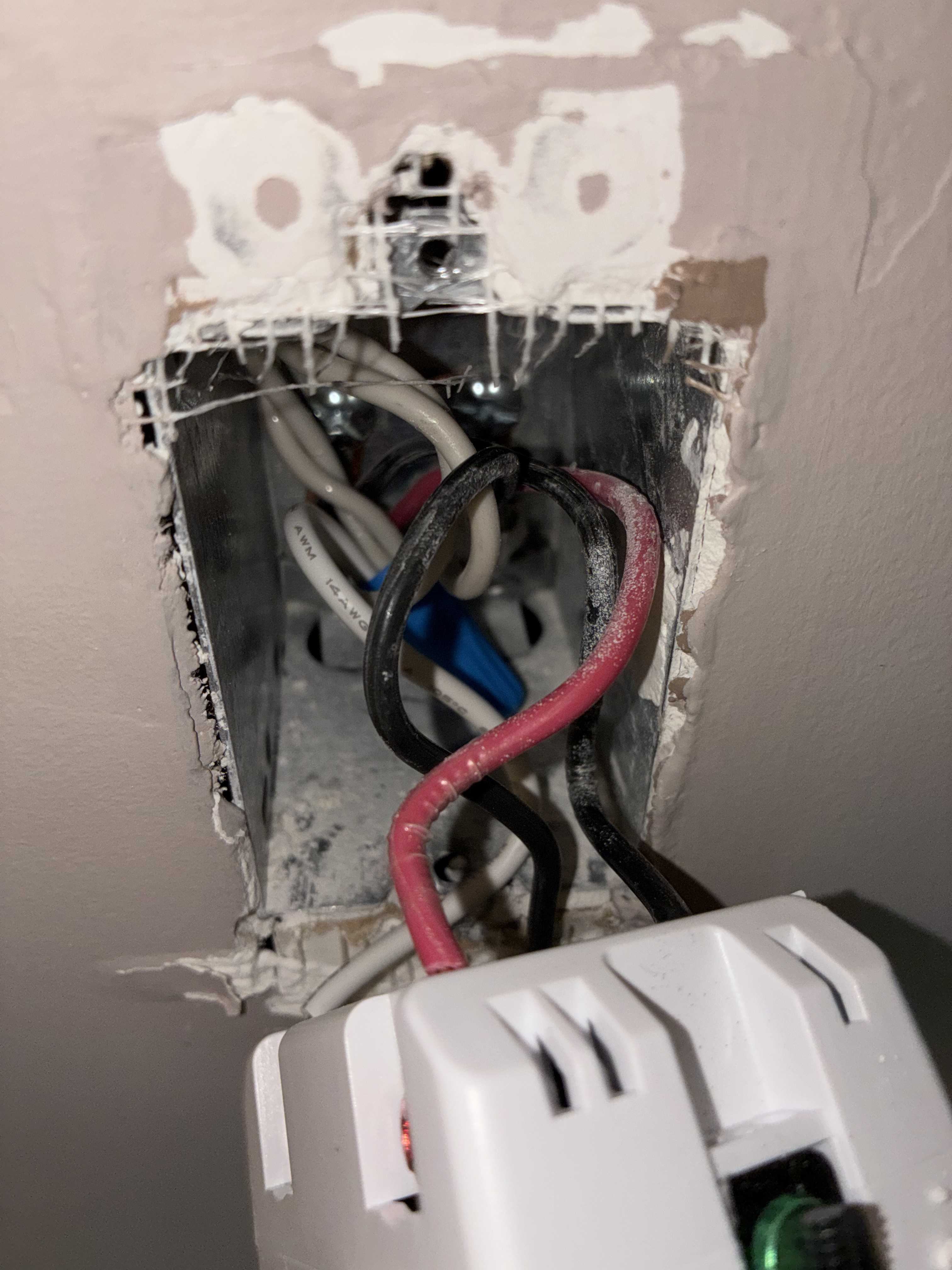

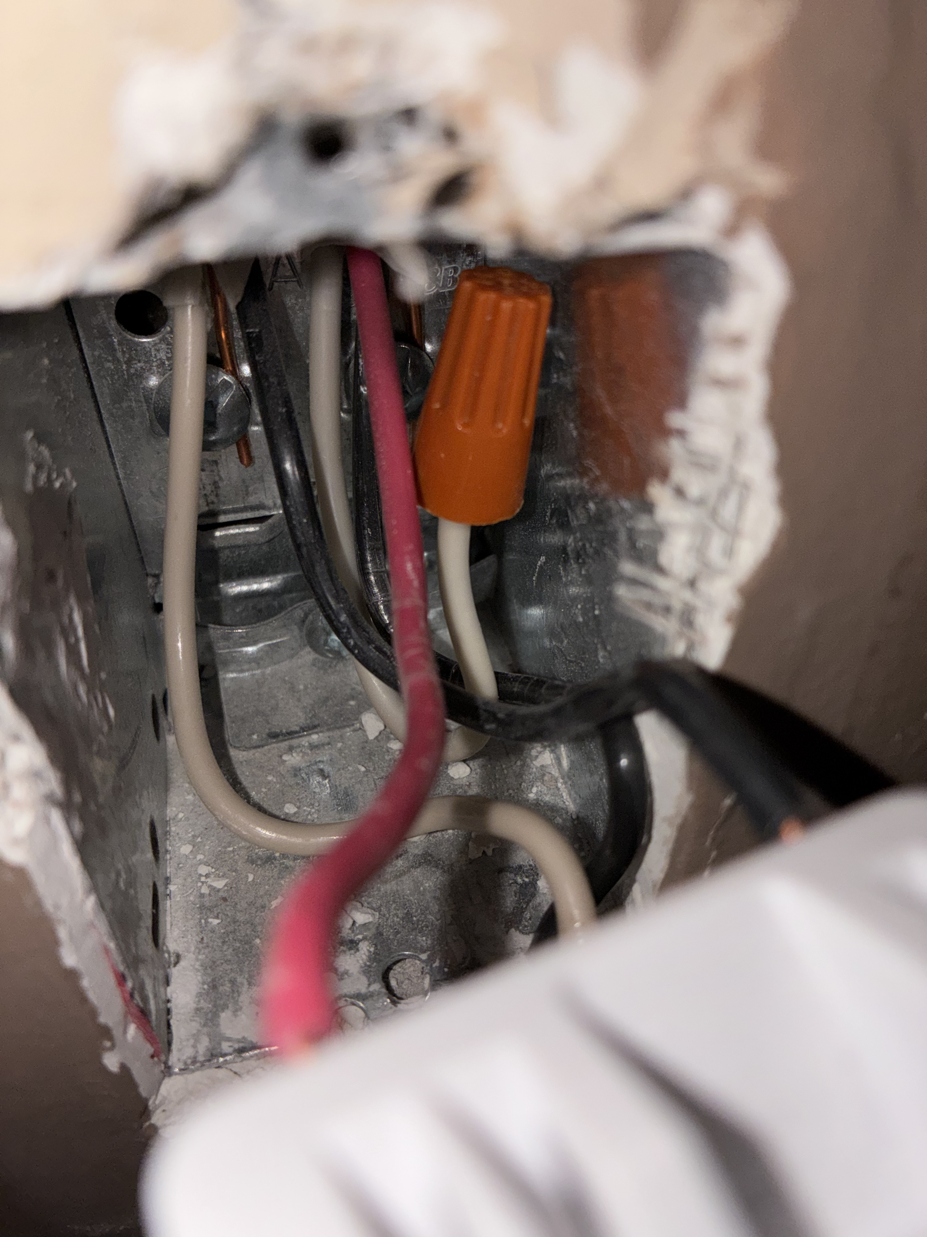

I checked the wiring and it looks correct to me. I might try an Inovelli on/off switch if that could help. This circuit has a similar load (non-dimmable integrated LED ceiling light and recessed lights).
There is a way that you can re-wire to get a hot and neutral to the switch box, but perhaps better to try the other things first.
Are the pictures you posted of the current problem? You referenced a “similar load”, so I’m not sure what I’m looking at. Also, you’ll have to label the pictures and where there is more than one switch, label where the issue is. I can’t do anything with those pictures as is.
I’d try the bypass or at least temporarily swapping out the load to a non-dimmable to see if that makes a difference. You didn’t post any details about the light so it’s impossible to analyze further.

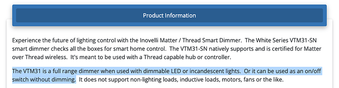

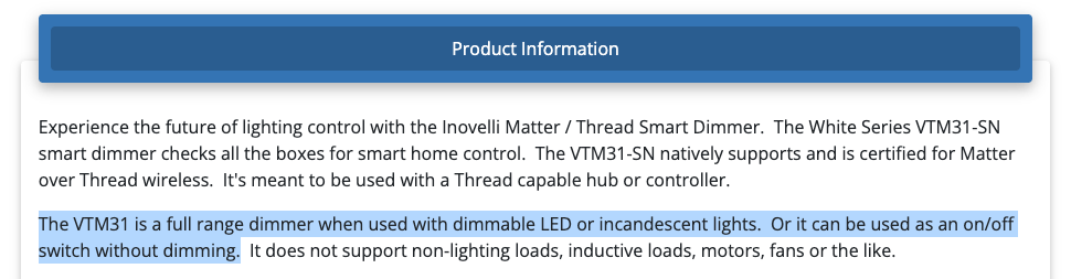

I’m not sure if this is a common issue, but noticed there is no explicit dimmable load requirement mentioned in the non-neutral FAQ or installation instructions.
It looks like the official product page doesn’t mention on/off mode, but the product description given by my retailer implies the switch doesn’t require a dimmable load.
