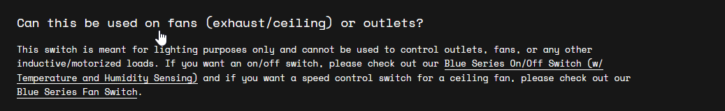

The dimmer is not rated for fan loads. Swap it out for a fan switch.

Are you sure this is accurate? I was told by Inovelli that I could definitely use the Dimmer switches on my fans. I have 5 fans 1 has no light kit, the other 4 have light kits.
If you are using a fan canopy module, then the canopy module is the device physically connected go the fan. In that case, you would be binding the dimmer to the canopy module to control the fan and light (or using automations). So for those installations with the canopy module, the dimmer is fine because it has no load physically connected to it.
The other fan, however, does not have a light kit, so in most circumstances, you wouldn’t use a canopy module. That’s why I asked if you were. If you are using a canopy module for this fan, then it’s the same as for the fans with the lights. The dimmer is okay because it will have no load physically connected to it.
On the other hand, if the fan without the light is physically wired to the fan, then you need to use a fan switch, not a dimmer. The dimmer is not rated for motor loads.
Real sure.
If Inovelli told you that you can use a dimmer directly wired to a fan, they misunderstood you. @Kaleb_Inovelli can verify.
