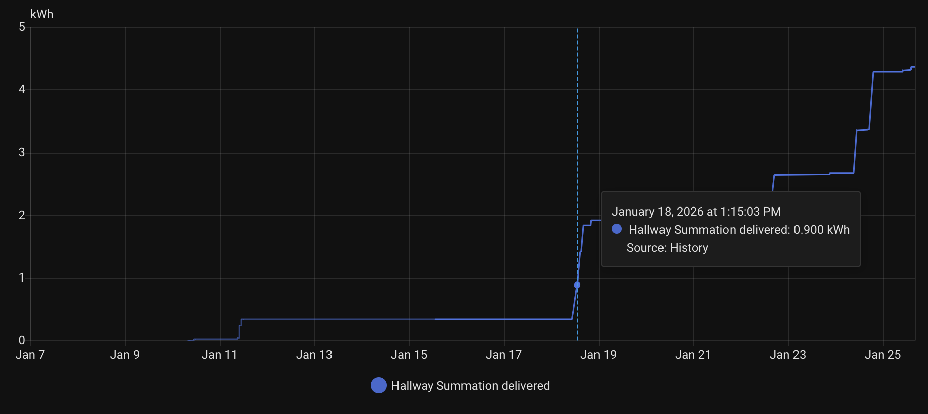

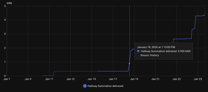

Here’s a graph - all the steep parts seem to occur during the brightest part of the day (the switch does have direct sun exposure.

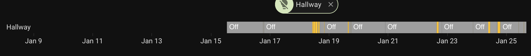

Here the corresponding on/off graph of the attached 24W LED lights
This looks like Home Assistant. Is this ZHA or Z2M? I know in Z2M we had to add a divisor to get the summation calculated correctly. It’s possible that’s missing in ZHA.
Yes, it’s HA using ZHA with this quirk installed.
Divided by 10, this number would look a lot more sensible - is there documentation around this?
That’s a question for @EricM_Inovelli@EricM_Inovelli. I have no clue how it’s configured in ZHA. This is the configuration in Z2M: zigbee-herdsman-converters/src/devices/inovelli.ts at 9330fc38d49b13877176020e5d8b5e17f3250670 · Koenkk/zigbee-herdsman-converters · GitHub
warm to mildly hot to the touch is normal 80-100f (30-38c). If there was truly 10watts being used by this switch 24x7 based on some back of the napkin math I would expect a surface temperature in excess of 90-100c ~200F. Which is what I mean by ouch hot.
The switch incorrectly reports its divisor as 100 instead of 1000. This will be fixed in a future update. Z2M, Hubitat, and SmartThings have it hard coded but I don’t know if that is possible by ZHA.

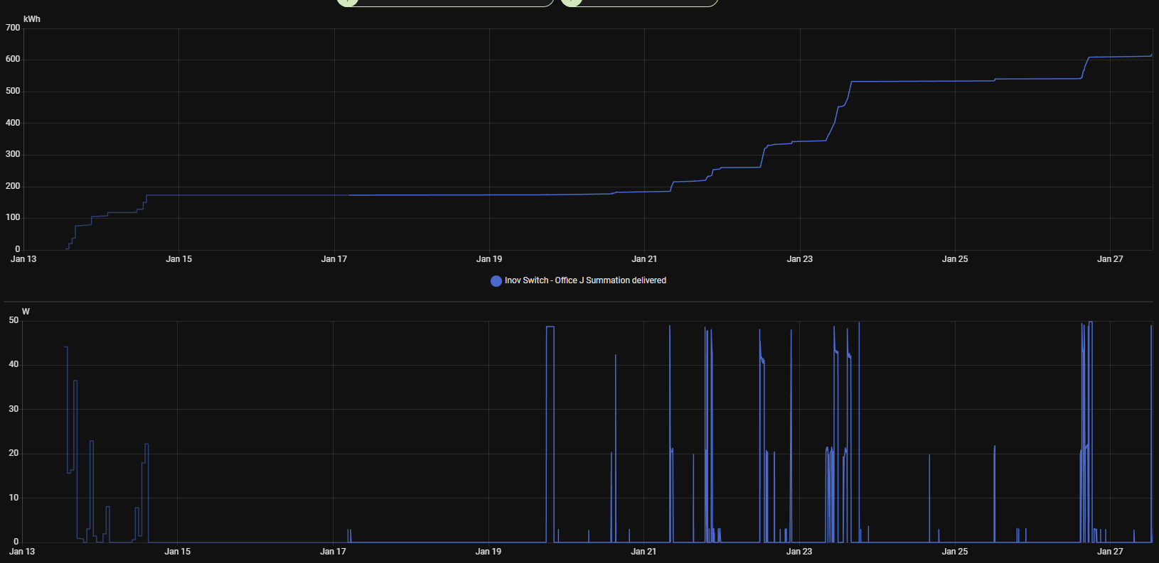

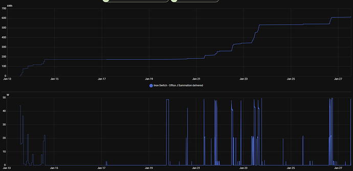

Seems this doesn’t need confirmation, but I just noticed my home energy report in home assistant with come crazy values for my office switch (installed mid Jan) and was coming here to check it out.
Home Assistant. ZHA. Controlling 4 grouped LEDs reading out 50W combined at 100%.
