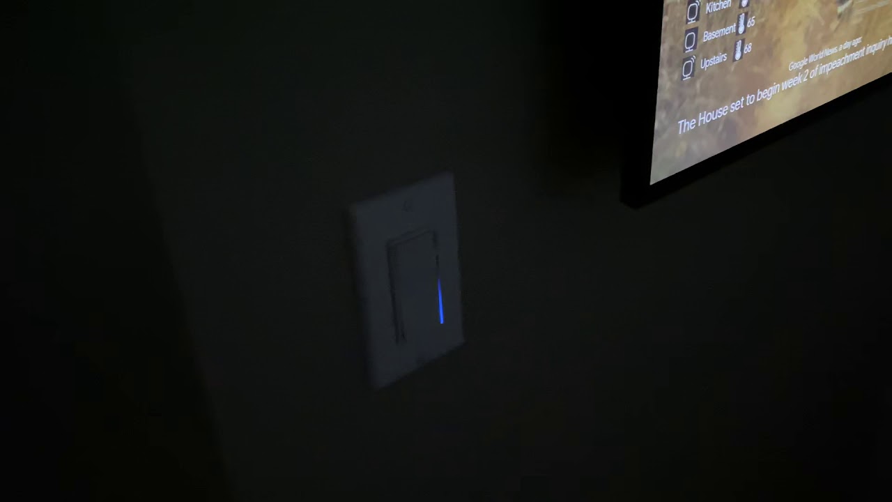

I have some strange behavior with the Red Series Dimmer LZW31-SN. I have my Dimmer wired up using the 4-Way Installation (Line/LoadSameBox) on page 8 https://inovelli.com/wp-content/uploads/LZW31-SN/Wiring-Guide-Dimmers.pdf I also changed the setting in SmartThings to Switch-Type 3-way Toggle.
You can check out a video of the issues here.
Essentially the dimmer will operate properly if the dumb switches are in a specific position. If I turn the switch on/off, it will turn the lights on/off, and the dimmer will still receive power properly. However 2 weird scenarios that are depicted in the video are the following:
  1. I can flip one of the switches to off and you can tap to turn on the dimmer and the led strip will light up, but the lights won’t turn on. You also don’t hear the switch click to turn on/off the lights (0:48 in the video)
  2. I can also flip one of the other switches and it will turn the lights on/off and I can go to the dimmer to turn the lights on and they will turn on, but then turn off after a few seconds. (1:36 in the video)

So I don’t have a specific answer for you. But I would get some pictures of your wiring. I’m 90% sure that there is a wiring issue somewhere causing it. The switch should always have power because of the neutral (assuming neutral install) thus the LED light.

I was going to say the same thing. It seems a wiring issue is causing the problem of the lights not working when that one switch is in one position. I’m assuming it all worked before swapping the Inovelli switch?
I would recommend making a drawing of the switches and where you are getting power in what position the switches are in. See if the switch that’s causing the problem is the other 3-way or is the 4-way switch and confirm where the power is getting.
