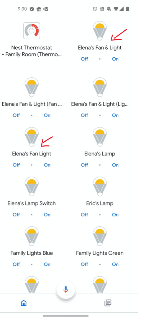

The only place I ran into difficulty was when I deleted one of the light virtual switches that VDS created. I have Hue smart bulbs in some of the fans, and without remote control protection the easiest solution is to delete the virtual light switch while keeping the virtual fan switch. This was no problem in ST, but even after an account reconnect Google still remembers the now-deleted virtual light switch and includes it in the room’s lighting group. When toggled via Google Home, the now-deleted virtual switch still works. Of course this causes power loss to the smart bulbs when voice commands are used.

This was wrong. Google is not remembering deleted devices. What actually happened here is almost as stupid. Google strips non-alphanumeric characters from both device names and room names. So “Room Fan + Light” becomes “Room Fan Light” in Google Home. Same with room names, so if you call it “John’s Room” in Google Home you will get “John s Room”. Anyway, I named my virtual light switches “Room Fan Light”, so after the unannounced name translation in sync, it looked like the deleted devices were still present. They were actually the combination “Fan + Light” devices with the plus symbol stripped. I also tried ampersand, comma, and single quotes and all were stripped out. (As an aside, did you know you can sync your Samsung and Google accounts so quickly you get a temp ban from the API? You can.)
So, in summary, everything is working as intended.
