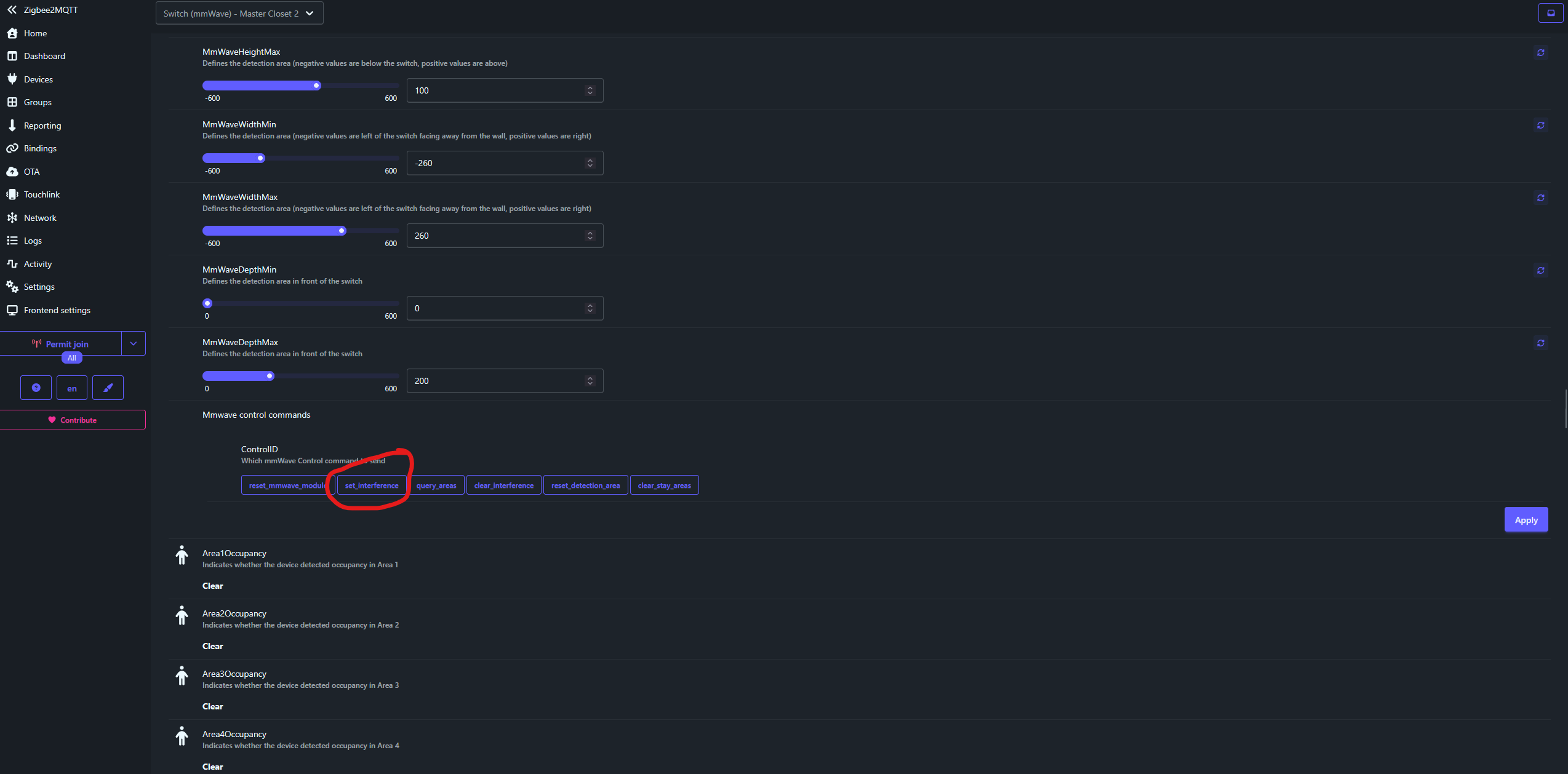

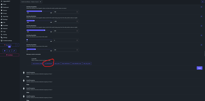

So after my suspicion got the better of me I finally bit the bullet and bought the newish ZBT-2 and stood up Zigbee2MQTT in parallel to ZHA using the ZBT-2 as the coordinator and migrated one of the switches over to Z2M and bam! There’s the option to set interference area… No custom quirks, no guessing at control IDs. What’s more is I could see the Interference Areas update and align in real-time when I requested the Set Interference Area command. I would have given anything for a screenshot from folks claiming to have an intuitive means to reach this setting so here’s mine.
