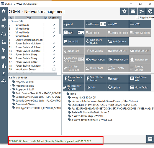

It *seemed like I was on the right track, as I followed the instructions in the Inovelli tech notes as well as similar guidelines elsewhere. I seemed to have added my z-wave stick to SmartThings as a secondary controller and it looks like I was able to perform a “GET” to get the firmware version. I ended up reseting my z-wave stick to factory defaults, manually deleting it from SmartThings and trying to add it back to ST. It adds back, my devices come over into SIC Z-Wave controller software but I cannot perform a “GET”. It fails with “ota firmware update iniitalization failed”. So the big thing is that on subsequent re-adds I am not getting the security prompt, it just adds it and the slave devices. I actually looked at the log and it made mention of security failing during the add. I was researching this and I remember reading somewhere that someone reset the S0 and S5 security? I have no idea how to get my z-stick and/or ST to go back to a state and re-prompt for the security pin/code.

Hi, I’ve used the aeotec z-wave stick gen 5 previous as a standalone controller, unpairing my device (i.e. a switch) from ST, pair to the z-wave stick in SL and upgrade. Now when I try to add the z-wave stick (after a factory reset on the stick) to ST as a secondary controller, it adds but I am not prompted for the DSK key. It brings over the devices from ST but that’s it, I can’t do a GET on any of them.
Now after spending a weekend on this, I am guessing the issue is the aoetec gen 5 stick is not S2 ready. I know I mentioned that the first time I tried to add it to ST I got prompted, but every since then trying to re-add I can’t get it to prompt. I don;t know if the first time it was a fluke or what. I’ve made sure there’s no ghost z-wave controllers in ST and the zwave stick was reset.

So I think I figured out my issue(s). I received my z-wave.me stick yesterday and retried adding it as a secondary controller. It still didn’t work. I realized though I was not following the instructions closely. When adding the generic z-wave in ST app, I selected “by brand” and not “by device type” - not sure why this makes a difference (as you see the same generic z-wave device icon in both), but when I selected, “by brand” I did not get the DSK pin prompt (which caused security to fail). Even though the device list comes over from ST, I can’t do anything as security failed on the z-wave stick. Retrying adding the z-wave stick from scratch (remove the z-wave stick from ST, reset it in PC controller) and then selecting “by device type” I was able to get the DSK pin prompt, added the 5 digit pin, and it added properly. I can then select one of the imported device (i.e. any of my switches), perform a “get node info” (very important to do this, I missed this also), and then go into the OTA update section and the “GET” button should now work.
So I think this was a case of “Read the Darn Manual” closely. I also went back and tried my original Aoetec Gen 5 (not the 5+) stick and still couldn’t get the DSK pin. As mentioned in the original post, I got the DSK pin prompt before (which tells me I follow the directions correct the very first time ) but not getting the DSK prompt when trying to add it again. I am going to reset the Aoetec Gen 5 stick using the Aoetec z-wave tool and try again later today.
