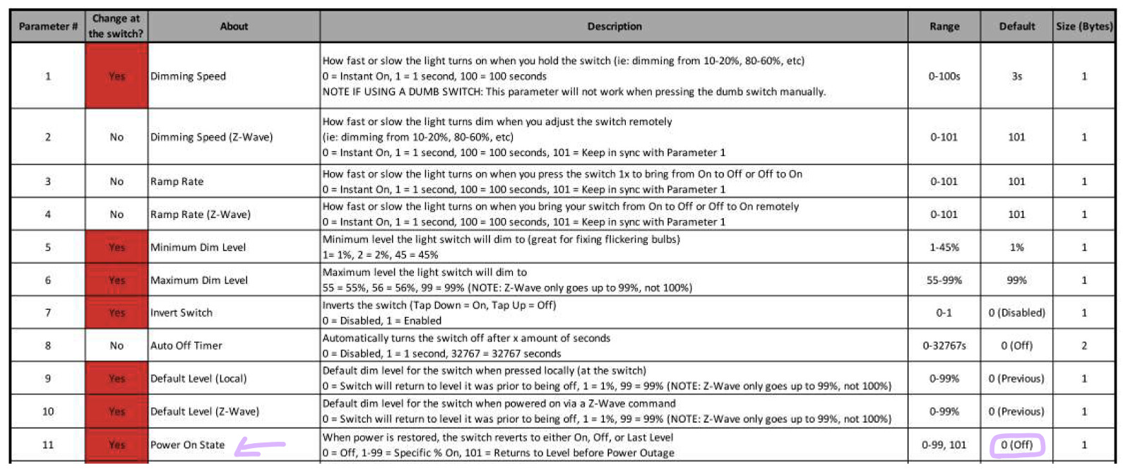

So for both Zwave or Zigbee smart bulbs, you want both turned on. You want SBM on because you don’t want the bulb to receive anything less than full power and you want DLC on because you don’t want the switch directly controlling the bulb wired to it.
For 1.35, you have those settings in two separate parameters.
Basically, for Hue (Zigbee) bulbs, you need to turn the switch into a scene controller where you use the tap function of the dimmer to tell the hub to run a scene (you’ll probably have multiple) to set the bulb(s)’ illumination level.
Just to be clear on parameters, there is no “power pass through state” parameter. For 1.35, you achieve that through setting multiple parameters.
1 - Turn on SBM. This insures that the bulb always receives full power, but it has nothing to do with any control of the dimmer turning on or off.
2 - Turn on the dimmer so the bulb is illuminated.
3 - Enable DLC. This insures that you can’t turn the bulb off via the dimmer. (You can still do so via the hub/Zwave.)
4 - As @kreene1987 advised, set the State After Power Restored, Parameter 11 to 99. This tells the switch to turn on after a power outage. With SBM enabled, this will be at full power to the smart bulb.
