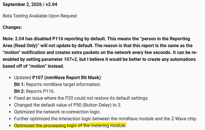

Switch is on FW 2.1, the issue mentioned above was supposedly fixed in Feb in that version according to Red Series mmWave Firmware Changelog | VZW32-SN .
Edit: visualized
Hi @dbxfb, can you please test the 2.04 firmware? It is in the “pre-release” of the Z-wave JS OTA page or I can get it for you and you can install it manually. There was an additional update in 2.04 for energy monitoring:

Ok, @EricM_Inovelli, I’ve tested 2.04 on my mmWave dimmer and that seems to make the energy usage be the right order of magnitude!
Specifically, my mmWave dimmer was left on for ~29 minutes pulling ~11W and resulted in an energy delta of 5Wh (raising from 1.328kWh to 1.333kWh, so a .005kWh change). So, multiplying 29 minutes of 11W would result in 5.31Wh, which is approximately what we got here, so this seems about correct!
Is there an equivalent update for the VZW30-SN (and also VZW31-SN)? The VZW30-SN in my possession certainly has this issue as it stands. I would be very glad to see this corrected across the board.
Thanks for the feedback, I will check with our firmware team to add or make sure these changes are in our other products.
Confirming that it also appears to have fixed it on my end on the switches I updated. I reset the meters after the update, and low power lights that have been on for extended periods are displaying reasonable meter values rather than multiple kWh per day.
