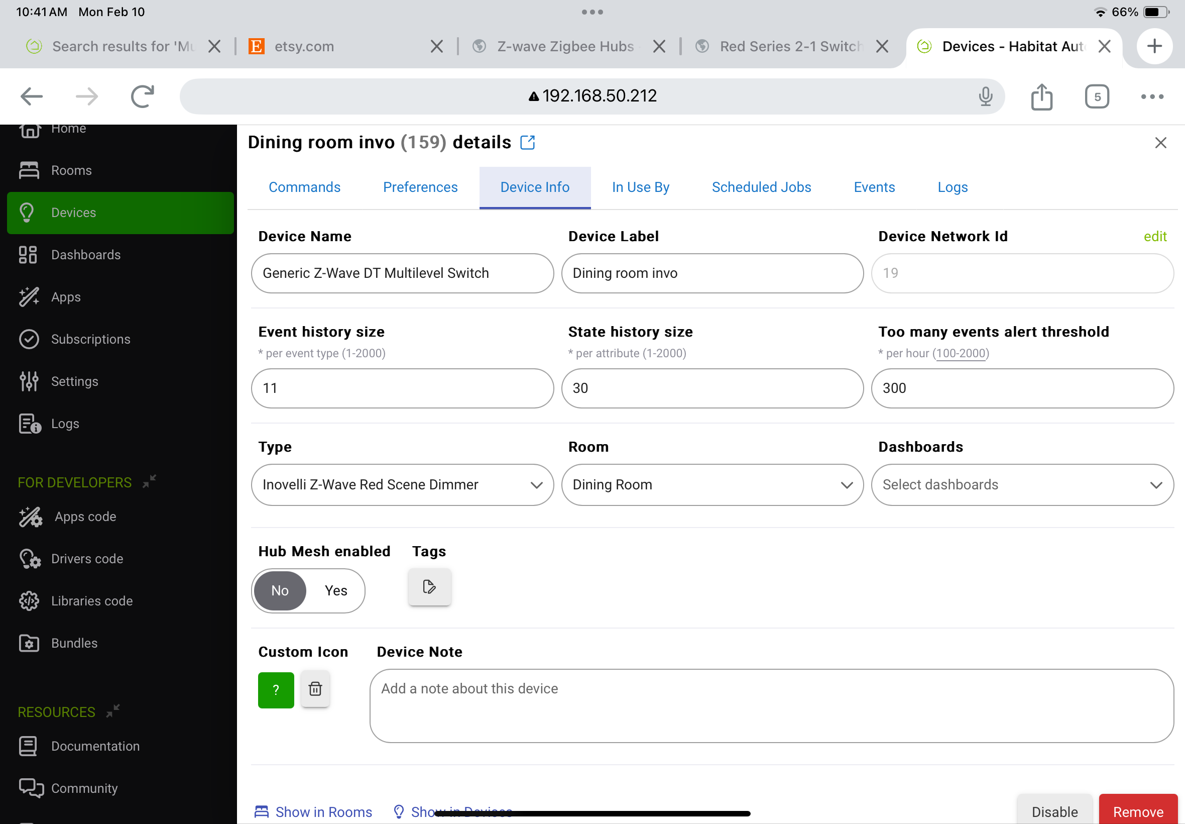

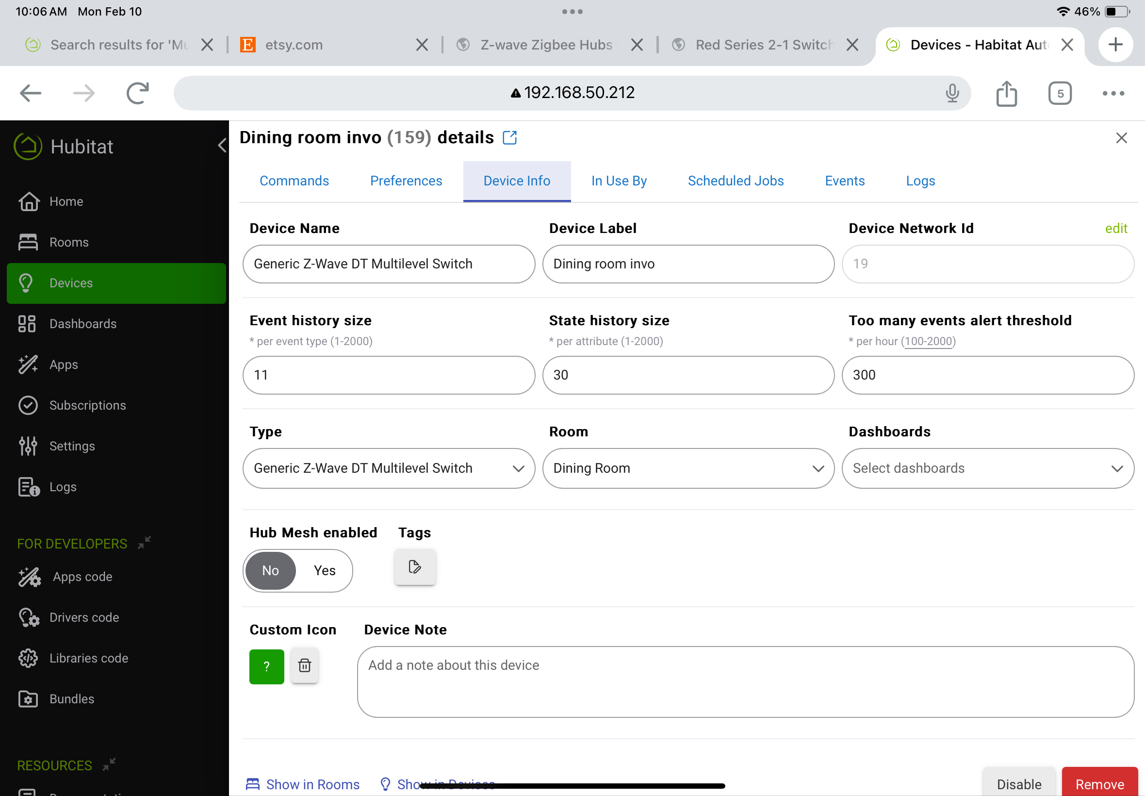

Hello I’m using Hubitat what driver should I be using ? On both drivers doesn’t seem like it’s doing anything. Also I hold down on the switch it’s not dimming . Yes I have it set as a dimmer in the app.
Does this thread help? I don’t use Hubitat, but you definitely need Inovelli’s driver to be used: Red switch install few questions - #4 by SViel
Thanks I’m using inovelli driver now and everything is working well.
