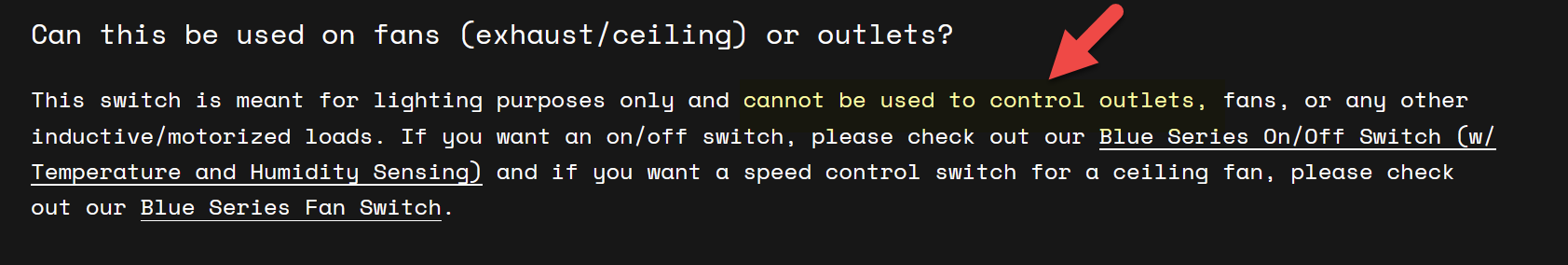

You’re using a Red 2-1 to control receptacles? This is the first problem - Since the 2-1 is a dimmer (not an on/off switch), it cannot be used to control receptacles.
I think the second problem is that you are overloading the switch with the amount of lights you are running. From the specs (emphasis mine):
To reduce the risk of overheating and possible damage to other equipment, do not install to control a receptacle, a motor-operated appliance, a fluorescent lighting fixture or a transformer supplied appliance and do not use the VZW31-SN load output to control no more than indicated, which is: 600 Watts (Incandescent), 300 Watts (LED), and 150 Watts (CFL).
If we assume that each of your C9 bulbs are 1W LEDs, that means you’re trying to run 600W on a switch rated for 300W LED load maximum.
That switch will be able to control receptacles as well as handle higher loads. From the specs of the blue series on/off switch. The red series one should be roughly the same once it’s ready.
​Maximum Lighting Load (Watts): 120V AC - 960W Incandescent, 600W LED/CFL, 277V AC - 1385W Incandescent, 600W LED/CFL
I would say it’s a better fit for your usecase.
