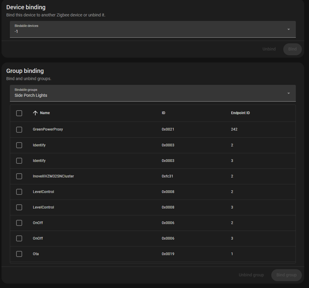

  1. I created a group of lights by going to Settings > Zigbee > Groups and choosing + Create Group and adding the 3 Hue Lights. I did not include the switch itself in the group. QUESTION: Should the switch be included in the group?
  2. On the VZM32-SN device page (Settings > Zigbee > Devices > VZM32-SN switch) I enabled the Smart bulb mode Configuration property.
  3. I selected Manage Zigbee Device from the 3-dot menu to the right of “Reconfigure” option on the Switch device page, and chose the Bindings tab.
  4. In the Group binding section of this tab, I selected the light group I created. The VZM32-SN switch has two different endpoints that have “Identity”, “LevelControl” and “OnOff” binding options, Enpoint ID 2 and Endpoint ID 3. Endpoint ID 2 also has an option “InovelliVZM32SNCluster” (0zdx31). QUESTION: Which of these bind points need to be bound to the light group?
I’m hoping the switch will always reflect the state of the light group after binding is done correctly. Thanks for any insights.
