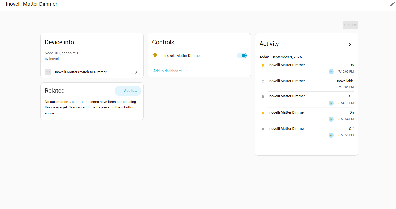

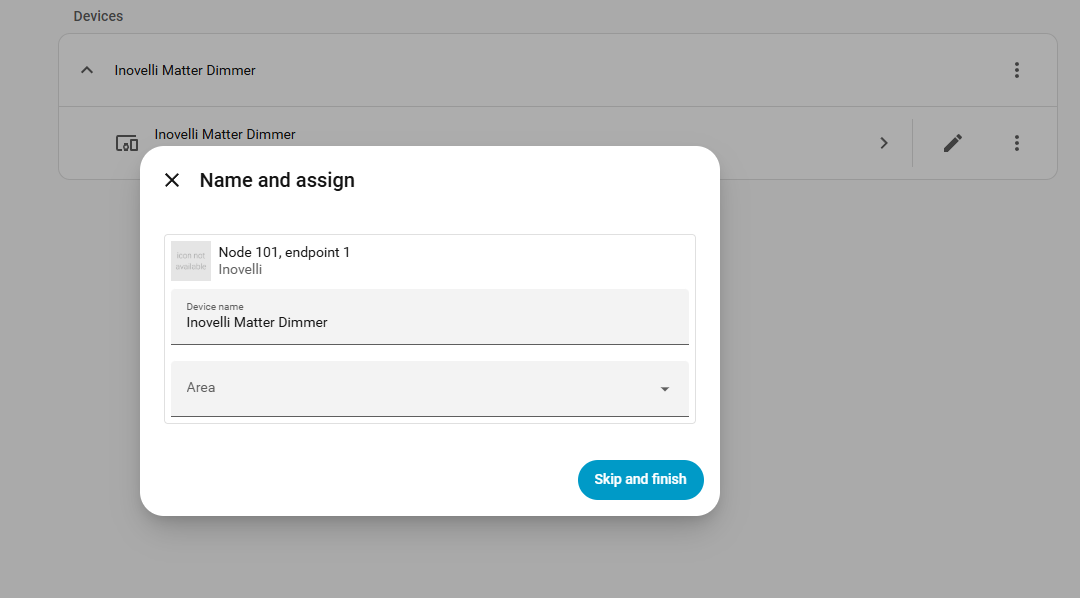

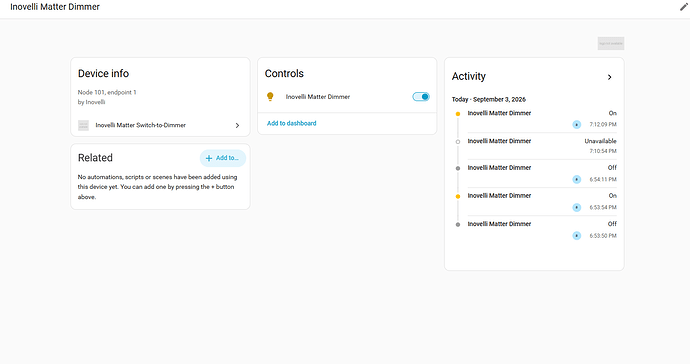

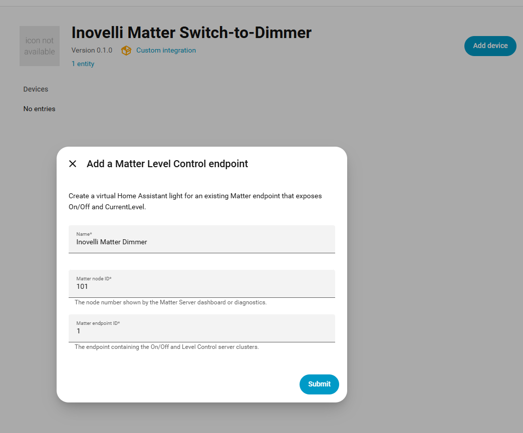

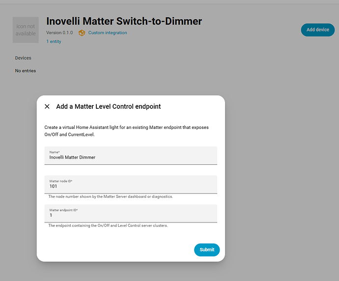

@MakaniKai I had chatgpt create a custom integration that will create a light device to use in your case.
InovelliUSA/inovelli-matter-switch-to-dimmer: Inovelli Matter Switch-to-Dimmer is a Home Assistant custom integration that creates a virtual brightness light for an existing Matter endpoint, even when Home Assistant normally exposes that endpoint only as an on/off switch.
The node ID can be retrieved from the matter server interface, and the endpoint will be “1” on the VTM30-SN.
We will continue to look at a firmware solution, but this should help in the meantime.
This is excellent (and an “above and beyond” contribution) and in a quick test this morning it works as advertised!
Dimming from the “light device” matter’s Level control “CurrentLevel” lined up with the light device dimming level in HA and with the LED bar on the VTM30.

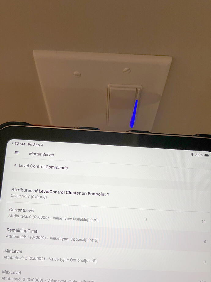

However dimming from the paddle the “CurrentLevel” did not match the position of the LED bar. This was whether the “light device” was programmed or not. Note all animations and all bindings associated with the switch were disabled/removed for the test.
The VTM30 has firmware 1.0.5, has “Smart Bulb Enabled” and the "Dimming Speed’ was set to 1 sec. The results are easily duplicated and seems to get worse the more times you dim up or down.

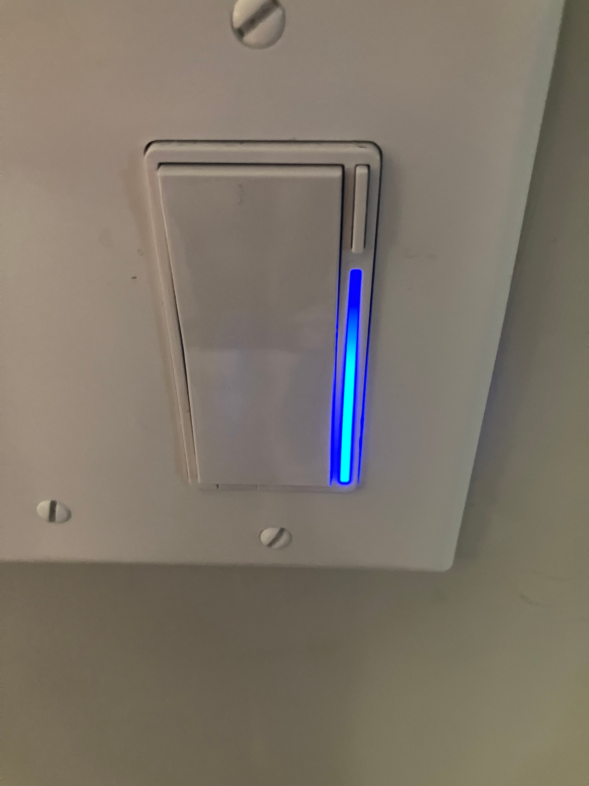

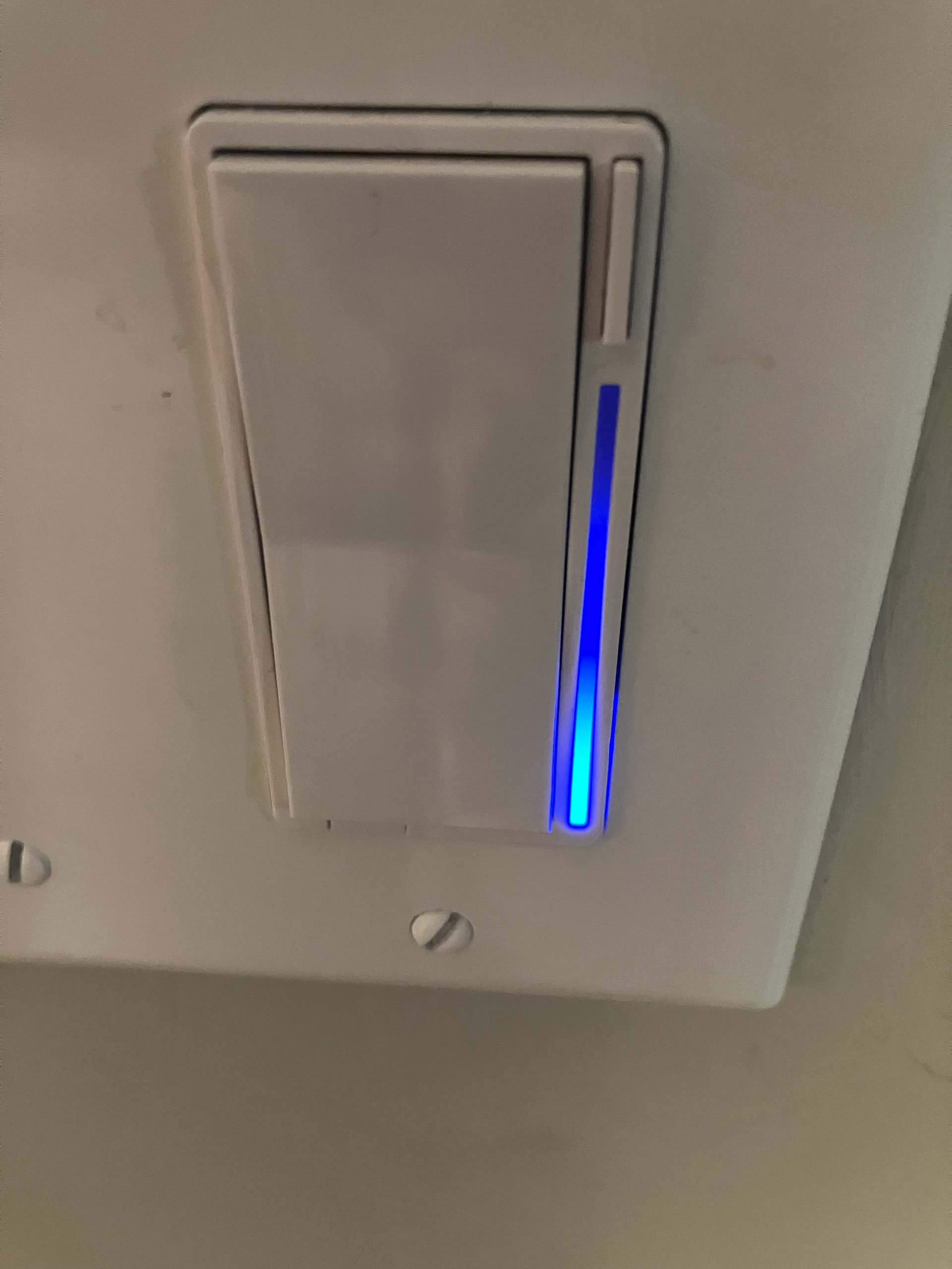

Here are some (not so great screenshots). The first shows the a “CurrentLevel” of 41 on the HA Matter UI but the bar position on the VTM30 is much higher than would be expected. The LED bar dims up and down as expected, however the “CurrentLevel” displayed in HA lags behind.

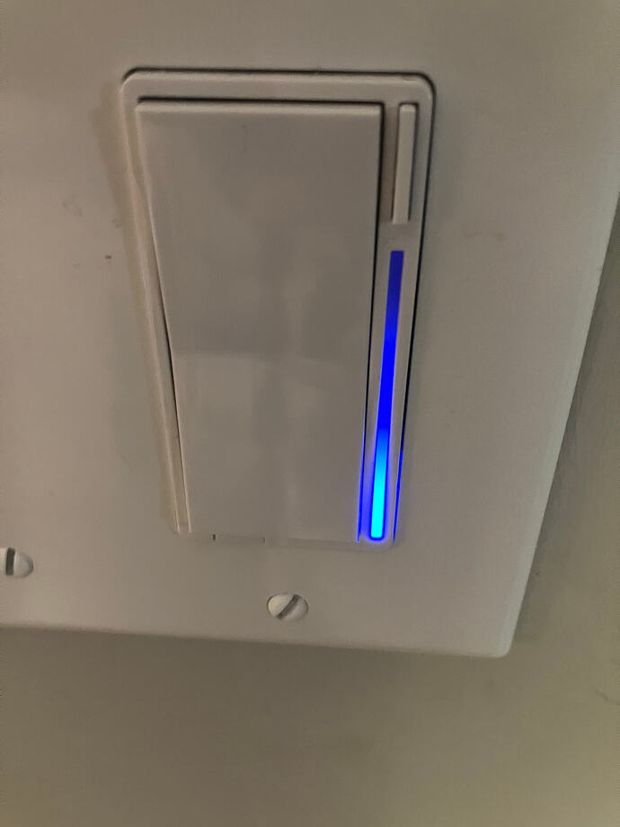

This is a close-up of the same LED bar (nothing changed from the first picture so the CurrentLevel in HA is still showing 41).

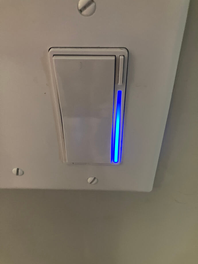

This is the “correct” position of the LED bar when the CurrentLevel is set to 41 manually via the MatterUI.
Let me know if I can provide further info.
One other observation. When the LED bar and “CurrentLevel” do not match, turning the switch off and back on again will return the bar to the previous position but will also change the CurrentLevel in HA to a value that matches the bar position.
Interesting, I also see this on the VTM31 (haven’t tested other devices). I think it is less obvious with a dimming speed of 3s (which is what I was initially testing). I believe the proper description of this bug would be that the “LED bar and load output (tested with multimeter) do not match what currentLevel reports”. CurrentLevel is used to determine the % in the various hubs so I am a little surprised this hasn’t been noticed yet.
I’ll give it a try at 3secs and see how it behaves.
You are correct, it’s much less visible. However the issue is still there.
@MakaniKai Have you tried the integration that @EricM_Inovelli generated?
I gave it a try and it seems to work very well for the application that you described.
Yep, we have figured out the root cause and it will be fixed in the next update.
Great… happy to try it as soon as you have something.
Should be fixed in the latest VTM30-SN update:
