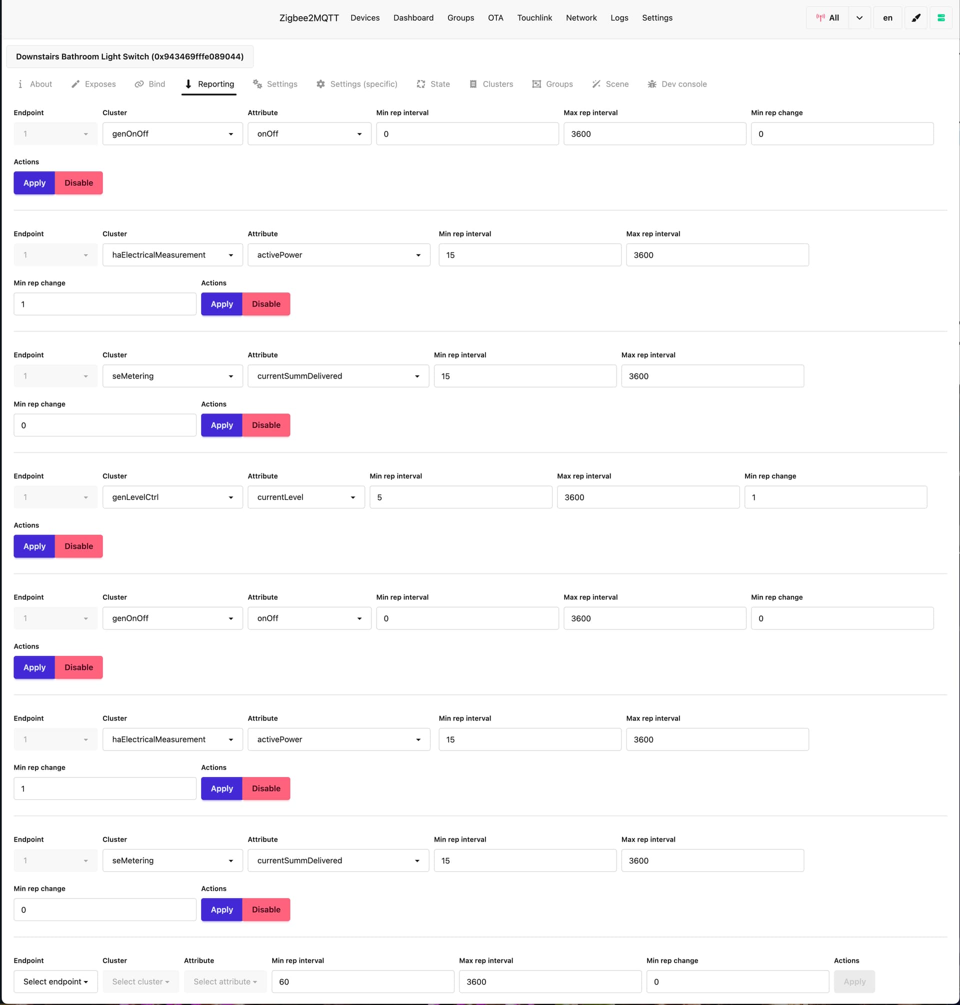

Sounds like your reporting settings didn’t get set correctly. Did you see any errors when adding the switch?
This is what the reporting settings look like on my switches:

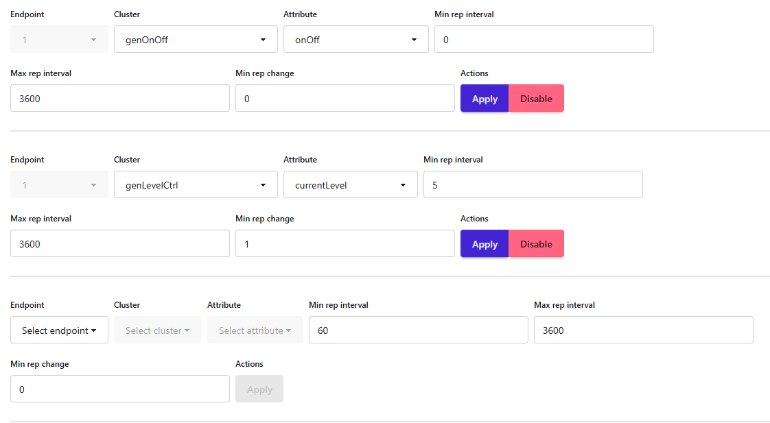

And yes, I have a lot less reporting auto-generated:

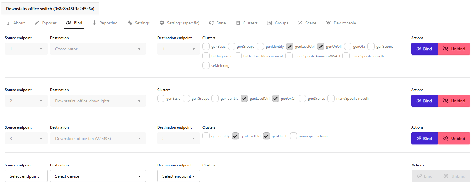

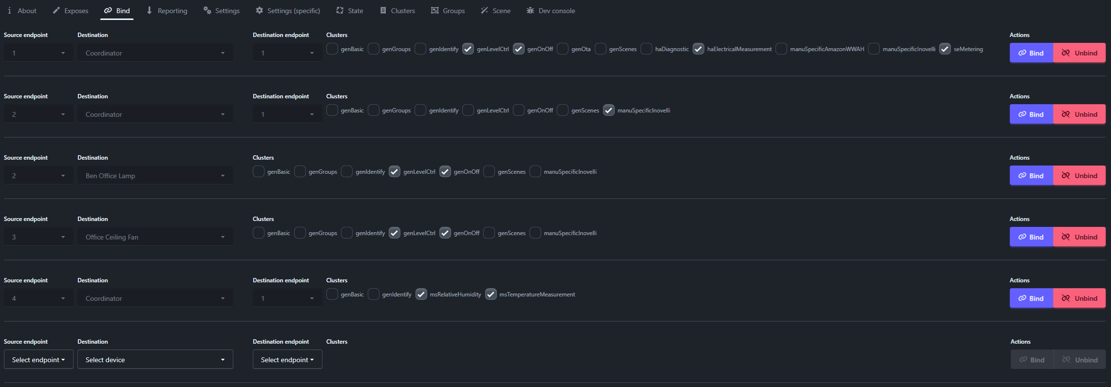

This is just a guess, can you show us how the switch is bound to the coordinator in Z2M? A binding issue should have been cleared with the resets that you did but it’d be good to rule out something going on there. I remember reading some posts back in the day where certain clusters were not binding to the coordinator as expected.
Here’s an example from my network:
I checked each attribute in that error message, and it’s fanTimerMode that errors out.
