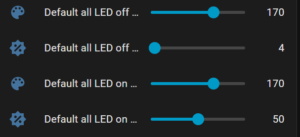

As for the LED bar, it is very configurable. Not only can you set LED intensity based on on/off state, but also change its color.
For example, these are my settings for a bedroom:
On
color: blue (170)
intensity: 50
Off
color: blue (170)
intensity: 4
At night, I programmatically set on intensity to 2, and off intensity to 1 so that I can still see them, but not have them light up the room.
Snippet from Home Assistant’s device configuration page:
