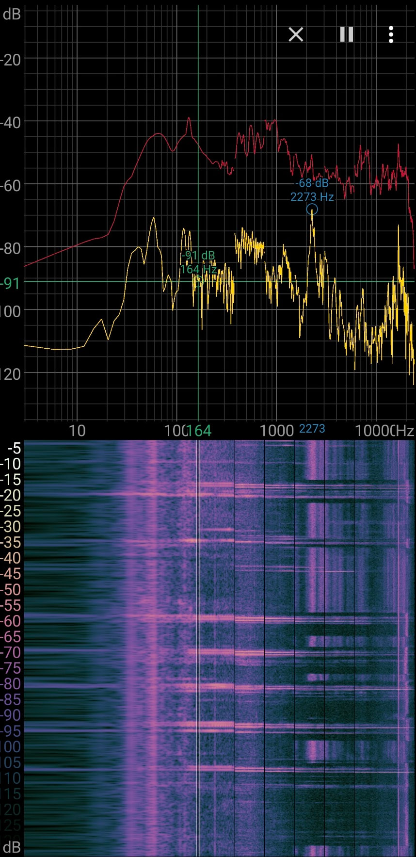

I captured the fan switch noise with a spectrum analyzer app on my phone to get a better idea of what is happening.
The pronounced horizontal lines in the waterfall are the paddle clicks. The actual buzz is the activity mainly to the right of about 2.3 kHz. The buzz is not constant when pressing the paddle up and down repeatedly.

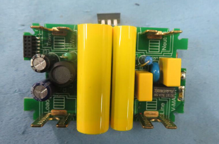

FCC internal picture seems to show there only are a couple electrolytic caps:
Is it one of those on the left edge?

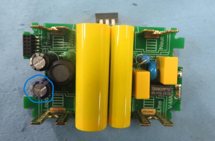

I believe it is the cap circled that is vibrating

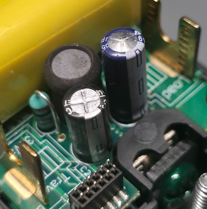

@Lance_Inovelli I can confirm it was indeed that capacitor, an Aishi 16V 470µF, which I’m guessing is an ERR1CM471E14OT or similar. The top has cracked open and is bulging.
Given the tiny size, 6.3 × 16 mm with 2.5 mm lead spacing, and the circuit it is used in, I don’t want to replace it with anything inferior, low quality, or questionable. That includes ChengX, so I was a bit surprised to see one used on the HV side of the circuit.
The ChengX is the 3.3µF 400V capacitor right next to it, which I may as well replace with a higher-end brand once I manage to source the 470µF capacitor.
