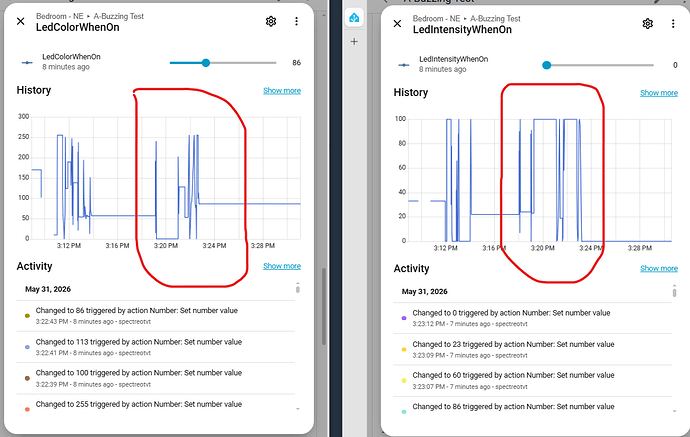

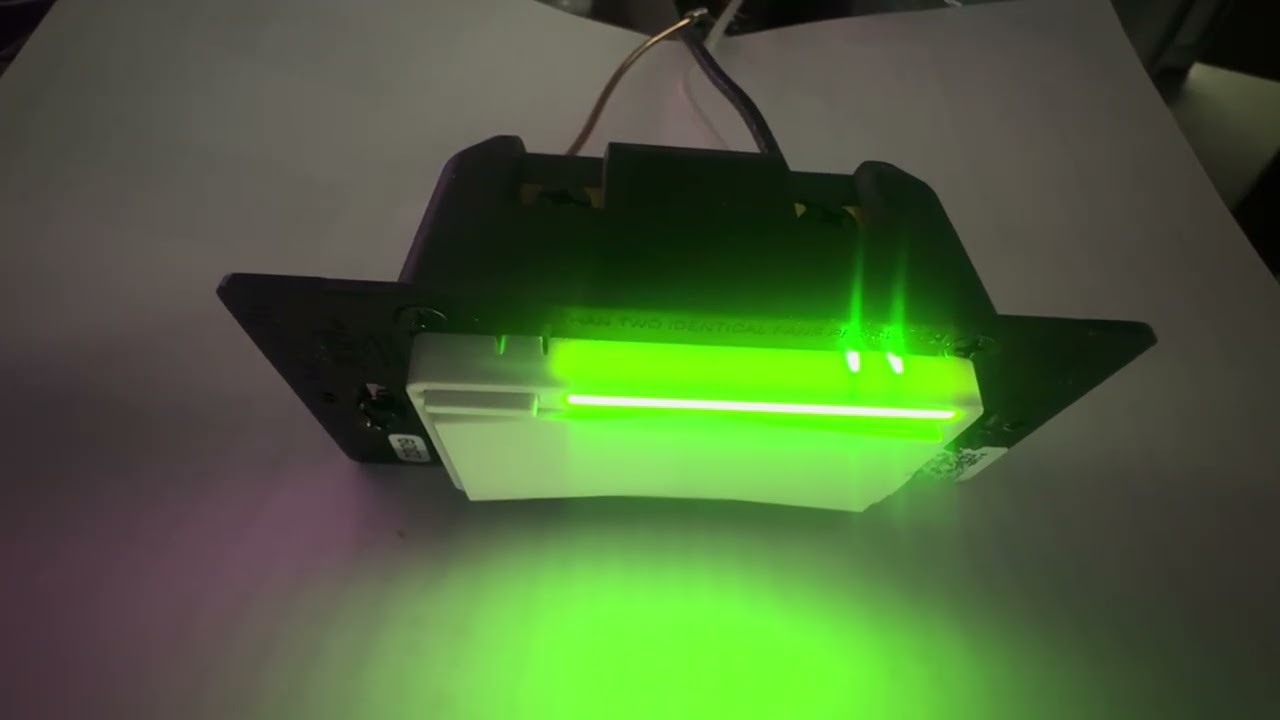

@spectreotvt , can you post some video and screen shots of your configuration and how you are activating the LED intensity level?
I will need to hook it back up somewhere to do that, but I will work on that tonight.
hopefully that works…
Those are the time and changes in general for the intensity and color. The intensity made the most difference, but the color did seem to make a little bit of change. Green seems to produce the least noise this time, which is different then what was happening when it was still mounted in the wall.
So it would seem that the load on the switch might make a difference, but I did not have anything I could rig for a load on it this time.
The buzz/hum is always present as long as the switch is powered. There is no load on the switch in this test, and it is wired in with neutral and ground.
It was powering this fan : Amazon.com: Hunter Fan 64 inch Noble Bronze Indoor Ceiling Fan with Light Kit and Remote Control for Living Room, Bedroom, Office, Laundry Room (Renewed) : Tools & Home Improvement
The previous switch that did this same thing was on this fan : Amazon.com: TroposAir 72" Tornado Oil Rubbed Bronze Industrial Ceiling Fan… : Tools & Home Improvement
The light for the fans was on a separate switch.
Noise is affected most by intensity, a little by color as shown in the video.

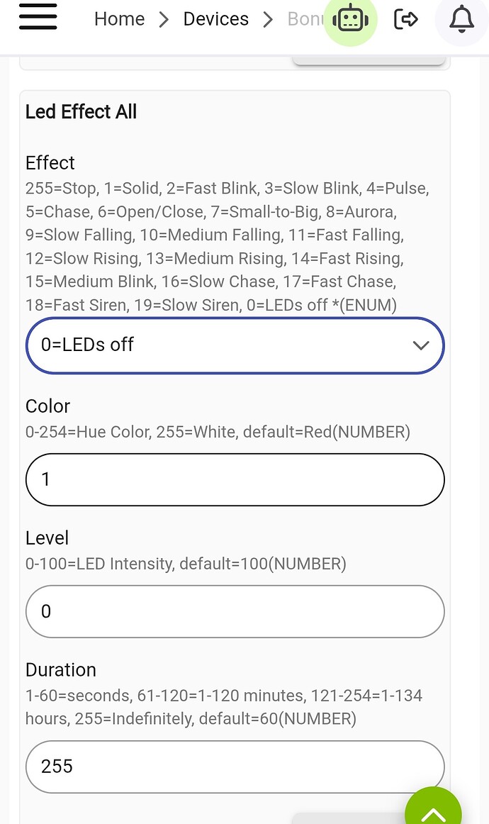

@Mop_Zero can you add some info on how you are setting the LED bar intensity and any additional switch configurations. Do you have any LED bar notifications created or setup on this device (though automations or parameters)?
I’m happy to send this one back to you guys, just let me know where to send it.
That won’t be necessary, Eric said that the capacitor may be failing and that is being looked into by engineers, but thank you for that. VZM35-SN Blue Fan Switch - The buzz strikes back - #6 by EricM_Inovelli
Hi Lance, I’m making the adjustments to the led effect via hubitat. I’ve removed any automations associated with the LEDs on this switch.
