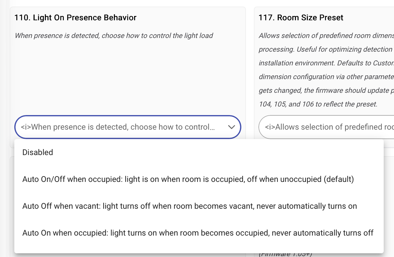

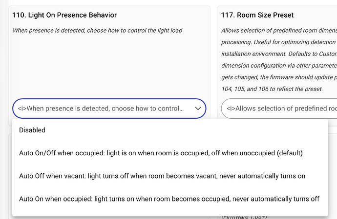

If I want to do this in Hubitat using Rule Machine (RM), I assume I would do a « Set Parameter » command with the value of 110 as the first parameter, and 0 to 3 as the second…?
These are the listed option, so I assume 0 is disabled, and 3 is « On when occupied »… Correct?

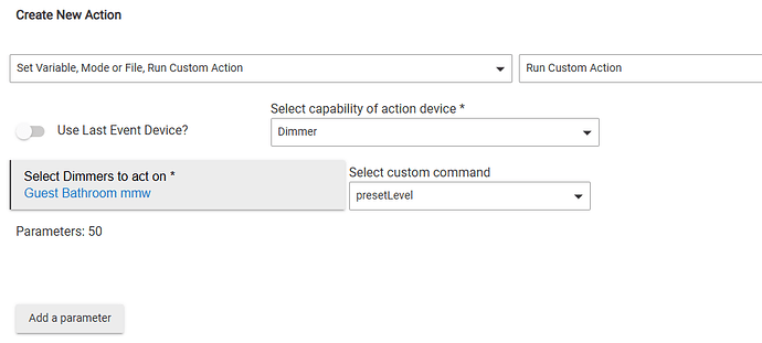

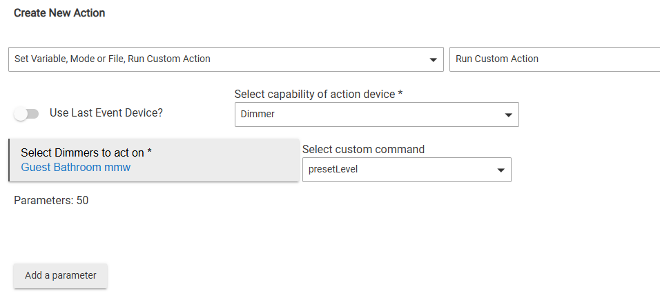

You can use rule machine to set what level the light will turn on at, it is just not very intuitive how to do it.
“Parameters: 50” was added by clicking “Add a parameter” and adding a number. This sets the level the switch turns on to without actually turning it on. You could set a rule that at certain times of the day when lux below a number and other switches off or below a level the preset gets changed. Basically set it so if dark and lights off it sets it low so you do not flash bang yourself in the middle of the night, but still have it turn on full bright if the attached room has its lights on full. This does not allow a zero so you can’t use it to not turn on the lights, but you could maybe set it so 1% is below what the leds need to turn on and set that. Dunno if that would be bad for the lights though.

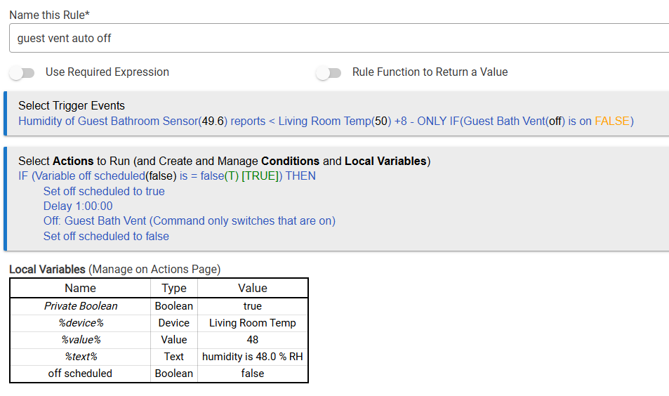

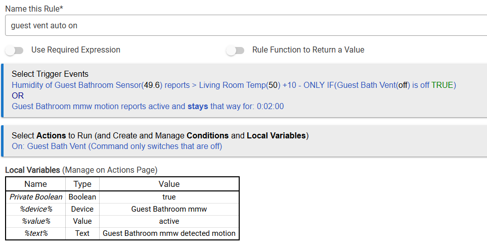

When I want to rate limit an automation on Hubitat to prevent that I simply add conditionals like this one to only send the on command if it is off.
and for the off trigger I’ll us a conditional and a variable.
So this turns on the bathroom fan if I am in there 2 minutes or the humidity in there is 10% higher than the living room, but only if the fan is off. This way it is not constantly turning it on. Then for turning it off since I want the fan to run a while to dry out the room or clear the stink it sets a variable to prevent the trigger from running multiple times, waits, turns off the fan, then clears the variable so it can be triggered again.
Doing something like this with conditionals for lux level needed to trigger it would allow you to have the light only turn on when needed at the level you want, and only turn off when you want. So long as your z-wave network is healthy and your hub not overloaded you should not see any noticeable delay compared to on device triggering, and have minimal traffic since you would only be adding the command to turn the switch on.
