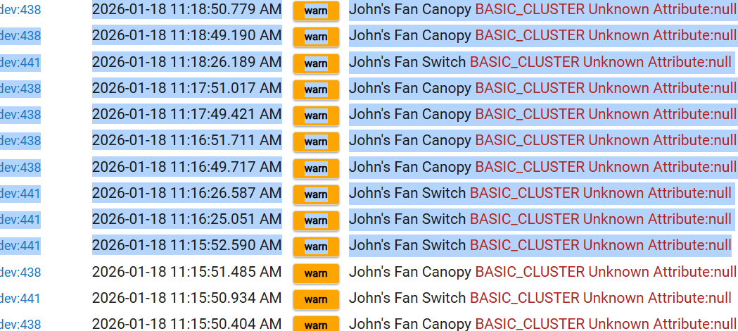

Hello, I’ve been having issues with my VZM36 blue series canopy fan and light module, and my VZM31-SN dimmer switch installed on Hubitat, I did talk with Lance from Inovelli where he tried to resolve my warning issues. Since the warning issue started in my Hubitat log’s I done several recommend suggestions such as re-paired the devices updated the drivers and firmware, totally excluded the devices from Hubitat and reinstalled them again with the latest drivers to recently having the warnings come back from both the switch and the canopy which are both giving the below warning, is there anything else I might be missing? Any help to remedy this would be greatly appreciated. I would like to pick up a few more of these units for other areas in the house but want to resolve this first. It was recommend that the warning sign had no importance and should be removed from the driver as Option 2 but i can not find these lines in the Inovelli drivers.
So am I the only one with this issue?
