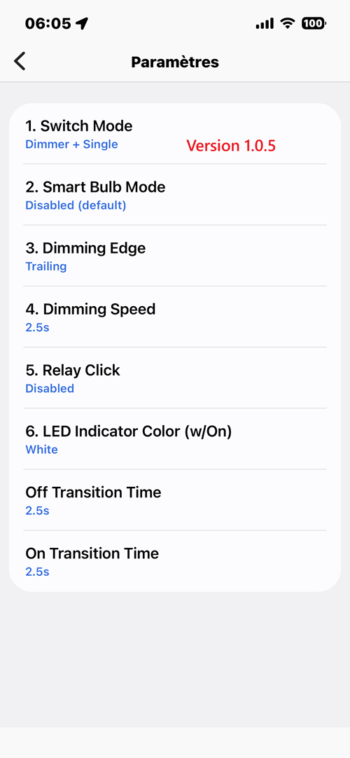

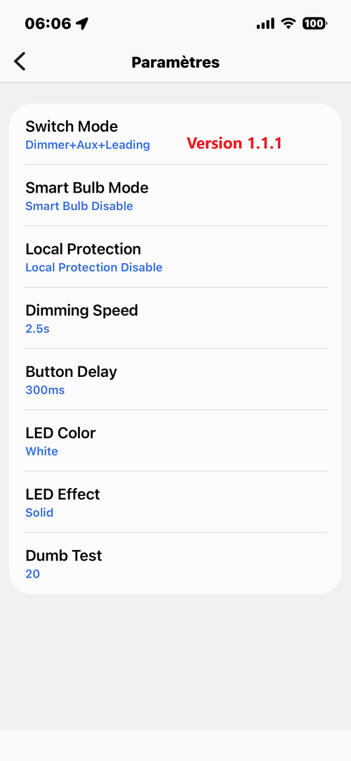

However, I’ve noticed something that I’d like to confirm with the community (and I assume this might be expected since it’s a beta release). In a SmartThings environment, the parameter configuration no longer appears to work properly, even after performing a factory reset on the device. At the moment, I’m configuring the switch manually using the physical button combination sequences, which works as a workaround.
Could anyone confirm if this behavior is normal for the beta version, or if there’s something I might be missing?
You bring up something a little tricky with ST. The configuration options are statically set in the driver and can’t be dynamically read from the device like with other platforms. This makes it so we will have to have multiple drivers for multiple firmware versions. I will have to make a driver for 1.1.1 to resolve this. I think we can probably have a “prod” driver that reflects what the certified firmware has and then release beta driver for any variation in the beta firmware.
Got it, thanks for the feedback. I’ll wait for the official version then. Thanks to the advantages of Matter, I can still temporarily present the device to Home Assistant to adjust the configuration if needed.
I actually was able to find a way to make the driver switch to a different profile based on a firmware version. It should automatically update for you within the next day or so, but if not try pulling down on the device page to refresh the device.
Thank you, Eric, for your efforts—it’s working. I can also confirm that the other VTM31-SN units still on version 1.0.5 have retained their parameters, while those upgraded to version 1.1.1 now show the new parameters. The LED Effect parameter even appeared in this version.

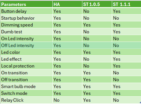

This isn’t an issue for me, but I’ve noticed that some parameters I don’t use are accessible in HA, yet not available in SmartThings settings in either version (1.0.5 or 1.1.1). If you ever need a list of the missing parameters to refine the final SmartThings driver, I’d be happy to help.
Can you let me know? It might be cluster specific settings that aren’t part of the “mode select” config, but maybe I missed something.
