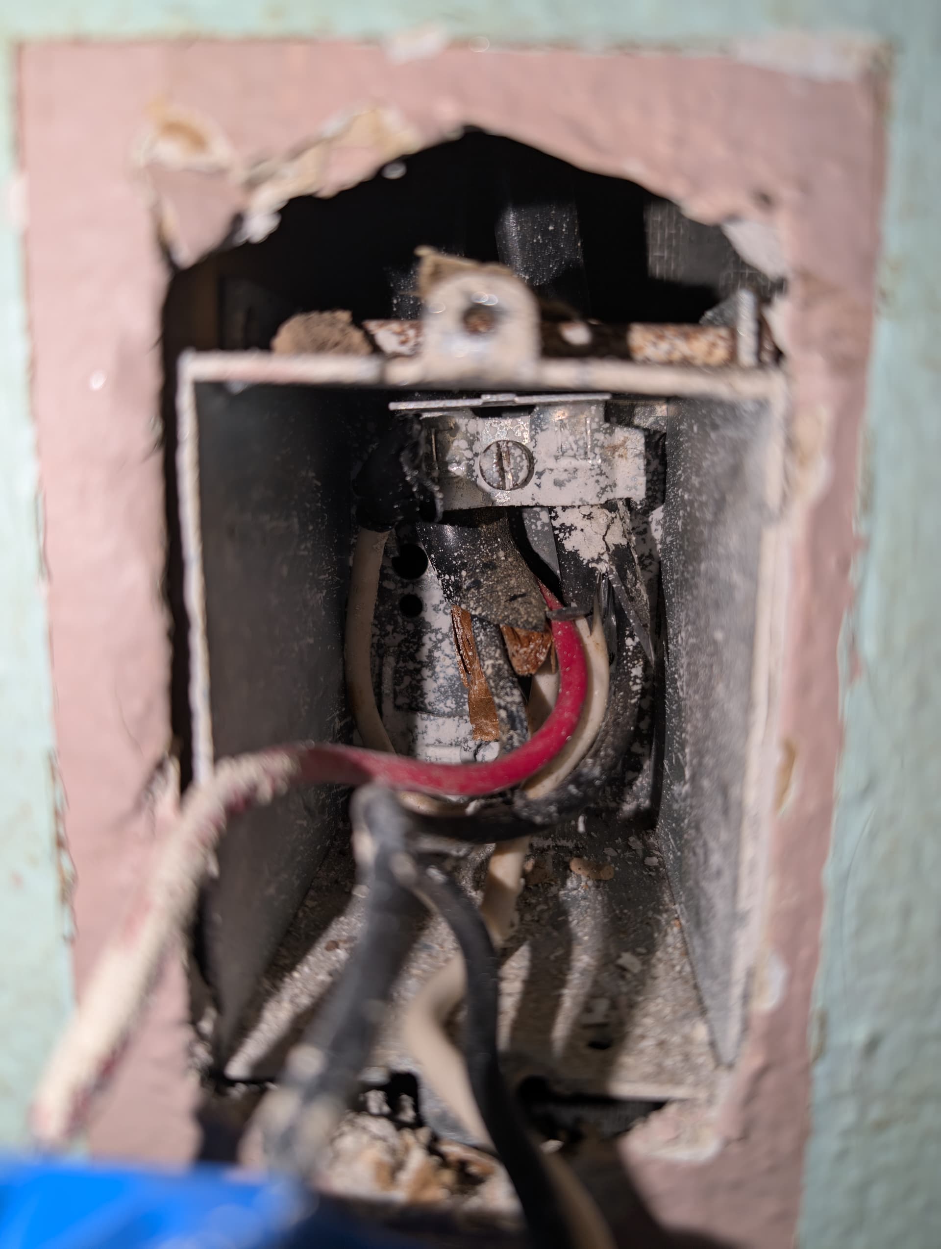

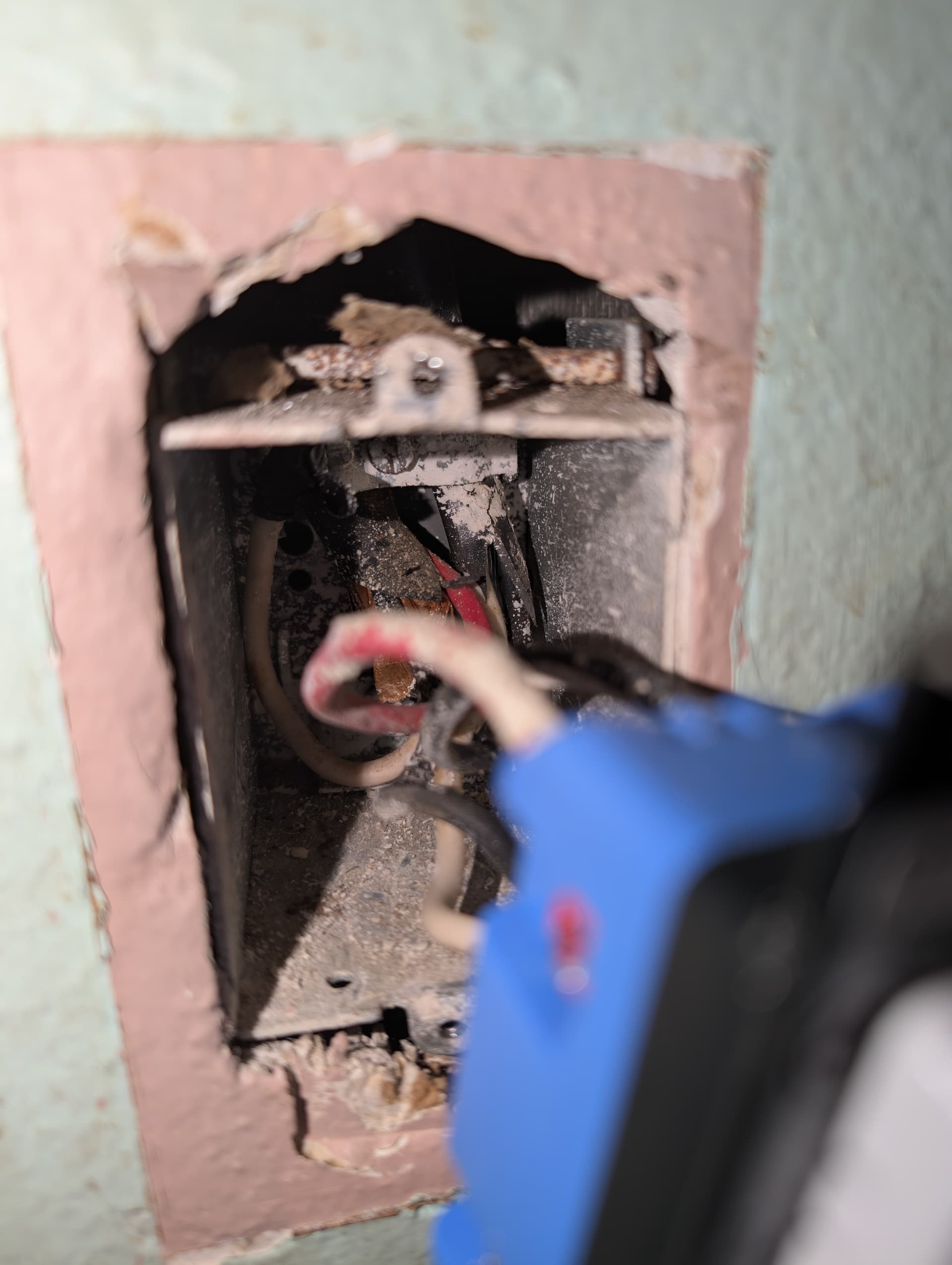

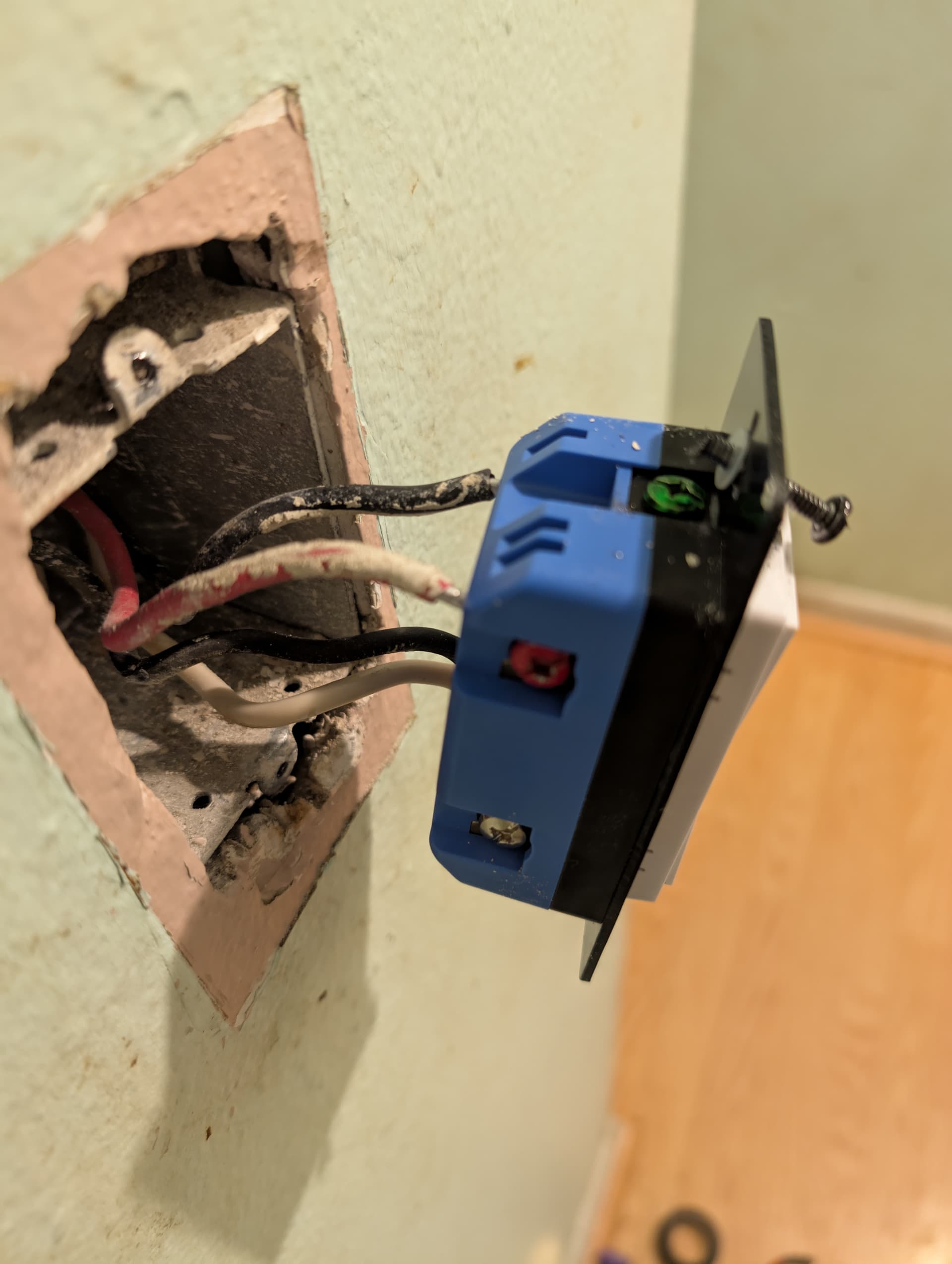

Can you post pics of the dimmer so that I can see the connections to it and also into the box?
@Bry sure! So it was much easier to figure out the wiring once I detached the dumb switch and got everything really pulled out. The white we found out is my hot so I have that going to the line and also on the line I have that black which is running to neutral of the aux switch in the other box.
Then we got the black load and the red traveler going back to the aux as well.
There was a 3rd wire that only ran between the 2 boxes and dead ended out at either box so I just capped this and tucked it to the back
Okay thanks. That looks good from the parts that I can see.
I see a lot of exposed metal on the traveler conductor. It’s either too long or it’s not in very well. Please pull it and re-seat it. Make sure it is in between the backing plate and the outside of the switch so that it is drawn tight by the screw.

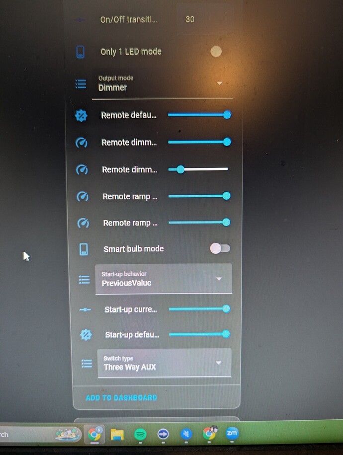

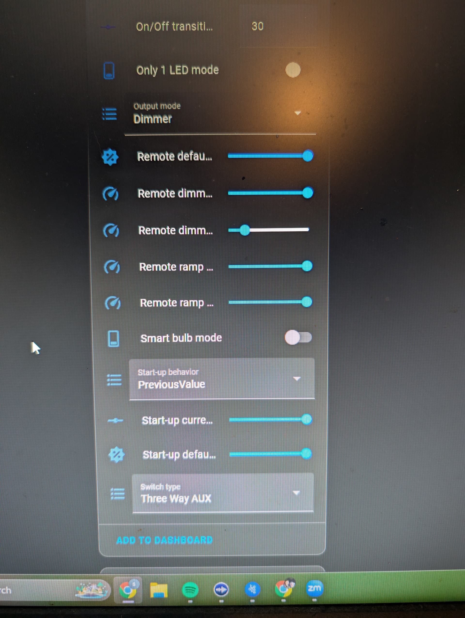

What is the load? Smart bulbs or no? It’s smart bulbs, is the dimmer in the smart bulb mode?
@Bry Yea I can re seat that after work it is in there really good but is very long so I can trim a bit. In the fixture is a 9w dimmable led bulb no smart I programmed the switch for 3 way with aux and as a dimmer
