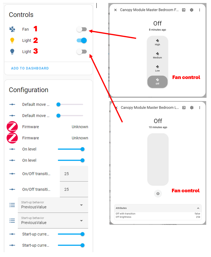

The user experience on ZHA looks a little odd to me, it shows as 3 devices:
The fan and two lights (see 1, 2 and 3 in the screenshot)…
Devices 1 and 3 are controlling the fan and always in sync.
1 appears to be the proper user interface and 3 a “dimmer” equivalent.
1 will automatically set the fan to the level equivalent of the percentage selected in 3 and vice versa.
2 controls the light and works as expected.
The above, combined with the fact that all configuration parameters are duplicate makes me believe something is wrong.
I already removed, factory reset and added it back but it is always the same.
This behavior is exactly as designed. The “dual” controls for the fan are precisely as you figured it: a “normal” fan interface, and a “dimmer” equivalent.
My recollection is that this was done so you could, if desired, bind the “dimmer” fan control to a device that doesn’t have a “fan” endpoint, such as a standard dimmer switch, thereby allowing you to control the fan using any device with a dimmer endpoint, rather than requiring a specific “fan” control device.
I’d have to double-check, but I believe the “duplicated” configuration parameters are so you can set light and fan parameters separately.
This makes sense but do we have two chips? Because it shows two firmware parameters and yesterday, after the installation, Home Assistant suggested I had two canopy modules to update. I got really confused at the time :thinking: so I updated one of them.
This is a bit messy but… what can we do.
Regarding the “dimmer” equivalent for the fan, I’m guessing it showing all light parameters because it sees it as a light but not all of them are relevant or will work with the fan, correct? In my case it may be better to just disable this entity so it disappear from the UI and avoid future confusion.
The parameters listed are a mix of for the light or fan endpoint and all should be valid, but it can be hard to tell from the UI which applies to which endpoint. It’s probably easiest to go into the Manage Zigbee Device options and use the Inovelli Light (endpoint 1) and Fan (endpoint 2) clusters to set the settings.
Both entities are technically the ‘light’ in HA, and in fact it was originally just 2 lights in HA. The Fan cluster on the device in ZHA is how you get the fan entity too and it’s just matched up to that light.
Yeah, that is the easiest solution if you don’t need the dimmer endpoint in HA then you can disable it. As stated above it is there from a firmware perspective to be able to bind it to devices that only support the level cluster. ZHA creates the entity because it sees that cluster in the firmware for that endpoint.
