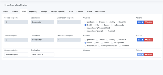

What do your binding and reporting screens look like?

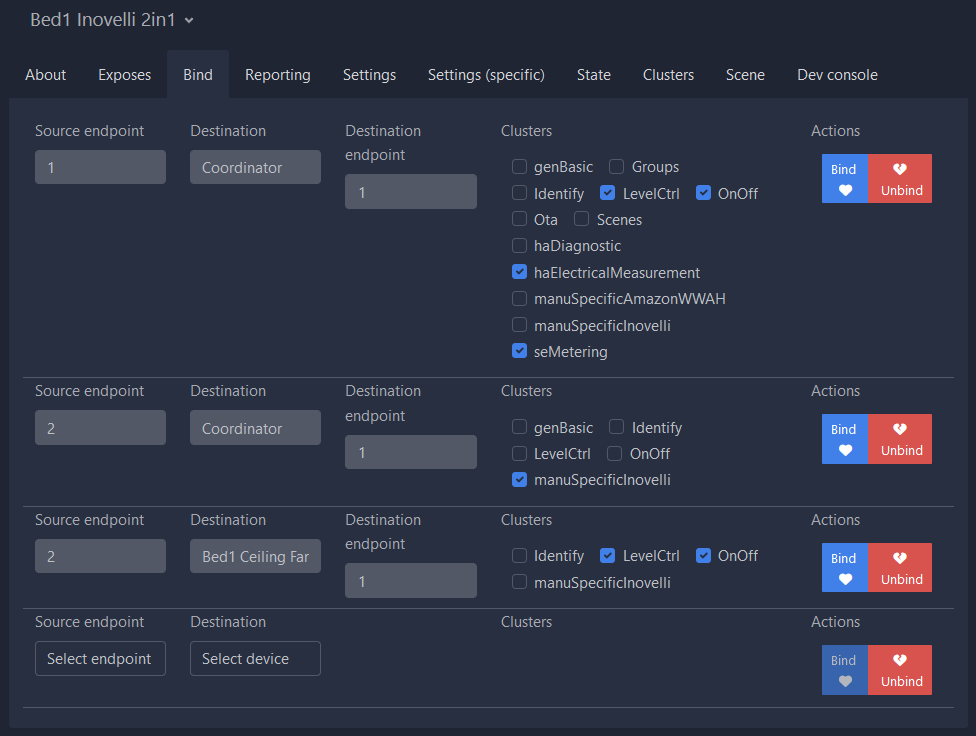

I clicked on my dimmer and went to the bind tab. Here’s what it looks like.

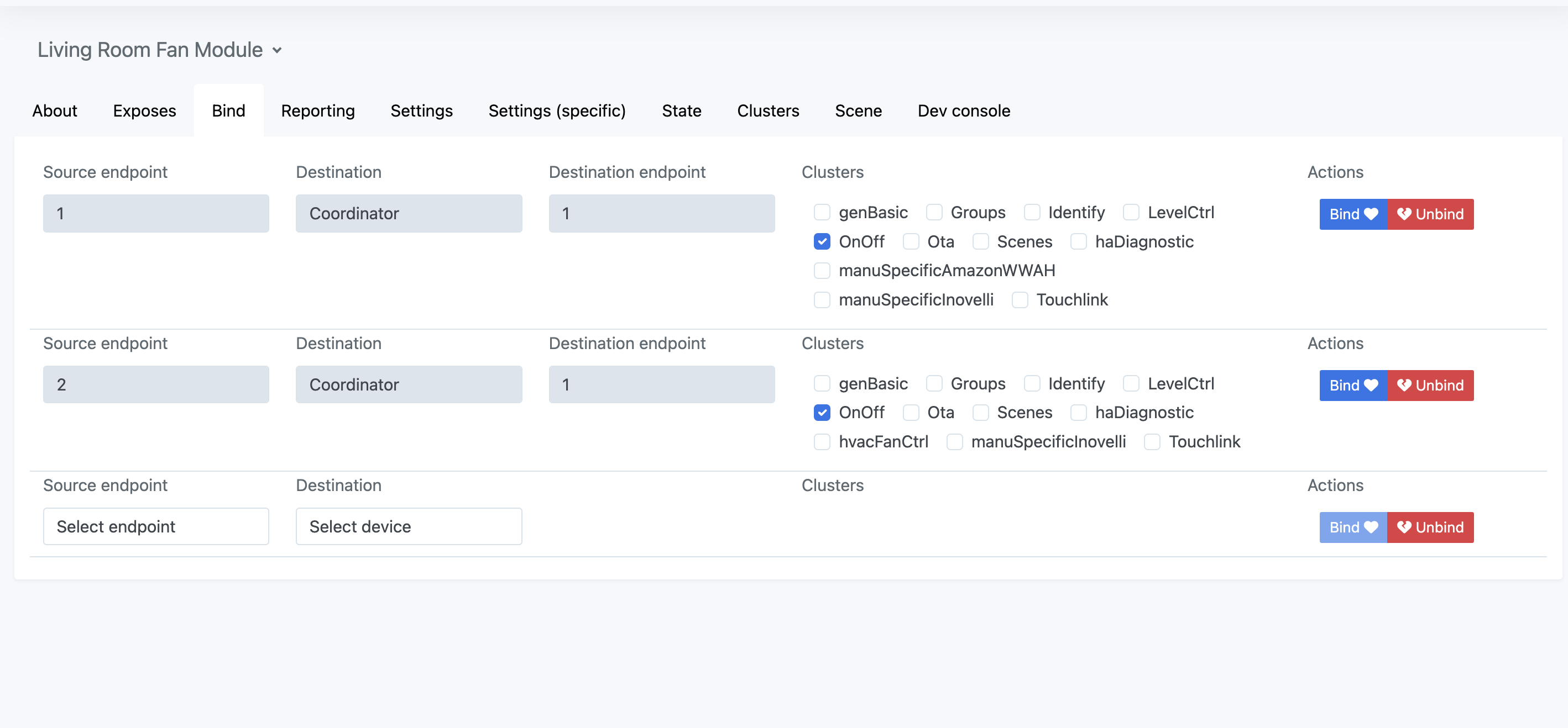

Woah - your bind page looks super different from mine (I haven’t changed these). Mine looks like this (on 3 different modules, 2 different Z2M installs):
@rohan I showed the bind page for my dimmer switch (2in1) since that is where I set up the bind between my dimmer and canopy module.
If I go to the page for my canopy module, it looks identical to your screenshot except I have LevelCtrl ticked in the top entry. I’ve never changes settings here.

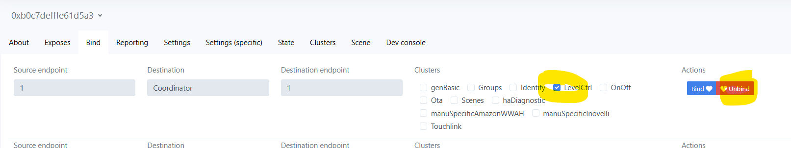

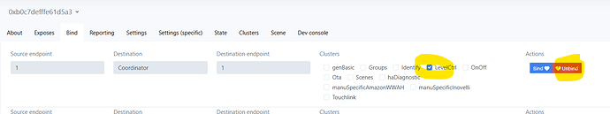

Edit: I still need to figure out why the interview process is different in my install vs yours but try to unbind the LevelCtrl cluster on EP1. You essentially select only LevelCtrl and then click Unbind exactly like the image below:

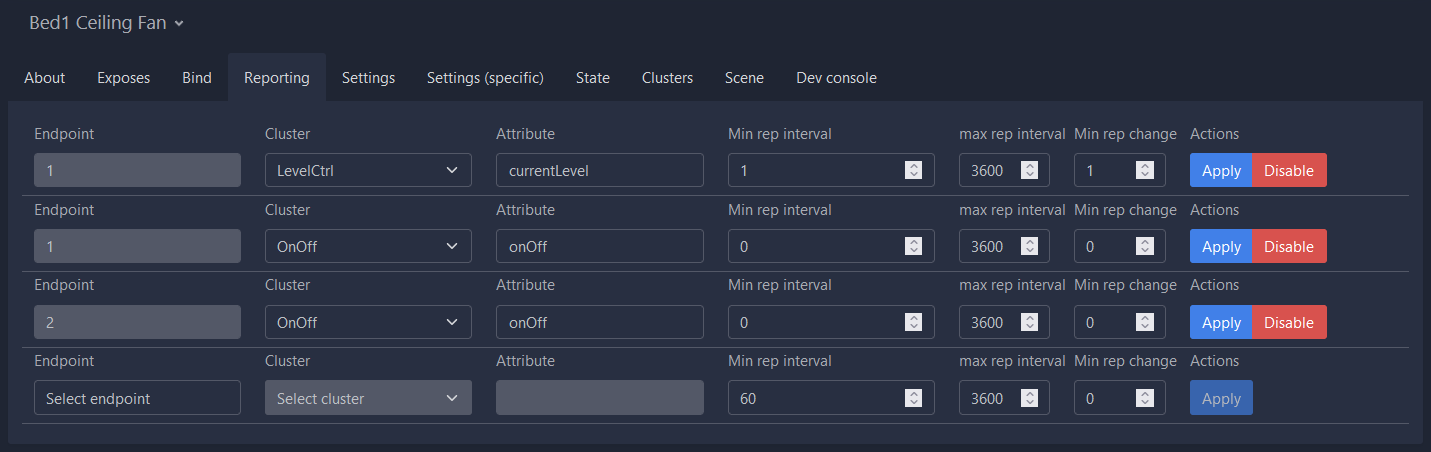

Here’s my reporting tab for the canopy module
I followed your instructions at the end and that seems to have fixed it! Quick testing seems like it’s behaving completely normally. Thank you. Let me know if there’s anything else I can share from my system, I’m happy to help.
