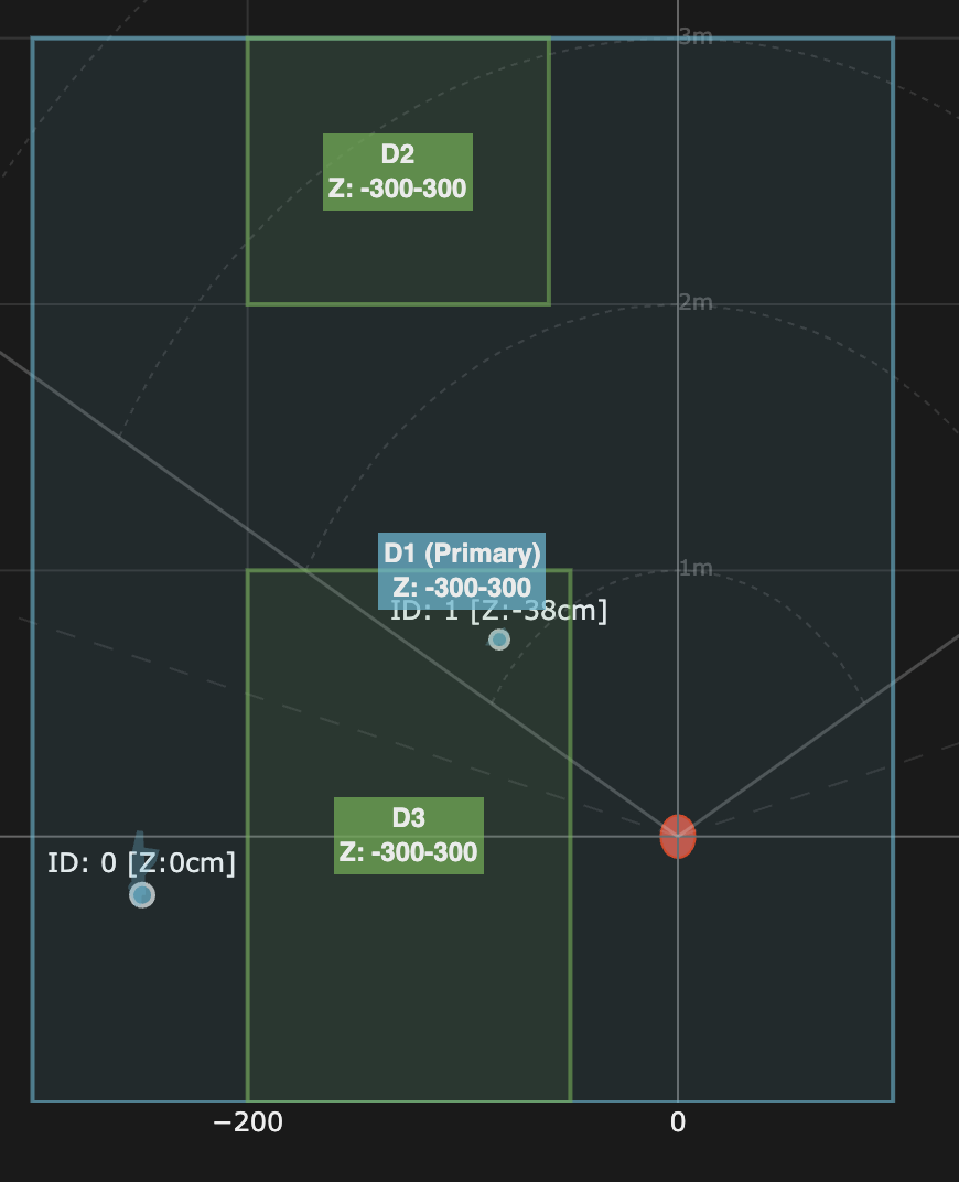

It’s not as important, but I’ve noticed that the exact location seems to change all the the time. In the below screen D2 is where I captured that I usually sit and D3 is where my wife usually sits. It was consistently that yesterday. But then twice today the locations were completely different. There were a couple minor (fun) automations I was thinking of creating based on detecting who exactly was sitting in the office, but I’m having trouble getting locations to be consistent.
The switch does face a big window, which could be part of it, but I’m wondering generally how big a variation is normal, or if it goes through any sort of “calibration” experience. I’m OK if I can’t ever get this to work as the overall experience works great for me, but would be great if I could use this functionality this way.
I have an automation that turns on the bathroom fan if you sit on the toilet for 5 minutes, but lights are on for anywhere in the bathroom. It seems reliable enough for me.
Yeah, I have different lights that come on based on presence in different zones of my kitchen and they also are extremely reliable.
