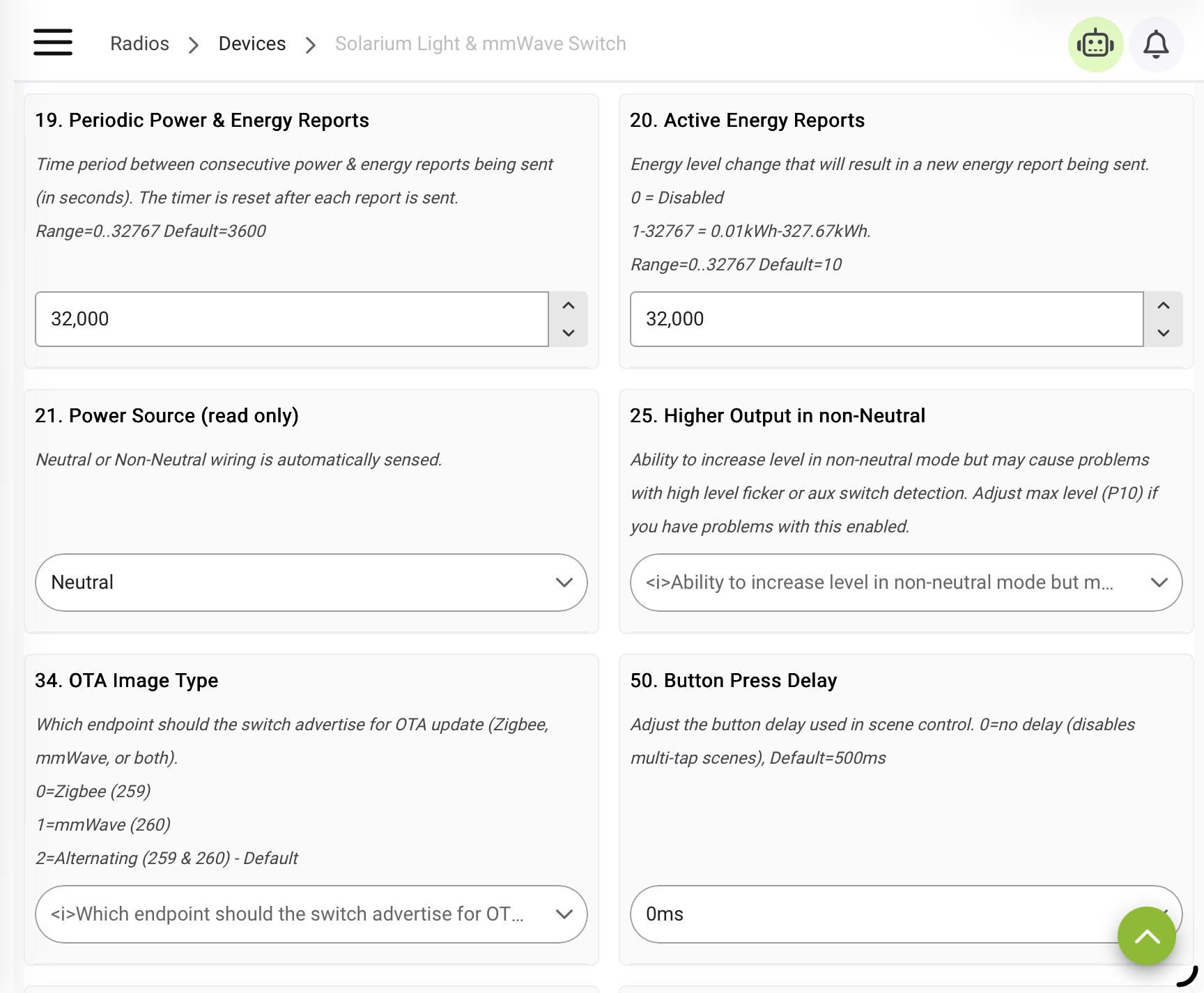

Are parameters 23 and 24 available for the Blue Series? The hubitat driver from Inovelli doesn’t expose them (Inovelli mmWave Dimmer Blue Series VZM32-SN). It would be great if it did! :blush:
We implemented them in Z2M and they appear to be working on one of my switches. Sounds like they may have been missed from Hubitat and the documentation… pinging @EricM_Inovelli
Thanks! And I can confirm that setting parameters 23 and 24 manually (Via the « Set Parameter » command) works on Hubitat. It is just not explicitely exposed on the driver as mentioned above.
I adjusted the QuickStartTime to 5. Was the lowest I could get it where the lights would come on faster, but not flash-bang everyone too badly.
I may still try and tweak more it to try and reduce the flash-bang effect, by playing with the level as well.
I tend to generally find that setting the quick start level to 50 reduces the flash bang effect significantly. Definitely play with the combination of settings.
They don’t appear to be available for ZHA either in the UI. Nor do they appear to be able to be read via zha-toolkit (though that may just go through the same code path and not be available unless it’s in the device handlers—I haven’t double checked how the toolkit reads attrs). They’re certainly missing in the current device-handlers: zhaquirks/inovelli/__init__.py#L1003.

Also of note—parameters 23 & 24 are not available in the list of ZHA entities (so maybe something’s not quite right in the device handlers) for the VZM31-SN, Blue Series Smart Dimmer, a.k.a. Blue 2-1. Perhaps this is a case where I need to remove & re-add the device to get all the entities appearing, but there have certainly been new entities that have appeared during the last firmware update I installed. Also, they are available in the Manage Zigbee Device section for the VZM31-SN while they’re not even present there for the mmWave switches.
ETA: It looks like the following places in the ZHA codebase may need changes to support these attributes:
Quick start time and level were features that were added to the VZM31 after it had already been released via a firmware update, so it’s not super surprising to see that it was missed in a bunch of places.
Aside, ZHA seems to be overhauling how quirks are written fairly frequently which seems to be leaving the Inovelli devices with semi broken features until they get fixed. Hopefully they stop doing that soon.
