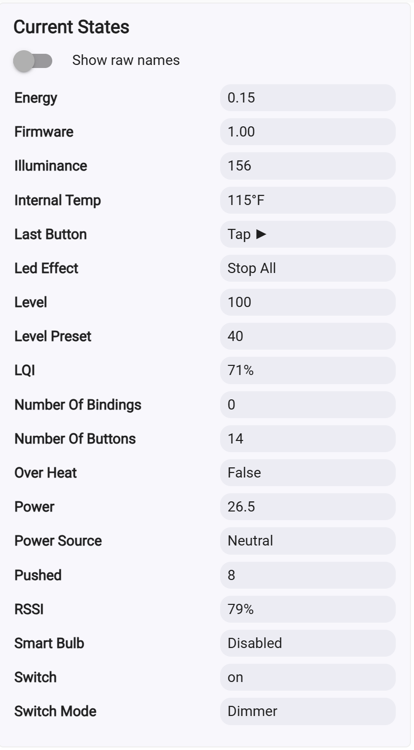

Bug on hubitat. pressing the favorites button doesn’t register an event of any kind. Rules using button 8/13 aren’t triggering either. Also, when the mmsensor is decoupled from the load, the motion sensor capability is not changing state. In fact, no “motion” state for it even exists. Also not seeing any mmSensor events on the switch itself. Is there a different method to detect mmwave state changes for rule triggering? Switch is working normally to control the load when param 110 is set to 1.
edit: “Configure all” on the switch corrected the button 8/13 issue and button 8 state is now showing. Still looking at the motion sensor problem..
Edit2: appears to be sorted. Once parameter 110 is changed to zero, another “configure all” has to be done before the motion state appears. Its all good, tracking active and inactive motion events and I’m standing down from defcon 1 lol…

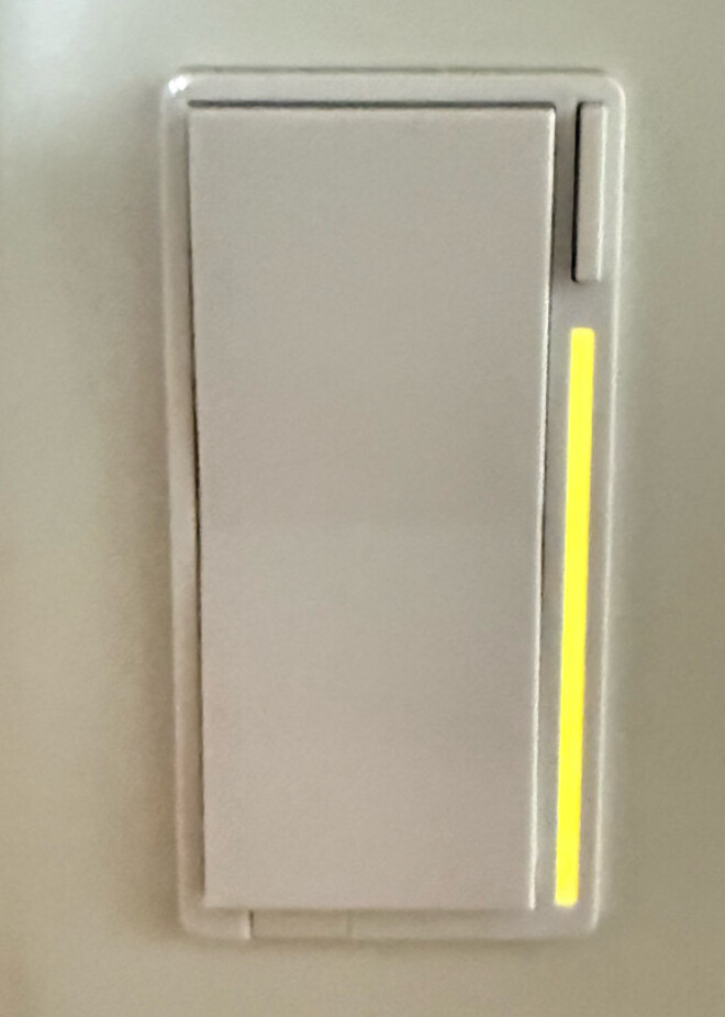

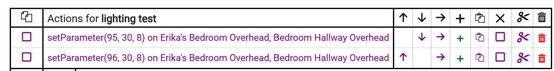

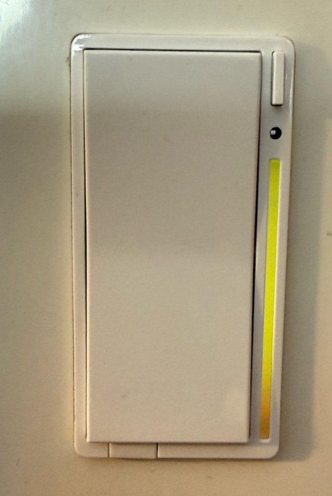

Here’s another good one for you. Setting parameters 95 and 96 results in the LED 1 being different from the others. Testing on VZM31 works fine. Examples setting all color to yellow. Here’s the hubitat RM rule:
and the result on a VZM31 blue dimmer:
and the result on the VZM32 mmWave dimmer:
edit: resetting the switch sorted this problem.

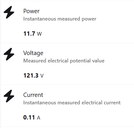

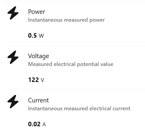

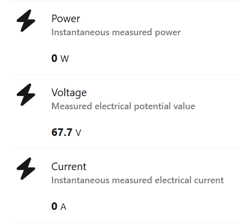

  2. I’m seeing a weird bug in the reported voltage. I haven’t seen anyone else comment on this.
    All of my switches are wired with Neutral wires.
    On bulbs where the mmwave switch is directly controlling the bulb (normal non-smart bulb dimmer mode), my voltage reading varies with on/off state and brightness level of the dimmer.
    I have taken a my Fluke true RMS DMM and measured the input voltage, it’s running ~121 to 122 VAC consistently. So it appears the switch is doing some math wrong internally, or maybe it’s got the RMS PWM waveform misinterpreted or something. Putting the switch in trailing edge vs. leading edge mode has no impact.
    Switch #1 controlling smart wafers (smart bulb mode always on):
    Switch #2 controlling 2 traditional Edison LED bulbs (off state):
    Same switch (Switch #2), on at 100%, controlling 2 LED bulbs:

I also saw some weird stuff with voltage, but I think mine boiled down to having a switch that had no load attached - it’s in a zigbee group to control the main switch which has really bad blind spot thanks to my speaker placement. Anyway, I was seeing around 94V on it and was concerned. I checked the voltage with a meter and was reading 122V solid, but I went ahead and inspected/tightened some wiring upstream, ended up swapping the switch for another to be safe, same thing. Then I put it in Smart Bulb mode and suddenly the voltage was reading properly and seems to be stable.
