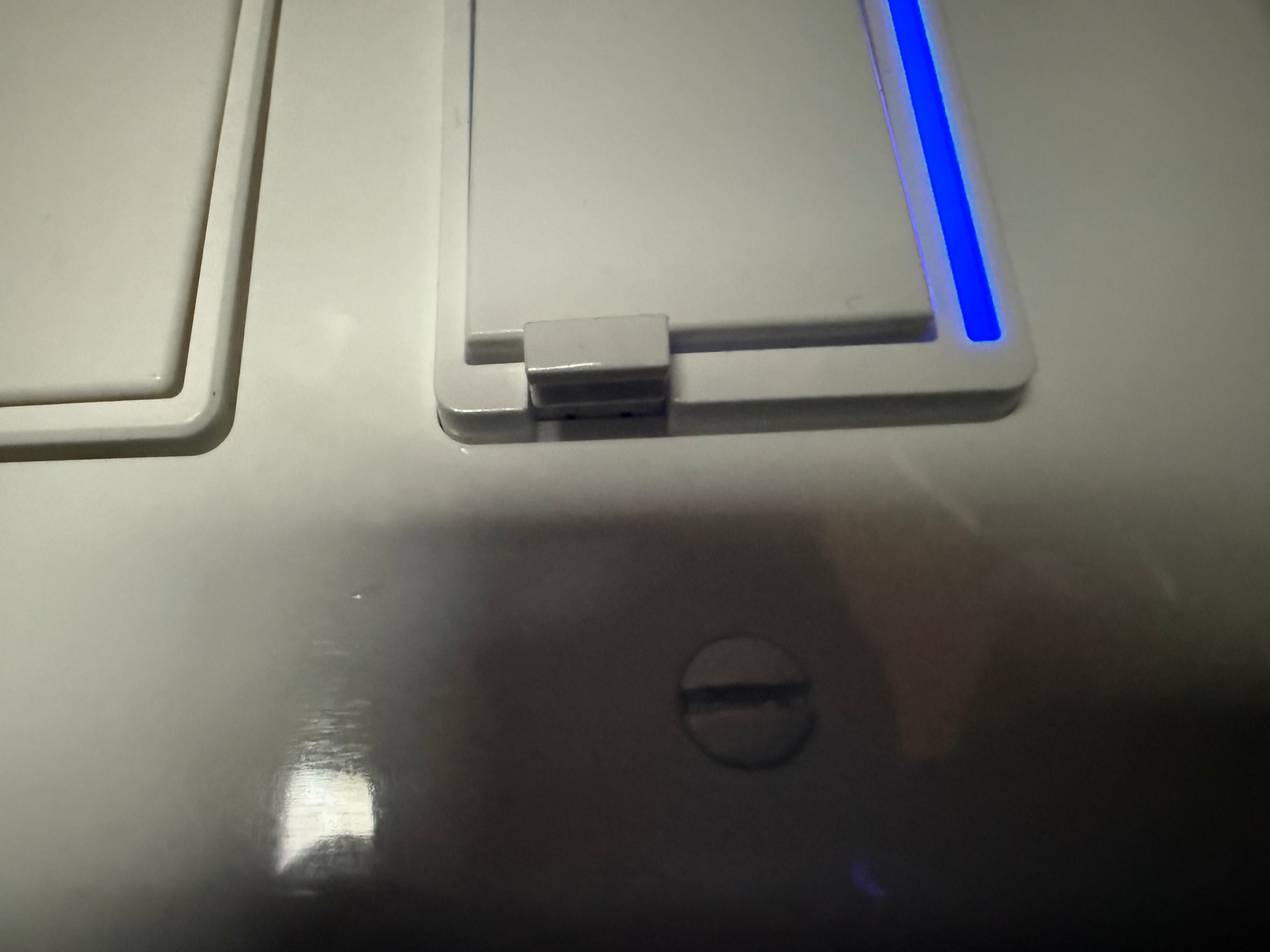

Is it supposed to come out further than this? I’m guessing yes since the led bar is still on, but I cannot get it to budge past this point. I even tried pulling with pliers and all the plastic parts around it started bending out so I stopped.

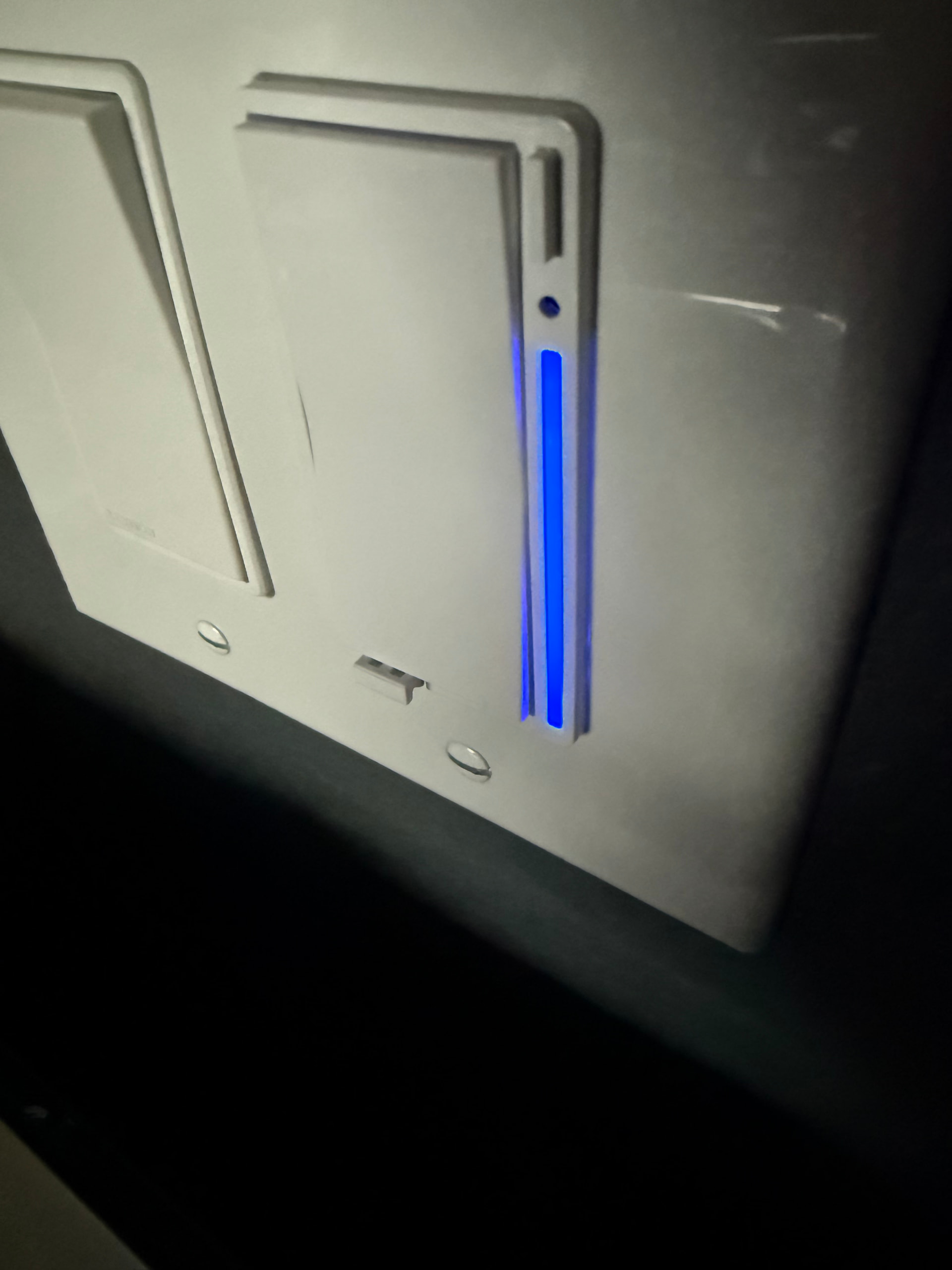

No, that looks about right. One of mine is below.
While it’s possible the switch is faulty, it’s more likely that you have wired it incorrectly. If the line and load are reversed, I believe the air gap won’t work correctly. The first thing I would check would be your wiring.
