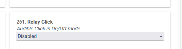

I did notice that the relay click doesn’t seem to go away when I turn that off
Doesn’t this device use an actual relay to do the switching? Therefore it’s hard to imagine there would be no relay clicking sound.
Can the relay click even be disabled with this switch – i.e. does it not have an actual relay?
Assuming it does, is it possible that’s just an overlooked parameter left behind from the 2-1 code?
Yeah, the relay click is unfortunately not something that can be turned off as @hydro311 pointed out (since it has an actual relay in it unlike the Dimmer which has a MOSFET - the relay portion of the dimmer is used for the 3-Way w/Dumb Switch and, believe it or not, there were customers who liked the clicking noise, so we enabled it). I’ll have to defer to @EricM_Inovelli on the driver code. It likely is something that was left over from the Dimmer switch code.
There’s also some parameters on there in reference to Dimming – those are actually for Zigbee Bindings (so you can still dim your smart bulbs).
Yeah that’s a good point. I was thinking about the dimmer.
Yeah, it was overlooked in the driver, but I’ll remove it asap.

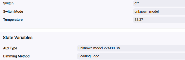

Is the “unknown model” value I am seeing for Switch Mode and Aux Type also from the driver not being fully updated for the VZM30? Or did I do something wrong with my install?

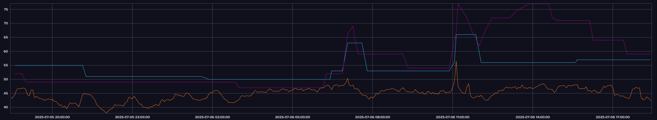

I installed mine yesterday and wanted to show the performance of the humidity sensor. The lines in the graphic below are as follows. All three devices are in my master bathroom which is relatively small. They are all within about 2 feet horizontally of each other, but at different vertical placements.
Purple = Zooz ZSE11, reporting set to 5% change trigger, ceiling mount
Blue = Zooz ZSE44, reporting set to 5% change trigger, on top of medicine cabinet
Orange = VZM30-SN
Looking at the graph you can easily see where two showers were taken by looking at the purple/blue lines. What concerns me is the first shower barely registered on the VZM30. Definitely not enough of a spike to trigger my rule to turn on my exhaust fan. The second one would have triggered it, but I will probably need to add a delay for shutoff due to how fast this responds vs my other sensors. I am holding off on updating my rules and removing the old sensors until I get more data.
Note - data is from Hubitat that was exported to InfluxDB.

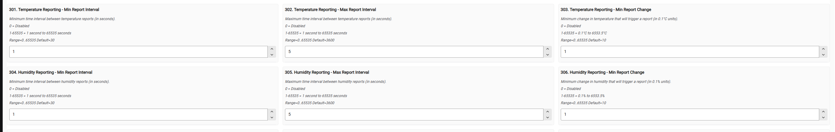

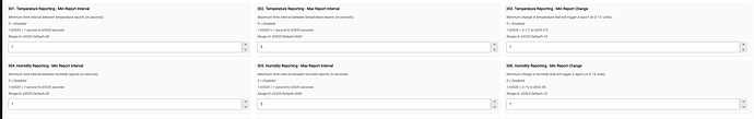

I just updated the Hubitat driver with some more granular control of the temp and humidity reporting. Can you update and change the settings to see if you can get things set the way you need them?
These settings control how often and under what conditions the device reports temperature and humidity updates. “Min Report Interval” sets the shortest time (in seconds) between each report, while “Max Report Interval” defines the longest allowed time before a report is sent, even if there’s no change. Setting either to 0 disables the reports. “Min Report Change” determines how much the temperature or humidity must change (in 0.1°C or 0.1% units, respectively) to trigger a new report—lower values mean more frequent updates. Adjusting these parameters allows you to balance between real-time accuracy and network traffic.
Just be careful that you don’t set it so frequent that it causes too much traffic. If you need some suggestions, let me know but hopefully that is enough info to get you going.
Thank you for the update. I just downloaded and installed the new driver. I will say that before making changes, humidity was being reported every minute no matter how small the change. I have set it to be 30 second minimum, 5 minute max with a 1% trigger. I will see how that works.

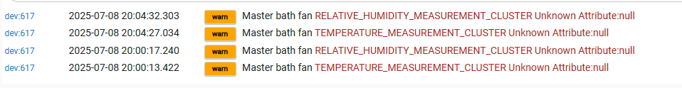

After making the changes I did see this in the event logs:
I assume this is because the driver hasn’t been updated to handle this command in the event output yet but wanted to verify.
