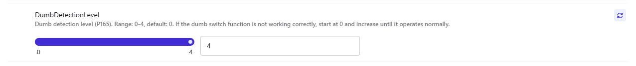

@dmk there is a z2m PR that should hit the dev version in the next day or so. It should add this configuration option:
Could you test the configuration option by increasing to 1, test it, 2 test it, etc? You can also do this by the button combo method mentioned in the white series thread.
@EricM_Inovelli - ok I used the button combo method. I had to do it a few times (saw the purple bar increasing). It now works the same way it was previously.
Great, once the PR makes it through z2m hit the little refresh button on that config option as I am curious which value worked for you.
