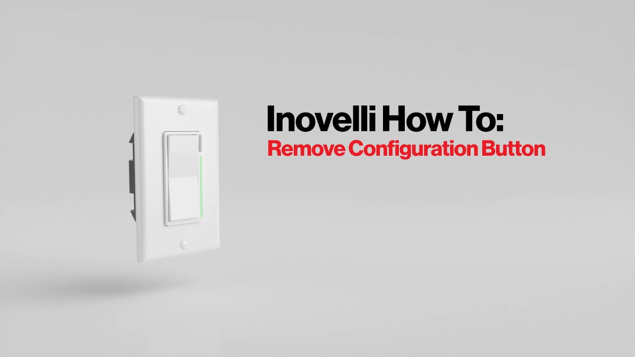

Question: how did you get the button out of the frame?
I have removed the frame from the switch, but can’t get the button out. I tried lightly prying between the frame and button, in case there is a ledge that it snaps into. But I didn’t want to crack it.
Can you offer any advice?
just push hard on the config button in the direction you would using it, it takes some force to push it out since there is a resistance piece beside it to keep it from falling out.
I used a small flat head screw driver to very carefully pry the button up and out. It’s requires very little force and even pushing on the button as you do it from the front side helps it slip out.

Terk, Greg,
Thanks for the feedback! That’s kind of what I was expecting, but wanted expert confirmation; I didn’t want to force it, especially since they don’t have white replacements!
