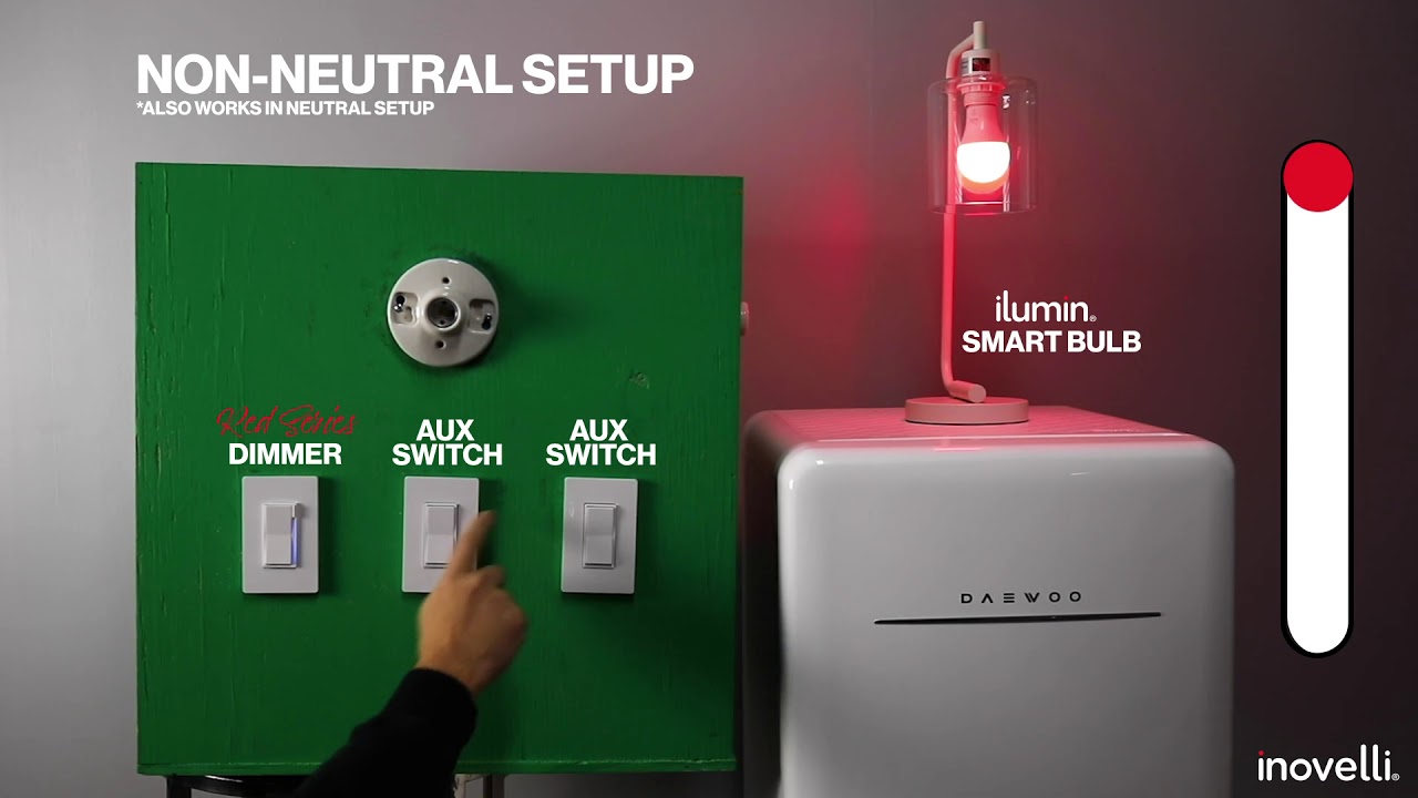

Yes, and we were just testing this out yesterday actually! We tested it with our Z-Wave bulb (ilumin) and our dimmer switch and it worked great.

That’s great. So just to confirm, the dimming capability only works using the Red Series Dimmer and not with the On/Offs? How was it configured in SmartThings to work?
Also, are the AUX switches also dimmers? My guess is the AUX switches are default and work with either dimmers or on/off since they simply “replicate” the main so that doesn’t matter. In your video, the 2nd aux switch did take a while to dim the bulb though :).

Dimmers
  • Dimmers can do the same thing as On/Off’s in regards to scenes, but they can also send a dim command to the HUB (or another Z-Wave bulb) to dim up/down
  • This is what was shown in the video above, which I’ll explain below.

  • The setup was a 4-Way non-neutral setting, but it will work in any setting as the wiring is not the important part here.
  • First, you pair the products to ST, then you use a SmartApp Eric M created to associate the dimmer and bulb together (use Group 2 & Group 4).
  • Now that they’re associated, they bypass the Hub and talk to one another directly
I’ll definitely provide better notes once everything is released and likely post it in the Tips & Tricks section.
Your guess is correct – it does work with either On/Off and Dimmers and I believe you’re also correct in that it replicates a push or a hold for On/Off or Dimming.
Yeah, honestly, we didn’t even know the aux switch would work with the dimmer switch to change the bulb dimness. That was an added bonus as well!
