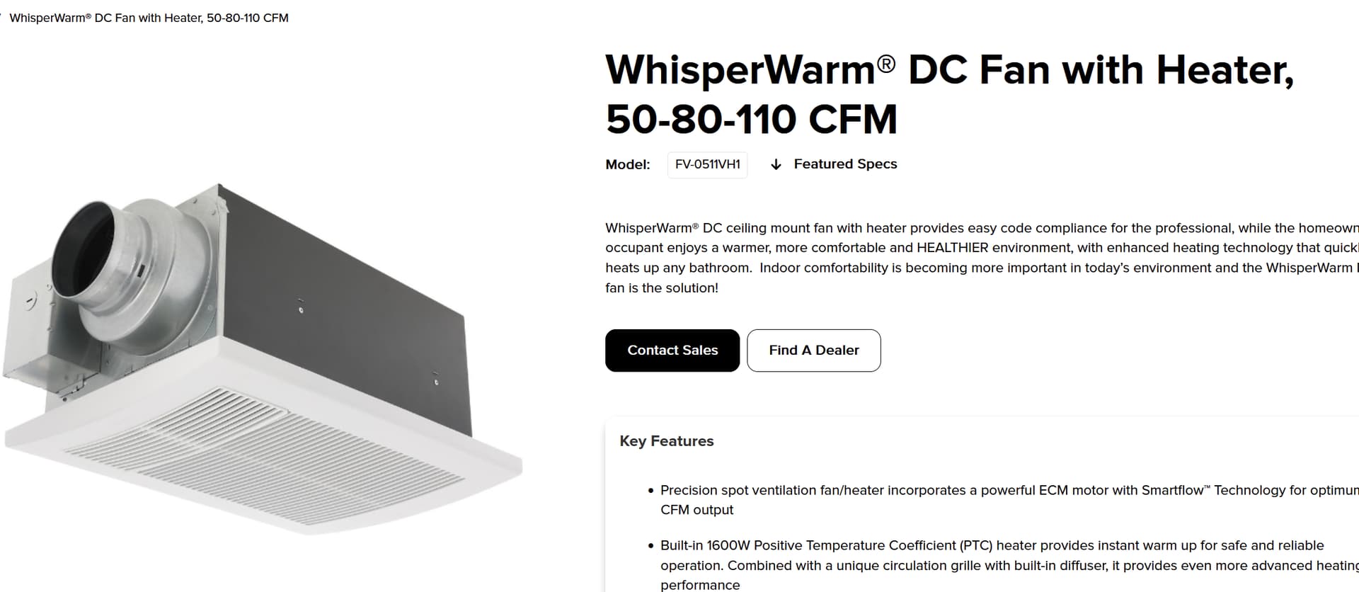

I’ve got the WhisperWarm, but know that I can’t use the Inovelli for the heater part so I was just planning to use it for the vent fan function which uses a separate switch. Any comments on the odds of that being ok? Looking at the install instructions the WhisperWarm FV-0511VH1 I’ve got (which doesn’t have a light) has 4 wires - one black for vent, one black for heat, white neutral, and ground. It doesn’t have a humidity sensor. Nothing is powered all the time. The motor does come on slowly. I’m not looking to control fan speed, simple on/off.
I think all the Panasonic exhaust fans are DC, so this won’t work properly.

That’s a good point. The WhisperWarm that @sprior is enquiring about does have a DC fan and so it’s not compatible with the fan switch.
@Bry I thought that since I was not planning to do any speed control with the switch, strictly on/off that I’d be ok even with the DC motor. No?
Unfortunately, no. There is a lot of confusion surrounding the on/off function of the dimmers and fan controls. For both of those, setting the switch in the on/off mode uses the switch’s dimming or speed control circuitry. So on/off for the fan switch really means on/off for AC fans only, because that is what the switch is rated for.
On the other hand, the under-development On/Off switch is a true relay-based switch which does not have any dimming or speed control circuitry. So that would be the properly-rated switch for a DC fan.

Ok thanks, I guess I’ll return these switches. What’s the current guess on the ETA for the new switches? Also I’d love to be able to use a smart switch for the heater function of the WhisperWarm but that heater is I think between 1600-1700W, would the new switch be able to handle that?

If you look at the specs for the switch, the resistive load (i.e heater) spec is 15A. So using that spec, yes. 1700W @ 120VAC = 14.1 amps. IMO, you’re pretty much right on the edge, but within the published specs.
Just double checked, the heater is 1600W and it’s on a 20A dedicated circuit. The WhisperWarm is replacing a heater that came with the house and is being installed by an electrician so everything should be legit. The vent and heater functions are on separate 110V switches and I was initially planning to use a smart switch just for the vent function, but nice to know when these new switches come out I can use it for both.
